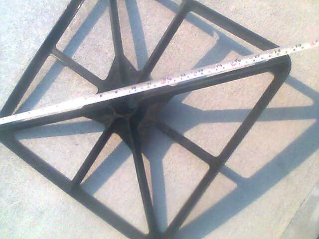

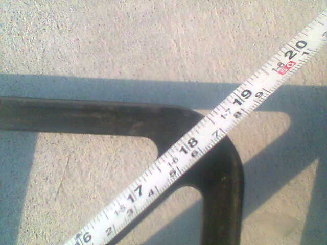

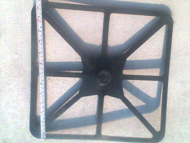

    hi qiaozhi thank for sent a link. qiaozhi i built acoil cover for hammerhead coil outer diameter 13.5/13.5 sqare inch can you tell me how many turns give me 320 uh inductance ......rajesh

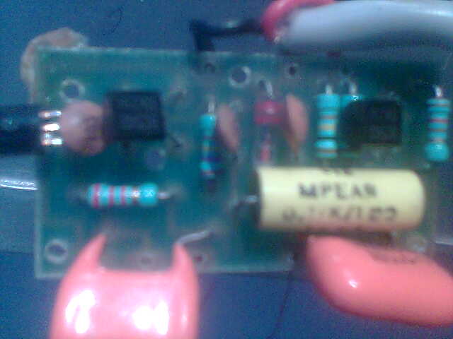

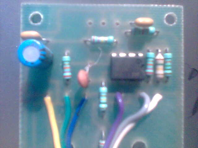

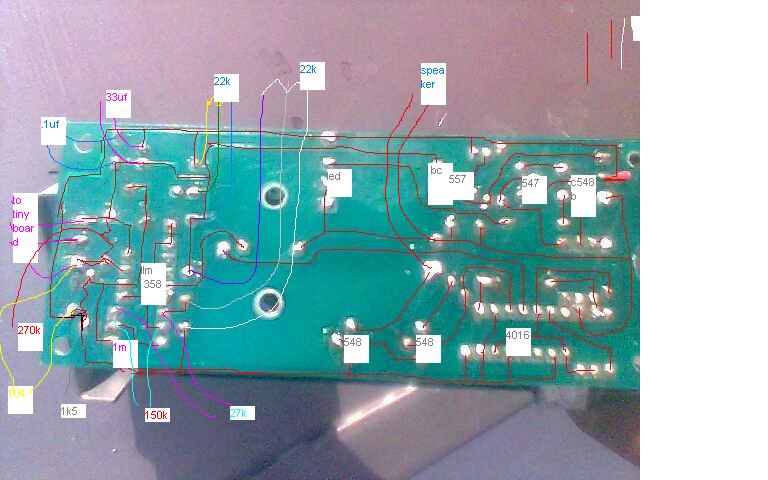

      Is the 8 pins IC a LM358 and the other a 4066? Appears use zener for volt. regulation... seems like a C-Scope model with some variants.

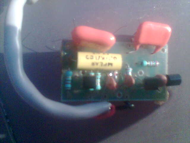

      Do you can trace the transmitter circuit inside the coil housing?
      Esteban
      hi esteban thanks for reply transmitter ciruit is a very simple bc 547 used here as soon as i will send all component list thanks esteban ........

        Hello , I bet the problem is with the tiny circuit board inside the search-coil and not the windings . There are a lot of circuit tests you can make with just a good ohm meter . You might have a Good Rare VLF Machine that not to many people know about !!.....Keep us informed on your interesting Old Circuit....................Thanks................. ..Eugene52
        hi eugene there are simple bc 547 transister no problem thanks ............

              may be, you can repair these put shocket interchangeable in ic 4066 and replace for other 40..s but before check one for one, the transistors

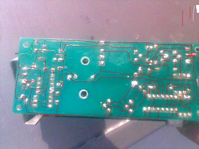

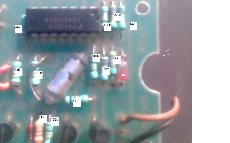

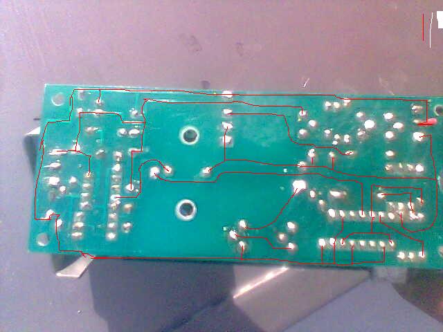

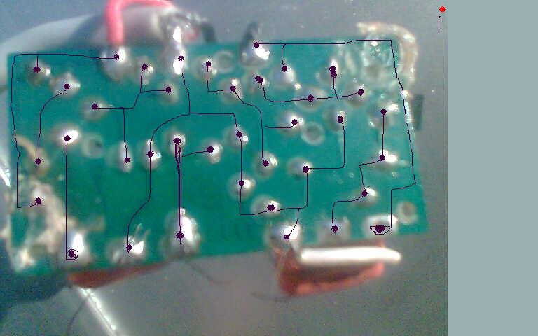

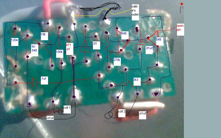

                      this is image
                        metal locator
                          metal locator
                          hi detectoman tell me if you want more detail...
                            Hi Rajesh
                            Is very simple... Now, your next step will be trace it for us...

                              yes esteban im ready for next step...
                                4016 = 4066
                                Looks similar as C-scope minidetector with few vaiants...
                                Please take better pics with digital camera!
                                Esteban
