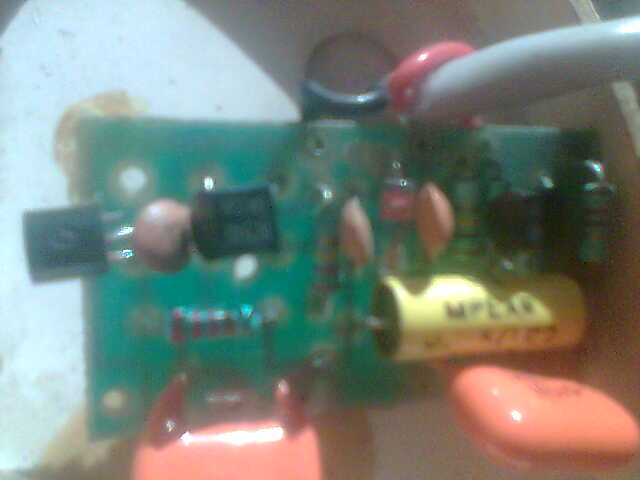

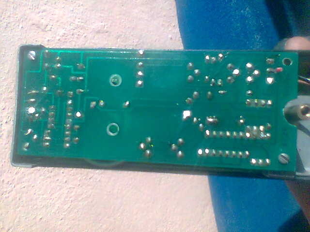

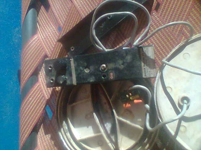

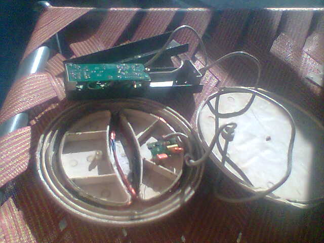

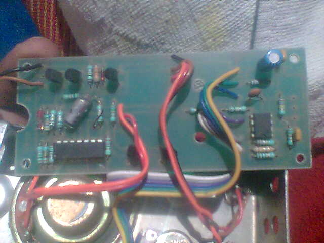

    hi every one i purchase this device for treasure huting in 2003 but now coil winding has been damage
    metal locator
    there are two 9 volt battry DD coil 7inch any one has a schematic ..
      metal locator
      hi every one there was 42 inch senstivity at a medium object.......
        metal locator
        hi any body send me schematic ....

            these detector semms circuit very simple
            isn't vlf discriminator?
              a power full metal locator
              Hello Rajesh , Looks like a Fun and Great Winter Project !!! It seems like a VLF DD search-coil . Only 2 IC chips and 3 transistors on main circuit board . Let us know how it Goes ?? What are the chip numbers . Might be low frequency , with an oscilloscope you can find out the exact operating frequency . I heard of Detech brand somewhere , Maybe made in the U.K also ??.............Regards.............Eugene52

                    hi eugene there are a small 8 pin ic lm 358 and - cd 4016 b transister bc 547 i will be send all component list if you need .....

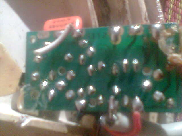

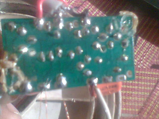

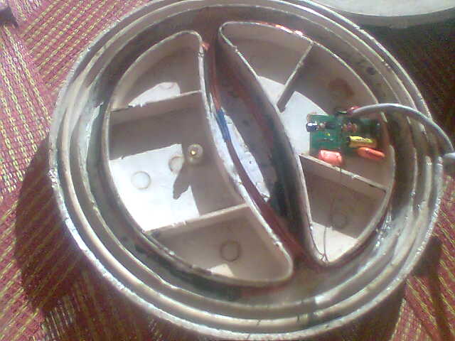

                      Hello , I bet the problem is with the tiny circuit board inside the search-coil and not the windings . There are a lot of circuit tests you can make with just a good ohm meter . You might have a Good Rare VLF Machine that not to many people know about !!.....Keep us informed on your interesting Old Circuit....................Thanks................. ..Eugene52

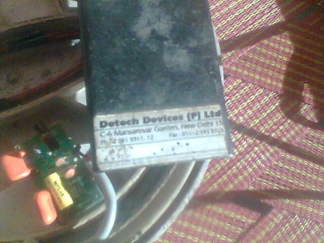

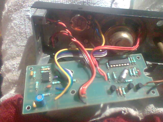

                          Is the 8 pins IC a LM358 and the other a 4066? Appears use zener for volt. regulation... seems like a C-Scope model with some variants.
                          Do you can trace the transmitter circuit inside the coil housing?
                          Esteban
                            rajesh: most probable in damaged is the oscilation transistor, (in coil tx), because these suffer extremely work
                            may be esteban know the solution to these faulth
                            try the oscilation of tx ( little circuit in the coil ), try the signal to finish the second trasistor of receptor

                              hi detectoman here is anything damaged only coil circuit working well any way currently i no need that i has many more detector gary's pi ------- hammerhead ------- thanks
