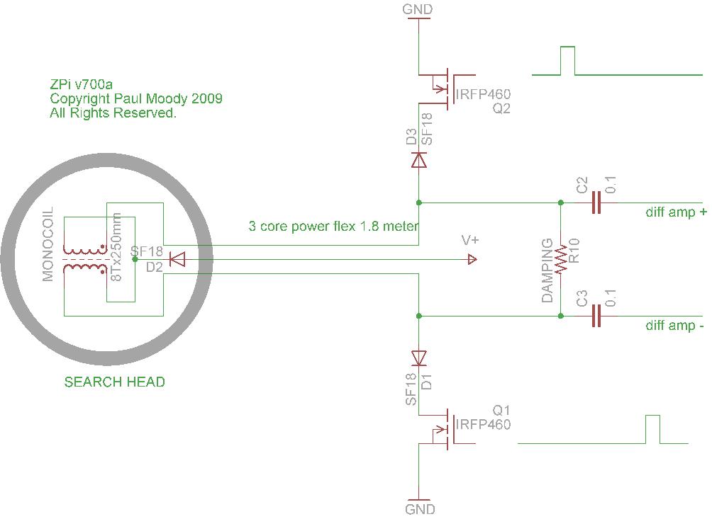

                    • Earth Field Solution and other benefits
                      One of the problems with sensitive PI detectors is earth field. If you wave a coil through a static field ( eg the magnetic field of the earth ) a slight voltage is induced that is proportional to the rate of change of flux through the coil. eg at type of generator. This leads to false target detection. However if the PI is driven by an alternating Tx pulse the receiver will see two things ...
                      1. Targets will respond with an alternating field as the eddy currents alternate in track with the stimulating tx pulse.
                      2. The earth field will produce a steady ( like DC ) response depending on the motion of the search head.
                      The only thing that would fool this would be if you sweep the search head at the same frequency as the alternating Tx pulse. ( if you drink lots of coffee you might be able to reach a 1000 Hz sweep speed )
                      The other benefits ? .... have you heard of chopper stabilised amps ? ... read up .... if you want to measure really small voltage changes like in a PI this definitely is better.
                      Coupled with the differential coil this system changes the PI landscape forever .... bisymmetric differential drive system schematic is published below ....
                      ... wait till you see the ground balance system I have devised ... more soon.
                      Moodz

                      • Hi all,
                        why we should use differential PI front ends?
                        See the difference:
                        http://www.geotech1.com/forums/showp...&postcount=678
                        Paul, go ahead. That's the way to go.
                        Aziz
                        • Hi Aziz .... looks good .... have you tried the SSM 2019 yet .......
                          moodz
                          • Looks good, no, fantastic! Might have to order some parts.
                            Cheers
                            • Hi moodz,
                              moodz
                              yes, I have compared both SSM2019 and INA163 together at gain of 1000. Nearly same good results.
                              The differential coil signal has to be filtered further to get rid of the high frequency noise. So the INA163 gives the possibility to modifiy the core amplifiers (both buffers and differential stage). SSM2019 gives not the option for this.
                              I will wire a new circuit for the INA163 soon and will see more.
                              Aziz
