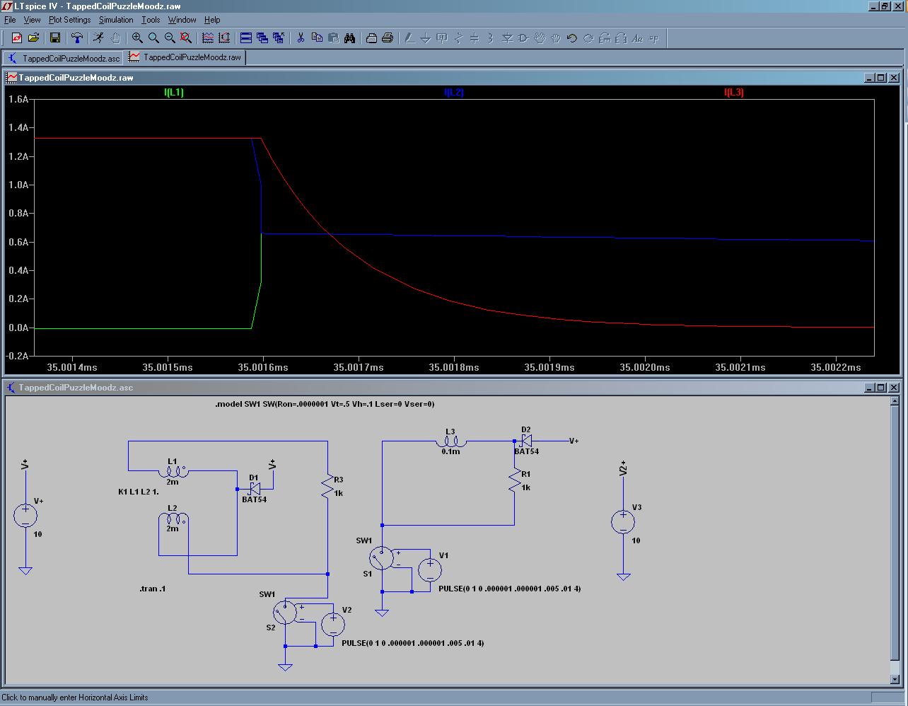

      • Hi Simonbaker,
        Continued from prev post... More interesting graph showing sum of currents in coils too. Derivitive of sum gives induced current in target???? (of course this is without MOSFET breakdown).
        -SB
        if you have only one coil, the current will remain at last current at t-off (switch-off time) and then starts to diminish from this point.
        On the bifilar type coil, we have at switch-off period two coupled coils.
        The total inductance L will be:
        Ltot = L1+L2 + M12 + M21
        M12 = M21 = k*sqrt(L1*L2), (mutual inductances)
        where k=1, the coupling coefficient (sharing the same coil flux area)
        So, Ltot = L1+L2 + 2*sqrt(L1*L2)
        The dB/dt applies to both coils L1, L2 at switch-off. From the point of energy balance, the output energy may not be higher than the input energy. The intregral E=U(t)*I(t)*dt (delivered energy from the coil) for the period of switch-off time (until next switch-on time) must be equal to E=0.5*L*(I0)² (emitted magnetic field energy at switch-off time), (I0=switch-off coil current).
        TX period: E=0.5*L*(I0)², L=L2 in your example
        RX period: E=0.5*Ltot*(Irx)², L1=L2, Ltot=4*L2,
        Solving the equation:
        0.5*L2*(I0)² = 0.5*4*L2*(Irx)²
        (I0)²=4*(Irx)²
        (Irx)²=(I0)²/4
        Irx = I0/2
        So the current in the receive period must be switch-off current I0 /2 and starts then to diminish from this value.
        Q.E.D.
        Aziz

                  • Hi Simonbaker,
                    this is part 2: (I had to shorten my first post due to a visit)
                    Of course, the coil current I(L2) have to reach the I0/2. But this is more obvious, if transmitter coil is fully decoupled from the bifilar coil (transformer principle, seperate mono TX, bifilar RX).
                    During the build up of the flyback, there will be some resistive loss and the coil current does not reach fully I0/2.
                    But the coil current is not relevant. What counts is the first derivate of it (dI/dt).
                    Aziz

                      Thanks Aziz, I will study your comments.
                      First, I was not sure if my LTSpice simulation is physically accurate - I gather you feel it does represent reality, correct?
                      Second, my purpose with the sim is to identify what we really are gaining with the bifilar / center-tapped coil. Are we gaining any magnetic field advantage, or is it basically the same as a single coil with same amount of wire? I understand (I think) the benefits of the differential design.
                      Third, some previous discussion suggested that the current in the two coils became instantaneously identical at MOSFET shutoff. However, my LTSpice sim indicates that the current briefly grows in one coil while decreasing in the other, and the difference is made up for by current coming through the diode from V+. When the two coil currents become equal, the sim shows the diode current stops, and both coil currents (really the same current) decaying at a slower exponential rate. I'm not clear whether that initial transition period is physically realistic, or a Spice artifact.
                      I'll try to look over your equations, probably some answers in there.
                      -SB

                        Simon ... in order to see if there is an actual benefit in diff coils consider the case of the single coil vs the diff coil.
                        Below I have even reduced the inductance of the single coil greatly yet it cannot match the step response of the differential coil. At the decay / switch off point the current falls much faster than the single mono coil. It does not matter that the current does not actually fall to zero. The flux in the coil decays much faster in a step response.This is ONE of the TWO key features of the diff coil that I have been trying to make you guys see. Critical to remember that only ONE of the coils is carrying substantial current during the TX pulse in a diff coil. Trying to analyse the diff coil on its own with no comparative reference is like trying to find who came second in a one horse race
                        ...and this is backed by physical experimental results not just math ... which is good but needs to be in the framework of experimental data.
                        moodz.

                          Hi Moodz:
                          Try graphing I(L1) + I(L2) -- I believe that accounts for the total magnetic field seen by the target, the sum of the ampere-turns from both coils. Even though one falls very fast, the other grows very fast, and the sum does not have that sharp step -- but I'm not sure if that initial step is just a Spice artifact or physical.
                          -SB

                            Hi Simon,
                            yes the graph does produce a curve that is consistant with conservation of energy. This is a standard principle of physics however you are only considering the current and the turns in the coil. How was the energy lost from one coil and transferred to the other so suddenly ?.... the flux transfers the energy .. and what is also in the flux ? ... the target....does the target also experience a rapid current change ?... anyway food for thought.
                            This problem is very similiar to charging a capacitor then moving the plates apart ... what happens to the voltage across the plates ... even though the charge on the plates has not changed?

                              Hi moodz:
                              I'm assuming the flux must always be consistent with the currents in the coils (since that is how we calculate the flux, from the currents and coil turns). Both coils are producing flux, and initially I believe the sum of the fluxes is not changing anywhere nearly as fast as that step we see when looking at a single coil. Since the sum of the currents does not have that big step, the target doesn't see any extraordinary dphi / dt, just the typical exponential (my second graph shows the sum of the currents, I(L1) + I(L2), and there is no sudden step).
                              (I don't know how to compare it to moving capacitor plates apart. You definitely put in physical energy to pull the plates apart, so I'd expect the voltages would rise according.)
                              However, I think I'm getting the clear advantage of "differential" (bifilar/center-tapped) design from playing more with the sims.
                              It seems for the same "flyback" voltage across the MOSFET (switch in my sims), you can get more dphi/dt with the center-tapped design, maybe double?
                              This seems to be due to the fact you get double the voltage across the damping resistor (I guess that shouldn't be an engineering problem) without increasing the MOSFET flyback voltage.
                              Combined with better noise canceling, it seems like a winner combination.
                              -SB
