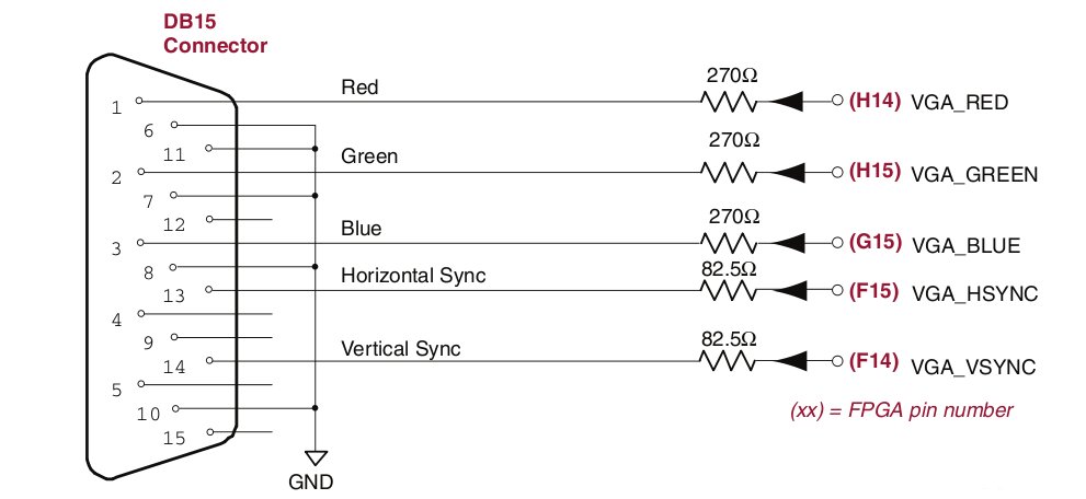

    Here is the vga circuit ...you can assign any pins as video interface.
    Spartan 3e 3a ... whatever ... it will still work !
    moodz.

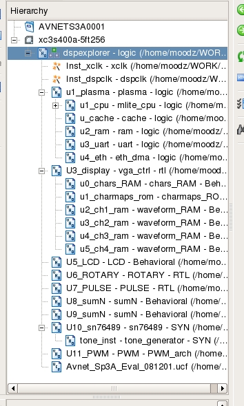

      On the FPGA side of things I have now taken delivery of the rotary encoders, 2 x 16 LCD and MOSFET drivers so watch this space !
      One thing I did not have in the design is the audio channel. Of course I could have written a routine to generate audio ( tone etc ) using the CPU however there is still heaps of space in the FPGA so I have added a 3 channel synthesiser and noise source module which will be modulated by the CPU but will not involve any messy waveform synthesis by the CPU. Even better the volume control is also fully digital and the audio output is PWM ( so it uses only one output pin on the FPGA ) A simple resistor and cap form a low pass filter and the audio resolution is 16 bit. In this way very complex sounds can be generated to indicate all sorts of things at the same time.
      Some of you are probably wondering when I am actually going to get around to demonstrating an actual metal detector .... please be patient ... there are about 30 'chips' ( modules ) in this design and each one has to be designed or modified then added to the total design then the whole thing retested to make sure that I did not break anything. However it is getting there. So now I have added the sound module I have basically got everything I need functionwise. I now need to code the user menus and fiddle the basic ground balance. Then I have to build a basic front end .. put the whole thing in a box and rod and get out in dirt. ( My bench testing days are over ... that is why I put the VGA scope interface in this design )
      Hope this explains more ....
      Moodz.

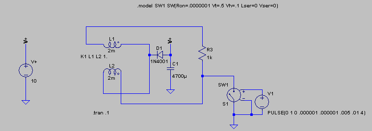

                  Thanks for the detailed explaination. It seems reasonable, the difference between motivating the current with an applied voltage versus a magnetic field. I'll have to believe Spice and reality as I'll probably never work the equations to my satisfaction.
                  I think the disconnect I still have trouble with is: if the second coil suddenly has the same current as the first coil, you would expect twice the magnetic field compared to the first coil alone -- yet that I don't believe happens. I guess I'll just gnaw on it all for a while.
                  Cheers!
                  -SB
                  Hi Moodz:
                  (still gnawing on it...)

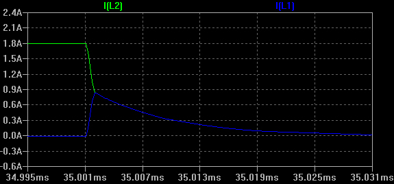

                  You mentioned a spice simulation helped show the currents in the two bifilar coils during MOSFET shutoff.
                  I'm still befuddled by it, but I made this little LTSpice circuit to try to help. It seems to show current in the energized coil decreasing while the current in the other coil increases, then they meet and both decay together. I have no idea if this is realistic or even represents your circuit.
                  Can you comment?
                  -SB
                  P.S. Nice stuff Moodz, Aziz, Tinkerer... I think

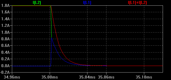

                    Continued from prev post... More interesting graph showing sum of currents in coils too. Derivitive of sum gives induced current in target???? (of course this is without MOSFET breakdown).
                    -SB

                      Thanks Simon ...your simulation matches experimental results. The coils are coupled quite tightly together .... any target within range is also coupled. So energy is transferred to target during flux build up and released on field collapse. The point of collapse is a discontinuity in the signal ( this is why I feel spectral analysis is inappropriate ) however you have pretty much nailed it in your next post regarding differential analysis ..( which is also the key to descrimination IMHO).
                      Paul.
