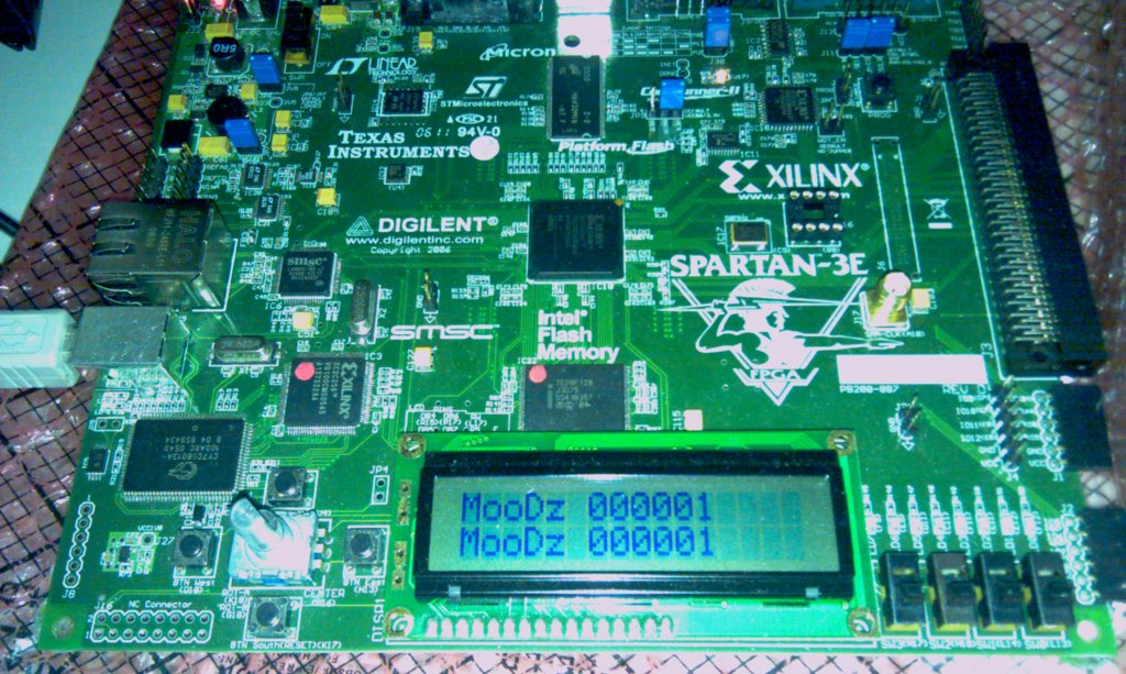

                • FPGA progress
                  ..more coding progress.
                  Vertical channels adjustments now available to CPU.
                  Added LCD driver HDL.
                  Added Rotary knob driver HDL.
                  The LCD display is accessed via the VGA RAM. By writing to specific 32 characters addresses in video ram the LCD is written also. This is helpful for menu displays when the VGA is not connected to the FPGA board.
                  The development board is a Spartan 3E500 from digilentinc.com

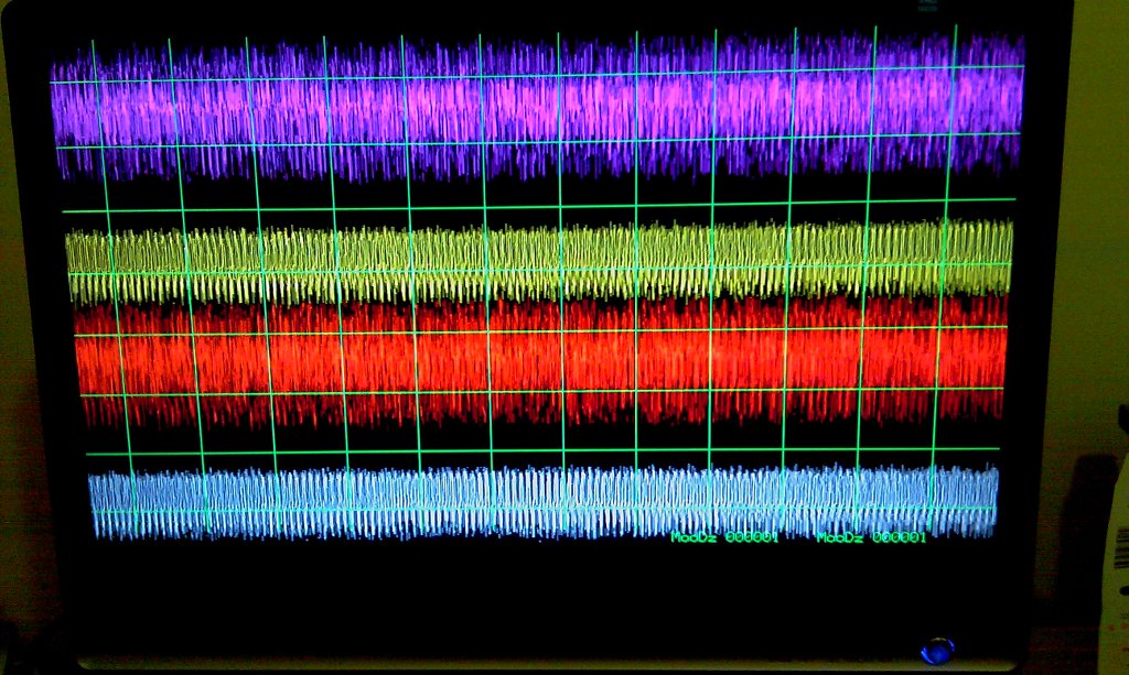

                  here are the 4 channels displayed 600 x 800 from the VGA port on the FPGA board showing raw input from the on board ADCs

                  below .. the board showing the LCD ... note the text in the lower right hand corner of the VGA in the pic two up. The LCD displays on the VGA as well.

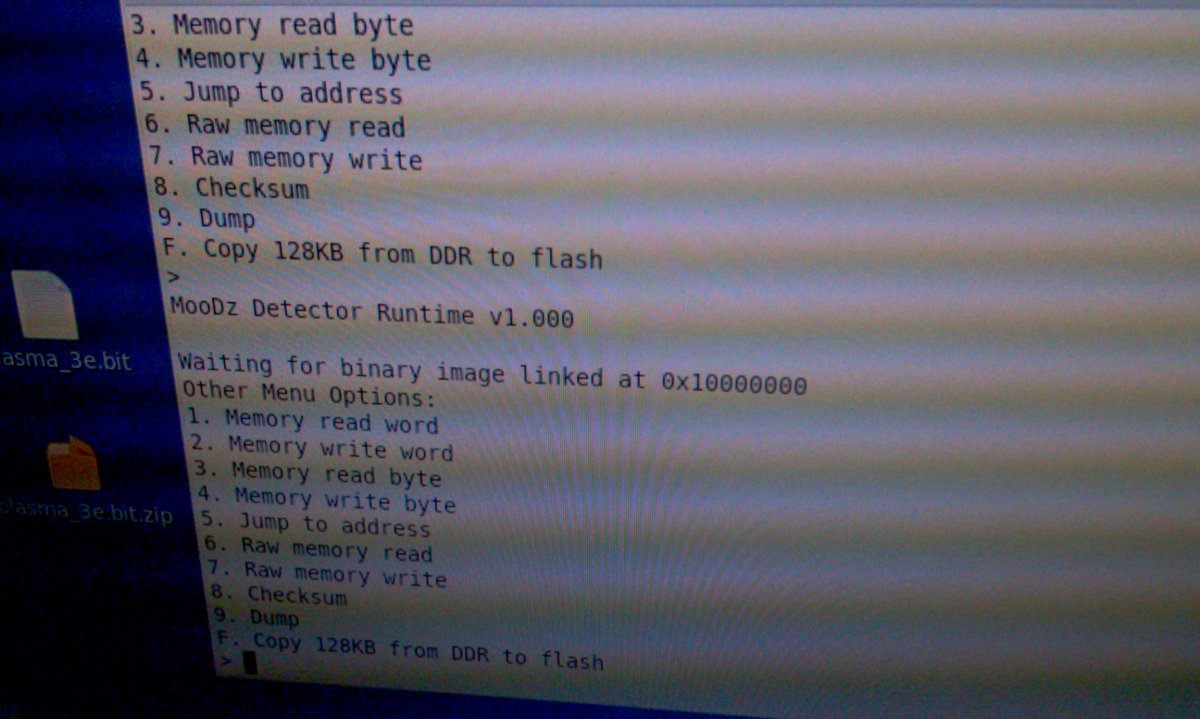

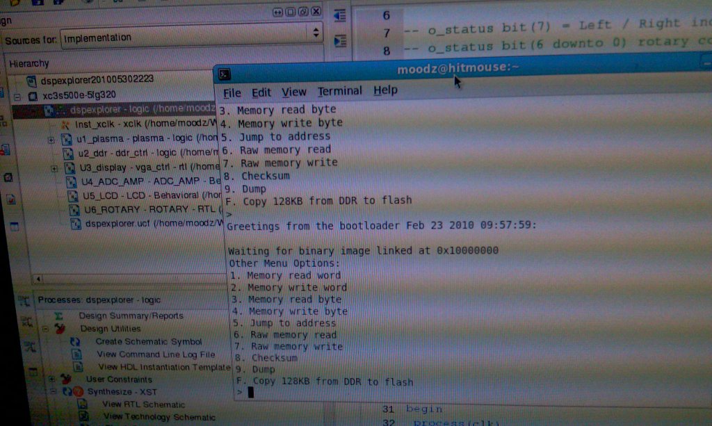

                  below is the serial console attached to RS322 port 1 on the Spartan board. 115.2 Kb
                  If you want to read / write stuff from memory the addressing is 32 bits The video ram starts at 0x50000000 Line 1 of the LCD is at 0x50001040. You can read and write memory from the console menu. The rotary knob is available on the IP port GPIO bits 0 to 7. The 8 LEDs on the board will also change according to the Knob being turned.

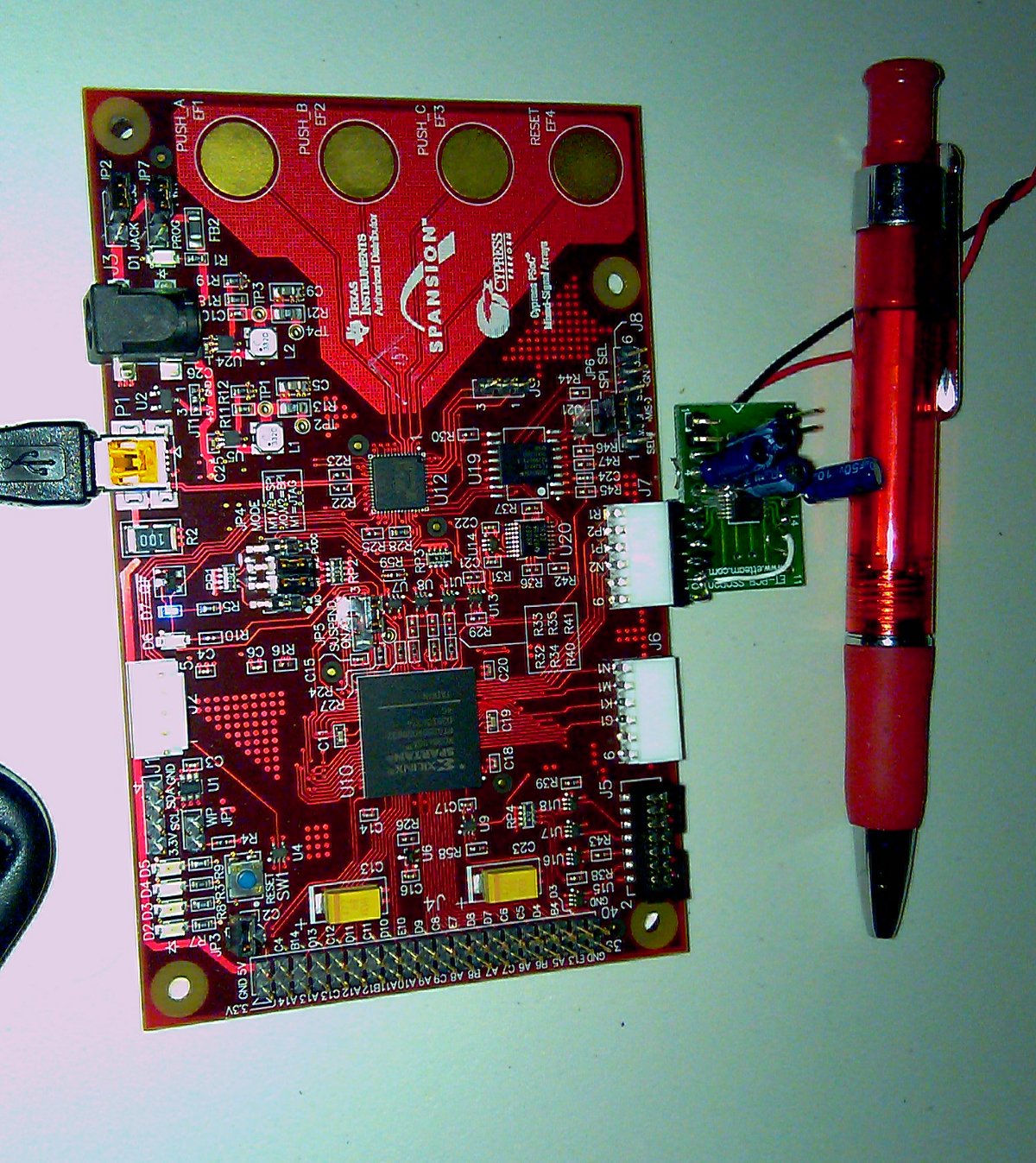

                  • FPGA progress
                    Completed porting the detector code from the big expensive Spartan 3E board to the much smaller cheaper ( $US 49 ) Spartan 3e board.
                    The design fits very nicely into the chip and the four channel scope and VGA display function is still included.
                    LCD 2 x 16 char driver OK.
                    Rotary encoder control for volume etc OK
                    Pulse Generator for PI Tx OK
                    DSP processing chain OK
                    2 x 24 bit ADC input OK
                    Serial Port at 115.2 Kbit OK
                    32 Bit CPU @ 50 MHz OK
                    I have ordered the Mosfet driver chips to interface to the 3.3 volt cmos ports on the fpga and the 2 x 16 LCD displays and Rotary switches.
                    Below you can see that the board is quite compact. There is 24 bit ADC chip plugged into one of the IO ports for testing. There is a 40 pin header to connect to the front end board. The frontend board will carry the Mosfet, protection diodes, Amp ( if required ), ADC, damping resistor etc ... not much really.
                    The total cost of all the electronics and case will be cheaper than $US 100
                    Add your poles and coils of choice.
                    Success ! the MooDz detector runtime starts up on the small board.
