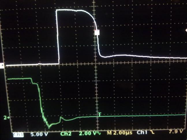

          Below is a scope pic of the output of the first diff amp ... bit under 7 usec on the pulse ... not too bad considering there is more room for improvement yet.
          25 cm differential monocoil
          100 us tx pulse
          12 volts etc etc.
          The white trace is the output from the diff amp.
          The Green trace is the TX MOSFET switch gate drive.
          ... my receive pulses used to look bad ... now my mosfet drive looks worse ... probably due to the 1000 volt p/p now with the very short pulses.
          cheers from moodz

          • Hi Paul,
            Regarding the dirty gate voltage:
            The parasitic capacitances between gate and drain may cause this. Therefore a low impedance gate drive is necessary.
            Regarding balancing the differential coil ends due to capacitive load of the mosfet and drain diode:
            It is very important, to balance out the differential ends of the coil. So making this totally symmetrically. If you don't use a bipolar tx pulses, the other end of the coil could contain same mosfet (wired for switch off, gate tied to source). You need a drain diode on both mosfets.
            Or use an adjustable capacitor for balancing out the differential coil ends.

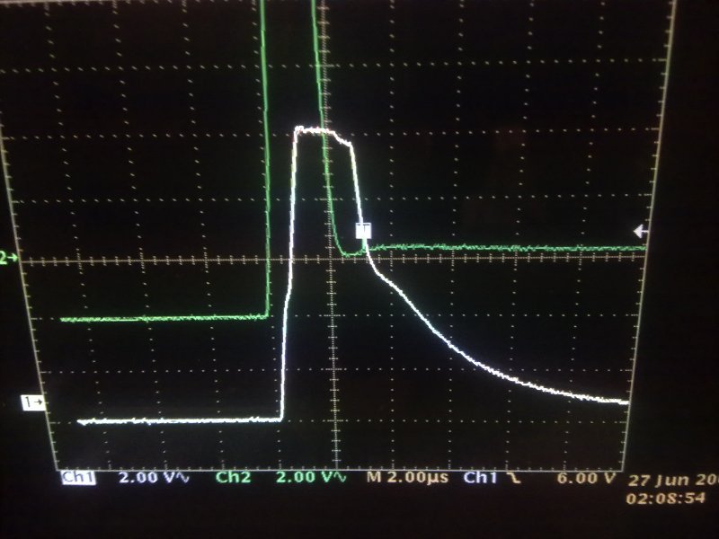

                  • Well guys ... I 'tuned' the damping on the diff coil and below you can see a scope pic of a flyback decay ( green trace ) of 2us with the output of the diff amp ( white trace ) giving a first sampling point of 3us .... I dont see any point to improve beyond this or there will be no pulse left ..
                    100 us tx
                    16 turn 25 cm diff coil #22 magnet wire
                    12 volt drive
                    coil R = 2.0 ohms
                    moodz
