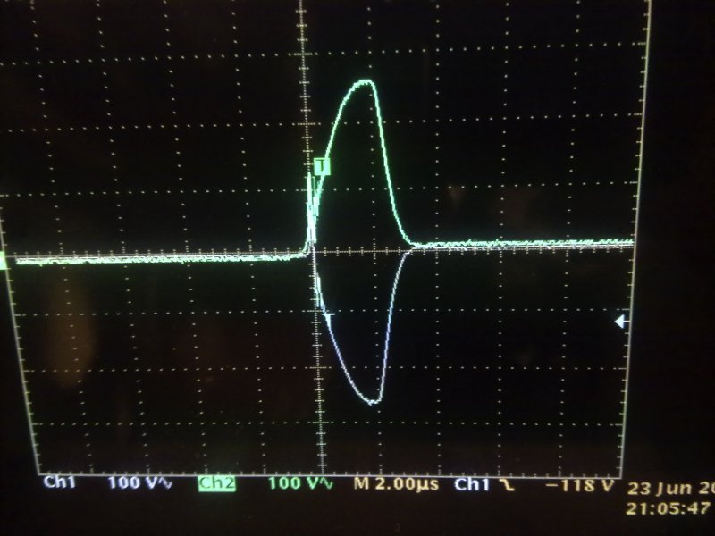

                    • Well .... will the differential coil ever deliver practical results ? ... a chance remark by Simon in an earlier post has sparked ( no pun intended ) the latest development on the differential circuit. What would you say about a 3 uSec decay with very ordinary components on a standard ( well a standard differential ) coil made with AWG 22 copper magnet wire ... no fancy teflon here ... though I have been pricing it on ebay.
                      Pic 1 ..... 3 us decay .... about 500 volts p/p Tx pulse is 100 uSec 12 volt supply ... this coil before the circuit mod was running at best 12 uSec.
                      Hmmm I wonder if we will actually be able to sample at 3 uSec at the base of those pulses ???

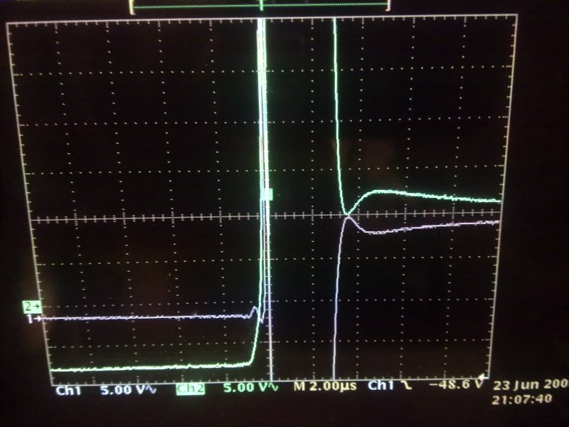

                      Pic 2 ... whew ! look at that first sample point ... no problemo. Scope set to 5 volts per division.

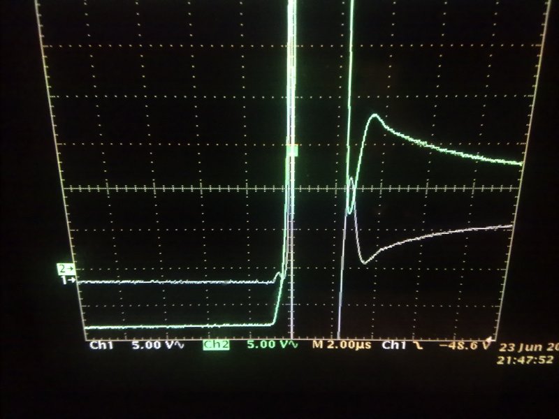

                      • ... well now I suppose you will say that I'm merely chopping the pulse short with some sort of clamping switch ... I would have made some such remark if I had seen the previous post ... well I am not ... so here is the same close up with copper target.
                        ... literally volts of response
                        PIC1 .. everything identical to last pulse except for target ...

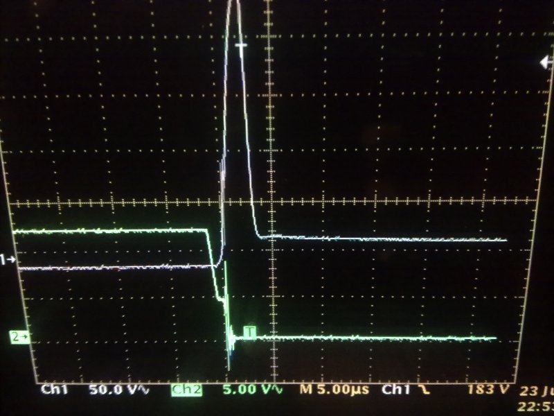

                        • ... and now the +ve pulse in relation to the MOSFET gate drive. Note the hash at the base of the rising edge of the flyback that gets into the gate drive ... the circuit is not completely optimised .... I feel it could do better ... but would there be any benefit ??
                          ...anyway here is the pic. The flyback scale at 50v/div gate drive at 5v/div.

                          • Are you still using the comparator to drive the MOSFET? If so, you may want to consider using an active-off gate driver using discrete components, or a gate driver IC instead.

                                ... yeh I put the comparator in to invert the tx drive from the PIC as the IO line was turning the FET on when the PIC was in reset state. Point taken though ... luckily the hash is not on the side that I need to sample .. but I have got it on the todo list.
                                moodz.
