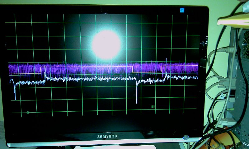

                • FPGA progress
                  .... The RX filter banks, the oscilloscope function and the TX pulse functionality are operational. Have not built frontend yet so the shot below shows the output from the chip with no coil / frontend connected. The purple trace is the unfiltered input the white trace is the output from the digital filter ... I no longer need my Tek CRO
                  Note the whole display is generated by about 6 digital outputs on the FPGA and few resistors...... basically a 'free' scope.
                  The TX pulse ( yellow trace ) is the MOSFET driving pulse and is 127 uS duty cycle in 512 uS.
                  Sorry about the flash on the screen but it takes a much clearer picture of the traces with the flash on ... must be the lighting in my 'lab'
                  moodz

                  • Nice work moodz! This project is really coming along!
                    I had looked into FPGAs a while back, but it seemed very cost prohibitive for the general hobbyist. Watching your work with them has renewed my interest.
                    BTW, are you programming in Verilog or VHDL? I've learned Verilog to some extent, but have not had any experience with VHDL to this point.
                    • Originally posted by hobbes_lives View Post
                      Thanks hobbes ... FPGA boards and tools are alot better and cheaper than they were a few years ago. You can certainly get cheaper Microprocessor development boards however you cant do the sort of real time things that the FPGA can do .... there are boards from Digilent and Avnet that for about $75 that are perfectly adequate. Coding is no more difficult than a micro IMHO and might even be easier if you are used to building stuff in the old days from discrete logic like TTL and CMOS. I found it harder and longer to set up the Microchip PIC IDE and get coding than the FPGA development ISE from Xylinx. ( Have not tried Altera but it looks similiar )
                      This project uses VHDL which has a more structured format than Verilog .. however I have built up big microprocessors in the past using Verilog and it is easy to convert code from one to the other automatically or even use mixed code modules.
                      Moodz.

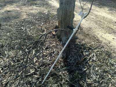

                          Thanks Ian ... I dont have any secret coils so I see no reason why not .. I am still doing alot of work in the coding department ... and as I dont have an example to copy some of it is new ground ... In the background do you or anyone know of anyone selling the shaft to hold the coil and the bit box ... I found this product which looks cool ... not sure if there is a dealer in Oz .... http://www.andersondetectorshafts.com/27.html
                          Moodz.
                          • how about this,is a simple pole/stem assembly with a twist lockextension,as used for PulseMate PI detectors here in Oz.Pm if you interested in one Moodz.they made in S.A.as well.even to small lots if required.
                            regards Rov
                            • Originally posted by Rov View Post
                              regards Rov
                              Hi Rov what are they made of. All plastic or top metal bottom plastic. Who stocks them or are they custom made ?
                              Thanks for the info ... much appreciated.
                              Paul.
