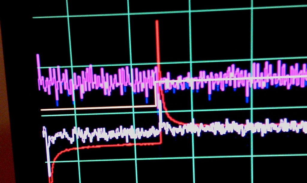

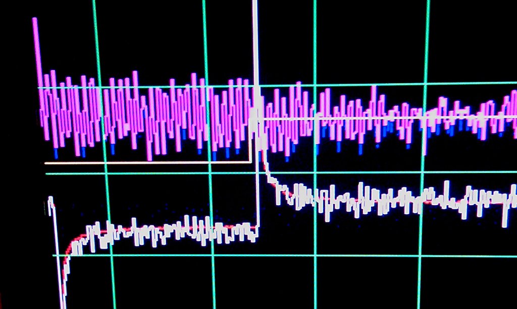

    • FPGA progress
      ... adding the first filter bank for ground balance .... below are traces from the built in scope funtion showing the TX pulse ( yellow ) the input signal ( purple ) the target signal ( white ) and the reference ( red ) I have demonstrated a target showing how the target signal white moves away from the red reference. Note how the digital filters have extracted the clean reference ( red ) from a very noisy input .... cant even see it on the input signal ( purple )... that is one smokin filter even if I say so myself.
      The input signal is depends to some degree on the TX pulse, the target signal is derived from the input signal and so on.
      The red reference is the equivalent of sampling with a 28 bit ADC ... moodz filter function .. and to think I hated maths at school.
      This milestone shows a number of things ....
      1. all four channels are working correctly on the built in scope function
      2. sync lock is rock solid
      3. the filters work better than I expected.
      Moodz
      NO TARGET below
      with TARGET below

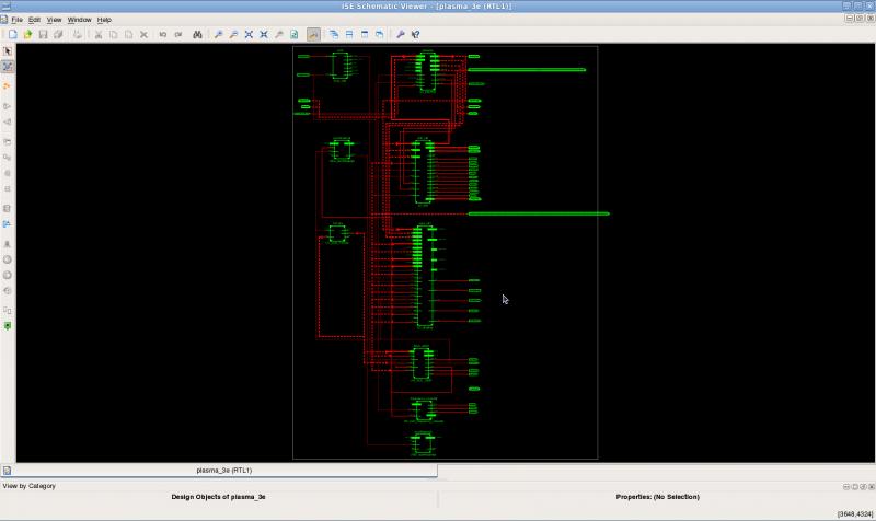

      • Easier than you think.
        All this FPGA stuff seems terribly confusing for some hobbyists .... even though this whole project is coded in VHDL ( hardware description language ) ... you can look at it as a schematic ... and you can actually edit the schematic and not write any code at all if you want to.
        Below is the actual schematic for the TMPI project that is the FPGA backend .... This particular schematic was drawn automatically from my code. ...each chip is a code module and the wires connecting it are signals that are defined in the code. You can expand each "chip" into a sub schematic till you get down to gate level ( AND, OR etc ) The main "chips" in this schematic do the VGA function for the scope, the filters, Freq counter, LCD control, pushbuttons, filters, 32 bit CPU, ADC control and memory controller. All these "chips" are programmed into the FPGA chip.
        All the VHDL code does is describe the connectivity and behaviour. Each time you write a block and connect it to others a new "chip" will appear on the schematic. So if you are used to working with schematics and chips its not that hard....
        Mooodz
Name:	Screenshot-ISE Schematic Viewer - TMPI.jpg
