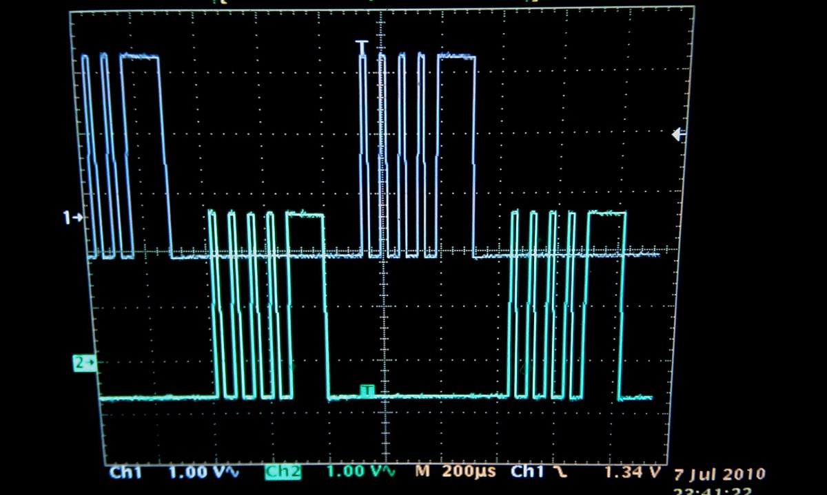

      Differential front end pulse driver completed. Pic shows a quad pulse burst with long follower. Alternate pulses drive the two sides of the diff coil switches. Burst repetition is set to 512 uS. Pulse widths adjustable by 10 ns steps ... individually. All settings mapped to IO ports on the onchip CPU as 16 bit words.

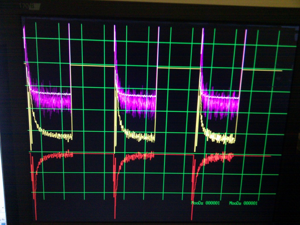

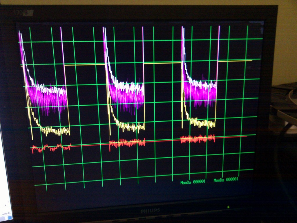

        • ground balance on FPGA moodz detector achieves long range detection
          A picture says a 1000 words.
          FPGA processing waveforms 100 uv division approx ... thus the top displays are off the scale as they are several volts ... pink = output of synchronous filter 1 . white = reference baseline filter yellow = output of synchronous 2nd stage filter. Red is the output of all processing contains target info ( VGA waveform display generated by FPGA chip ) These are not 'analogue' signals they are samples from the processing chain inside the FPGA chip.
          THE GROUND signal .. is there a target here or not ... hard to say

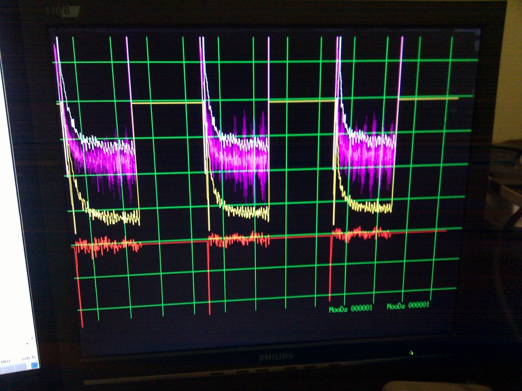

          After pressing the BALANCE button ( manual or autotrack available )

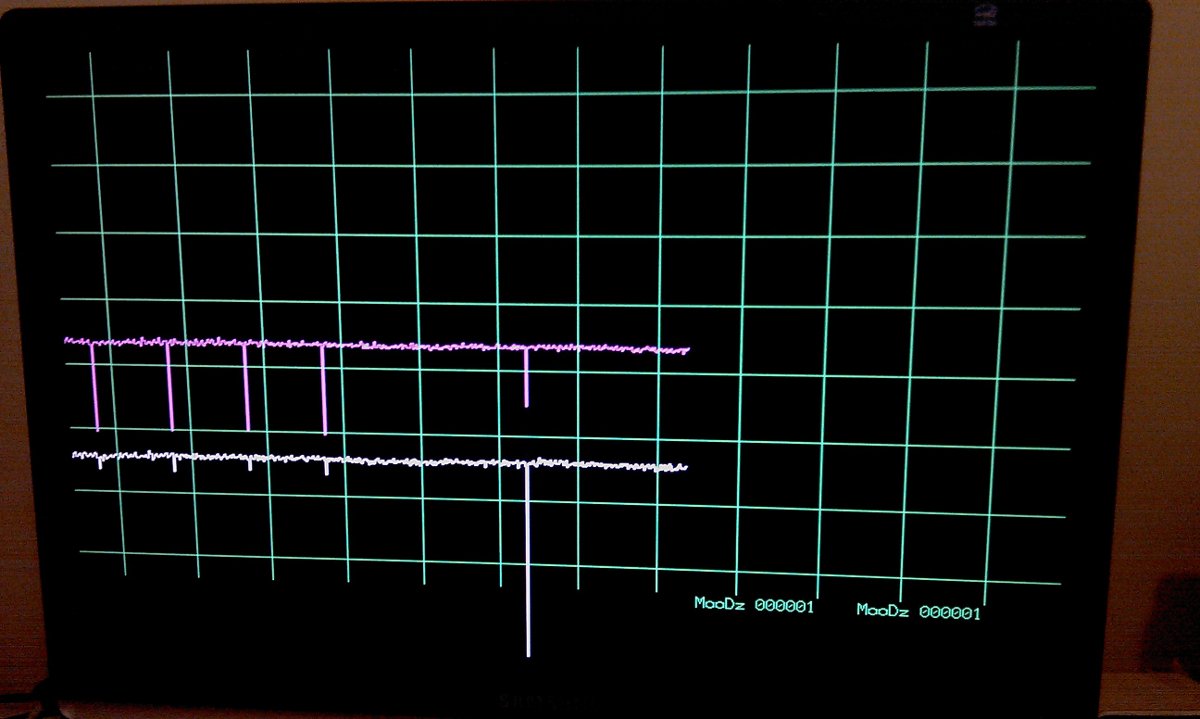

          And the target signal a Aus 20 cent coin at 90 cm from 18 inch coil.
          The polarity of this signal will depend on metal type !!!!
          This signal will be alot higher in magnitude and width for larger and closer targets.

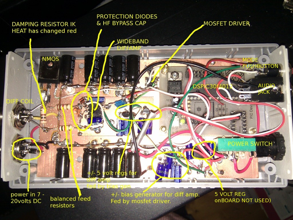

                    • NEWS FLASH ..--.. ..--. FPGA code crammed into DSPIC chip .. read all about it.

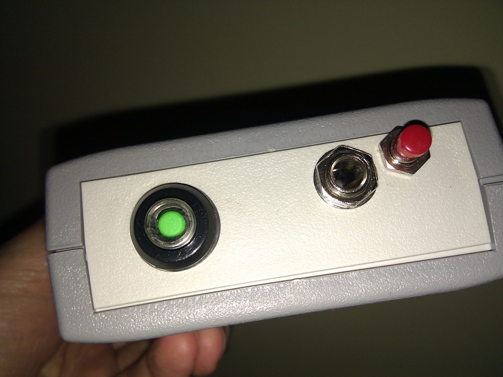

                      Field testing proceeds on a "Model T" version of the differential frontend as per previously published schema. The processing code has been ported to a DSPIC 30F4012. This chip is "barely" fast enough to run the core algorithm as implemented in the FPGA code. ( Curiously the PIC chip alone draws more current from the 5volt supply than my FPGA board which is hundreds of times faster .... )
                      As I have previously stated ( claimed ?? ) the differential front end has significant benefits over the single ended coil designs.
                      Field testing is now proceeding however early indications are that EMI ingress is hugely reduced over comparable PI designs. Coil sheilding is NOT required except maybe in ultrasensitive equipment like the FPGA design and that is a maybe.
                      The "MODEL T" version as shown below is designed to demonstrate the benefits of differential front end whilst achieving a price point below even simple PI detectors like the surf etc.
                      It does this by utilising a minimum of front end components feeding into a cheap DSP CPU that auto compensates for coil decay and ground balance etc. There are no displays and the audio is driven directly from a pin on the PIC via a 220 ohm resistor.
                      It can run on 7.5 to 20 volts and the bias generator is a simple capacitor / diode network that is driven directly from the same mosfet driver driving the main TX.
                      If we dont count the cost of the case / hardware the component cost of this circuit is less than $30.
                      AMP = $7
                      DSPIC30F4012 = $5.40
                      FET = $5
                      DRIVER = $2.50
                      Misc diodes, resistors, caps $5
                      The TX pulse repetition is slightly more than 5 Khz.
                      I will be conducting extensive field trials over the coming weeks to verify the design .... away from the bench and the armchair.
                      Regards and happy holidays .... Moodz.
