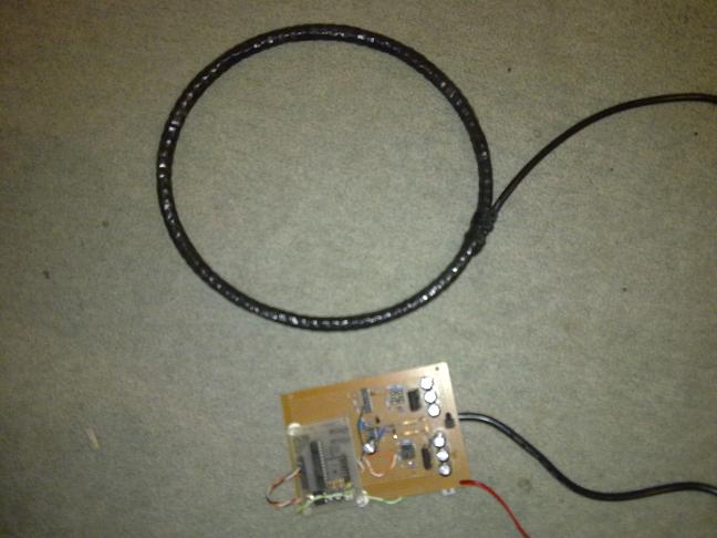

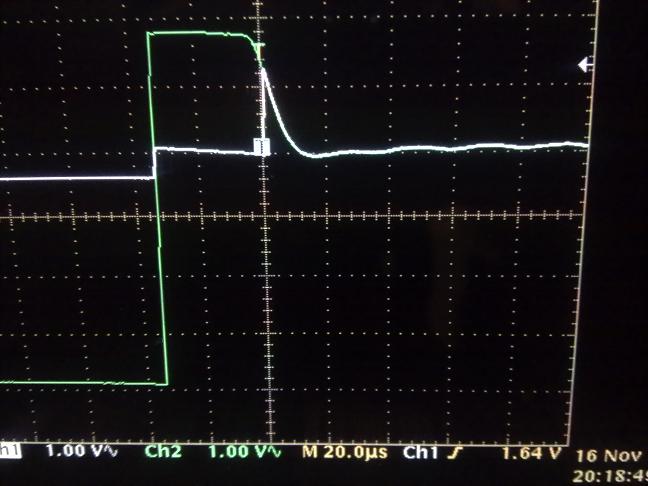

    Anyway to answer quickly the questions about the 4066 driver cct ...
    It does actually work
    below is the output of channel 1 with about a 40 uS delay after first turn off the green trace is the input to the 4066 ... white trace is the sampled output ... the timing is set to intercept the decay slope at about 75 %.
    and here is the breadboard with 60 turn 'boss' differential coil. Note he circuit here is built with a balanced FET driver. Because of the number of turns in the coil it is very sensitive to Earth's magnetic field. However it is also very sensitive to targets even very small ones though the sample is out at 40uS.
    ... Hey Aziz when I get more time we proceed OK ...
    Cheers from moodz
          I'm surprised! You may want to check the margins, it may be just barely working.

                      • You're going to need an input offset trim on that CA3130. Your DC gain is so high that you will also amplify the input offset voltage significantly.
                        • Originally posted by w5cdt View Post
                          ... maybe ... however if you look at the scope pic a few posts up ... this shows the actual output of the amp ( overlayed with output of the first sample switch ) and it works fine without any offset trim. moodz.
                          • CA3130 input offset voltage
                            You got lucky. Check the CA3130/CA3130A data sheet. Max input offset voltage is published as 15mV and 5mV respectively. So for a gain of 1000 and a Vos= +/-5mV the output would be sitting at +/-5V. Clearly the specific 3130 that you used was better than that. But the manufacturer considers a Vos of +/-4.99mV as "good" for a CA3130A factory test screening.

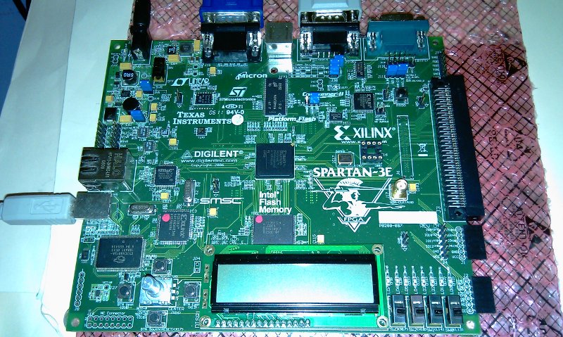

                            • balanced PI backend ....
                              .... after a few months of busy times in the coalmine ... I now have time to return to this project. Below is a picture of the backend of the balanced PI. The foundation is a generic FPGA development board. The system supports a 50 Mhz 32bit soft RISC system with 16 Mb of RAM 4 Mb of Flash, ether port, USB, 2 x serial, 1 x VGA, rotary switch, LCD etc. ( ie everything you need for a detector box ... just add code )
                              Code is well developed to implement an inbuilt Digital Oscilloscope that will be able to display TX and RX waveforms in the field without lugging a real one around. The display, timing and triggering will be specially adapted for displaying the interesting parts of a PI detector waveform on a small vga display. The input is a full differential 24 bit ADC sampling at 4 Million samples per second ... this greatly simplifies the frontend electronics ( Goodbye to analogue sample and holds ).
                              All the housekeeping code is programmed in C ( future plans basic interpreter ) whilst all the time critical stuff is programmed in HDL ( hardware descriptor language .... goodbye nasty assembly code )
                              All rx processing is done in the digital domain and tx is also generated using programmable state machine to produce arbitrary waveforms including a "listen" function where the detector can receive the TX waveform of another detector and reverse resolve the timing to clone the pulse waveform no matter how complex. All timing clocks are programmable and the test version can implement a 5ns resolution TX PWM modulation wave form with upto 32000 pulse transitions in a single TX cycle. The board utilises high efficiency low noise switch mode supplies to support battery operation.
                              The total cost of the project to purchase new modular components is pegged at $US 300. ( make your own coil / wand and no cost for software image ).
                              moodz

                                THE FUTURE OF MD IS HERE!!!!!!!!
                                Fantastic moodz. Congratulation!
                                What is proper ordering code of your TI Spartan -3E board?
                                How to get your software image?
