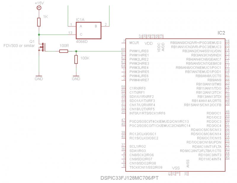

    Yep, gottcha, just looked at PWM port line source / sink specs, I was having a seniors moment...
    I was originally concerned with damage to port pins but given your resistor values, should be ok.

      • Industry standard analog switches
        Hi Brian,
        the CD4066 has not a logic level shifter built in (*shame*). There are DGxxx devices that do it. But there are also improved versions available:
        MAX313
        MAX392
        MAX333A
        These analog switches makes the driving with MCU logic levels easy. Some of them are precision type and cost more.
        You can also try the CD4053 (only 3 switches).
        I like your new design.
        Aziz
          doh ... just realised that explanation is wrong sort of.. when the PIC port is high the 4066 is ON. When the PIC port is low the 4066 is OFF. The diodes prevent the PIC high level from driving the port ... this is done by the pull up resistor to get correct bias.
          moodz (again )
          I don't think this circuit will do what you want it to do. The pull-ups won't pull up to +15 when the PIC outputs are at +5. They will only go to 5.7V, which probably isn't enough to switch the 4066. You really need a bipolar (with base R) or a FET in place of the diodes.
          - Carl
          • Something like this perhaps...
            Cheers
            Brian K
