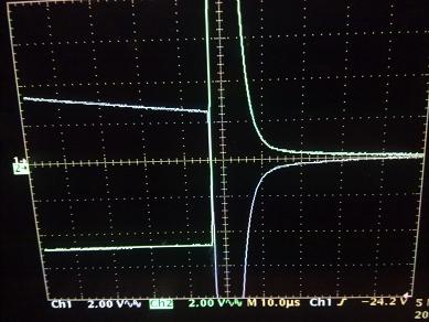

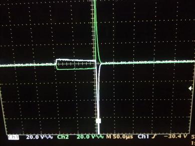

        scope pics moodzPI differential front end v300a
        Green measured at point b
        White at point A
        obviously there is no amplification here.
        There are also more elaborate / different ways to apply the TX drive sigs.
        pic 1
        NO TARGET
        flybacks peak at +100 and -100 volts.
        note the convergance of each decay to the baseline.

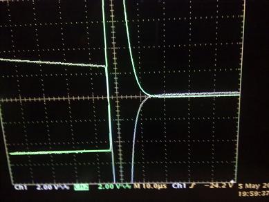

        pic 2
        Close up of decay baseline
        NO TARGET
        pic 3
        Copper target
        Note the changed convergence of the +/- decay lines
        Just what a diff amp likes
        Note how the change is symmetrical

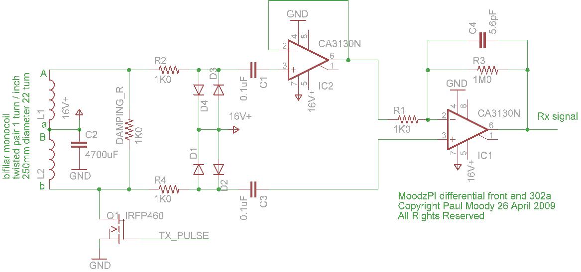

              Thanks Carl & Hobbes ...
              I did some comparisons to the single ended designs I looked into and I am getting nearly twice the voltage differential as I did with single. Rather nice as the mosfet only sees half of that voltage as it sits on only one of the hot sides. 750 volts approx differential ( ie 350 + on the mosfet with respect to ground. Settling was improved but not by a factor of two. Any improvement is good right ?
              Anyway I made some more changes as the previous circuit wasnt so hot ( or rather too hot ) and I blew up a couple of amps. Also got better balance by getting rid of the two damping resistors and replacing with single resistor. compare schem below to one posted previously.
              BTW I am not an agent for CA3130 amps ... Its what I have most of.
              moodz.

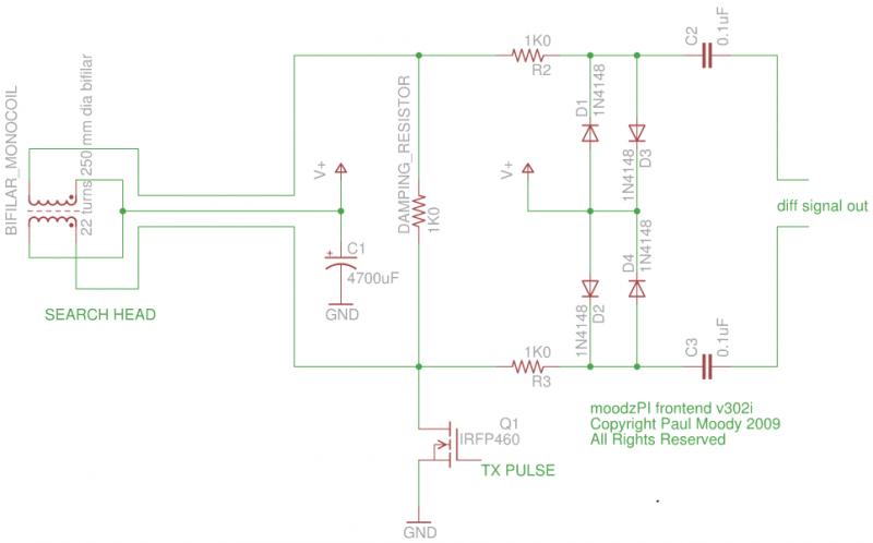

                              ... fair cop .... Redrawn with dots and hopefully clearer .... cheers from moods

                                Hi moodz,
                                What is the purpose of IC2?
                                It looks like your balanced design is getting better each time.
