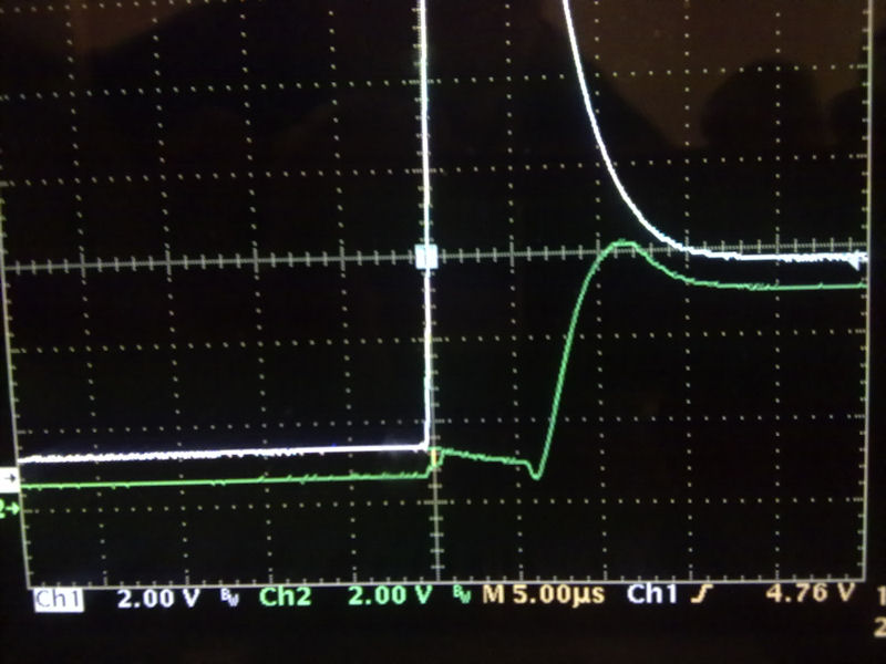

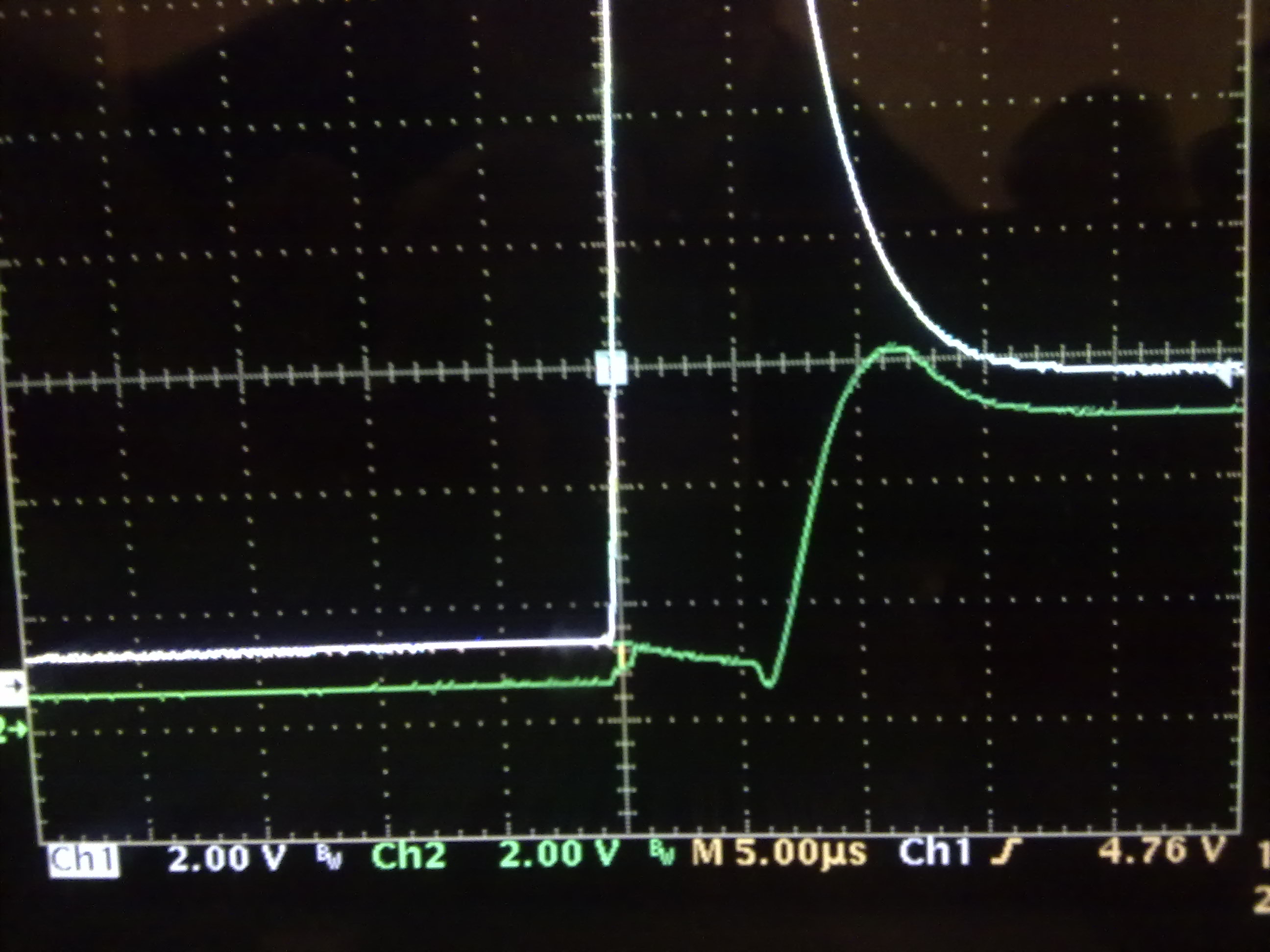

                        Thanks okantex ...
                        WHITE is the flyback pulse 175 volts peak .. you wont see the peak here obviously with 2v/div. We are looking at the base of the pulses here.
                        GREEN is the sample.
                        note the sample is not amplified .... it is o/p of sampling stage and is the input to my processing stage.
                        The peak you are looking at is part of the flyback. See the pic above ... the sample is taken from the falling ''wall" of the flyback. I have offset vertically the sample and flyback however you can see from the shape that the sample tracks the flyback exactly in level on the falling side. I dont use clamping diodes at all in the front end in my current scheme. The use of clamping diodes throws away the useful signals on the falling curve.
                        The other thing about clamping diodes is that they unclamp ( ie provide useful signal only when the forward conduction voltage is below 600mv etc )
                        This could occur at any time depending on the slope of the curve. However targets change the shape of the curve thus the point at which the diode unclamps ... start of sampling if you will ... is not fixed in time. My frontend sampler always begins sampling at a fixed time. ( not too early of course or I will dump high voltage into my front end ... i have not managed to do this yet.)
                        Note also ... some may think I am simply attenuating the flyback peak down to the sample level ... this is not correct the sampler is a switch that switches at a predetermined time after the tx pulse has ended. Approx 5 us here.
                        note also the peak of the sample intercepts the curve at the correct level.
                        ( noting that I have moved the position of the flyback up slightly so that the sample trace is not obscured. )
                        note the 'soft' rise time on the rising edge of the sample ... this is good for me as there is less hf energy in the pulse to be processed and I can use slower op amps.
                        cheerz from moodz

                        • #42

                            • #44
                              Originally posted by okantex View Post
                              Hi Moodz ,
                              thanks for explanationss.
                              I am confused about pictures.
                              at previous posts ,picture for copper,I choose this because it has lowest peak ,lower than also no target option.
                              at 10us peak is 2V
                              at 50us peak is 1,2V this is good.
                              but at your last picture
                              at 12us peak is 0,6V
                              at 15us ,it is 0, disappears.
                              maybe I am reading scope ,in wrong way, excuse me than.
                              regards/thanks for your understanding
                              Hi okantex ... the last picture was intended to show how the sample is taken from the falling edge of the flyback spike rather than being cut off by clamping diodes. Also the CRO set to 2 volts/div 5 uS/div rather than 1 volt / div 10uS/div in previous pics. I dont think there was a target in the coil at the time.
                              It is important that the fly back pulse effectively gets narrower in presence of good conducting target ( sample peak goes low ) ... wider with ferrous target ( sample pulse goes higher ) ... the base line will also lift in both cases.
                              moodz
