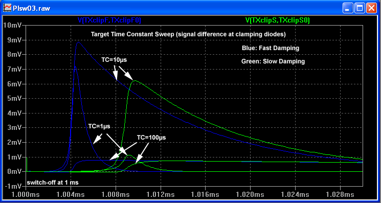

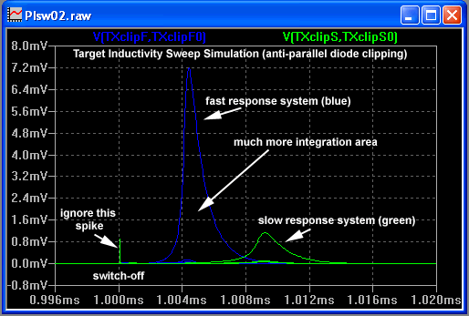

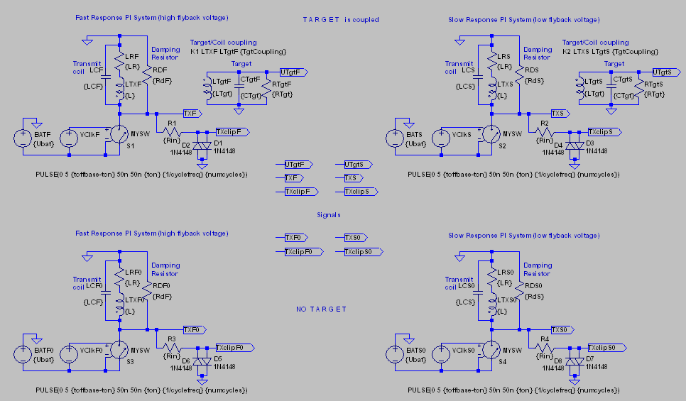

                    Hi all,
                    I made some circuit simulations. A four equivalent systems were analyzed:
                    - Fast coil damping, with target (left/top)
                    - Slow coil damping, with target (right/top)
                    - Fast coil damping, no target (left/bottom)
                    - Slow coil damping, no target (right/bottom)
                    The slow damping is achieved with higher coil capacitance. The flyback voltage is quite lower than on fast response configuration. Same transmit pulse energy on every system. You can see, that only few mA are missing on the slow damping. Where the hell is the missing energy gone? -> it is stored in the higher capacitance.
                    The signals are named systematically:
                    F for fast, S for slow, 0 means no target, xxclip.. means the coil voltage at the clipping diode. The Rin resistor is set to 10k to avoid damping resistor inbalance (for critical coil damping).
                    Please play with the circuit simulation (LTSpice model) and make different sweep analysis for:
                    - different pulse width
                    - different target inductivity (target size)
                    - different target resistance (target conductivity)
                    You can scope the signals, make the comparison between the simulation models. You will find interesting facts.
                    Now see the following response comparison at the diode clipping:
                    The fast response system gives tremendous big target signal response for bigger targets (higher inductivity). That is quite interesting.
                    The simulation models are very basic but quite accurate. The coil is splitted into three parts: series coil resistance, coil inductor and coil capacitor.
                    Have fun with circuit analysis.
                    Aziz
                      here is the basic circuit of the models...

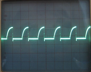

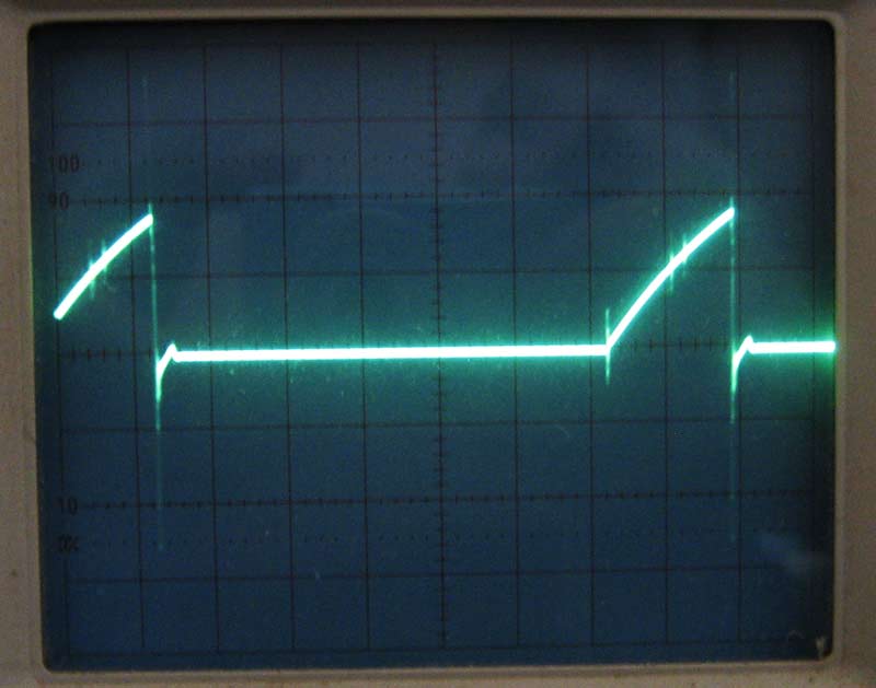

                        Hi Mark,
                        I think you come closest to what is actually happening.
                        OK it is not traditional PI. It is probably more of a hybrid.
                        I attach 2 pictures of the current wave form. If we look at the current wave form instead of the voltage wave form, we see that it is not all that different from a VLF.
                        Then maybe it is easier to understand where to look for the information that we can read in it.
                        This is TIME DOMAIN, the information is locked in a specific time frame.
                        Now, I have found where to look, that is I know at what spot in time I can read some information, but I do not yet fully understand what I am reading.
                        Much less I can explain exactly what is happening.
                        All I know, is that the information is there.
                        I find it every time.
                        It tells every time the same story, but I don't understand all of it.
                        The one picture shows 10k PPS of coil current pulse. I don't remember the TC , but it looks like somewhere around 3 TC.
                        The other picture shows just two coil current wave forms. The TC is around 1 TC.
                        You can see that the switch OFF is fast and it produces a spike in the opposite polarity.
                        I think it is this spike that kills a good part of the OFF time signal.
                        You can also see on the ON slope 2 small switching noise spikes close together. This is one of the sample pulses.
                        Several samples along this slope give different information. At a certain time the FE signal is higher, at another time the FE signal all but disappears.
                        It is like an invisible sine wave is riding on the slope, the line of the slope being the 0V line.
                        Sampling where the sine wave crosses the 0V line gives no signal.
                        Non magnetic metals give a peak response at a different spot.
                        The TC of the target moves the peak spot to a different time.
                        Tinkerer

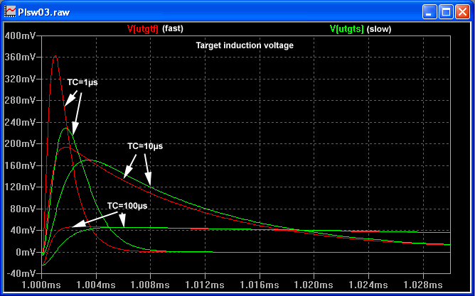

                          • #43
                            Hi Tinkerer,
                            Could you show it with a target with a TC of 10uS and again with a target with a TC of 100uS?
                            See below: Ground is taken as TC=1µs and target with 10µs and 100 µs.
                            The TC=100µs signal will last very long at low signal level, whereas the others are almost zero.
                            Could there be a correlation between a fast switch OFF and a target with a short TC?
                            I don't know. The switch off time is same for all systems. However, the higher coil capacitance will slow down the damping and decrease the flyback voltage. The critical coil damping resistor will be lower with increased coil capacitance.
                            Or, could there be a correlation between a slow switch OFF and a target with a long TC?
                            I don't know.
                            Interesting fact on the fast damping system is, that the clamping diodes are recovering faster from the conductive state, which allows earlier sampling (4-5 µs). This gives a higher sampling integration possibility, which contains effectively more target response signals.
                            Aziz

                              Thanks Aziz, great job.
                              Now lets see if I understand right.
                              There is a time delay until the response of the targets reach their peak. The peak response is not at the same time for targets with a short TC and a long TC.
                              This is exactly what I am talking about. It makes it possible to read the TC from the response.
                              Interesting about the slow damping. So if we were to sample at 1.020mS, the 10uS target would actually have a higher amplitude?
                              Tinkerer
                              • #45
                                Hi Tinkerer,
                                Tinkerer
                                it is a misleading display. Note, that the shown display is the coil voltage difference of two systems at the clipping diodes (target/no target). If you scope the target voltage only (see below, represents target eddy current and it is direct proportional to target induction voltage), then you will see that fast decaying system has a higher target induction voltage, but which decays faster than the slow decaying system. The integral of the target induction voltage over time (after switch-off) should be equal for slow and fast decaying system (due to same transmit pulse energy and TC). So there is really no free lunch.
                                Somehow, the clamping diodes in the simulation give some advantage on the fast decaying system here, which allows a bit earlier sampling. That is quite interesting, which I didn't expect.
                                Aziz
