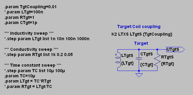

              • #52
                Hi Zed,
                Originally posted by ZED View Post
                Aziz looking at your last graph i dont see anywhere where your faster flyback has any real advantage,sampling one to two u/s after switchoff is not realistic,five to six u/sec after switchoff is a more likely scenario in which case it would appear that the slower system has more to offer.
                Zed
                Thats true from the point of target response only. If you can not sample earlier, then you will loose signal (integration area of signal).
                Darn, but the clamping diodes 1N4148 are responding better with fast system and give some real advantage over slow damping. That is, which surprizes me.
                Aziz

                  • #54
                    Hi B^C,
                    Originally posted by B^C View Post
                    Aziz, yes i thought simulating this wasn't an issue.
                    One other thing, the conductivity of copper vs gold for the simulation, if we add some resistance to the target inductor this should do the job --yes!
                    Obviously the copper inductor will show better results than we would expect?.
                    My question is how much resistance to add as a constant?
                    Or do we just adjust the coupling as talked about?
                    http://environmentalchemistry.com/yo...lectrical.html
                    I never did a real calibration yet (still haven't the instruments to measure the parameters). The target model parameters are just estimated. You can see below the very basic target model. It is really difficult to model a real target. But the basic model will give quite good results to the interesting questions anyway.
                    A target consists of some inductivity (parameter LTgt), capacitance (parameter CTgt) and will dissipate the induced energy through its resistance path (RTgt). It is more or less coupled to the TX coil (parameter TgtCoupling).
                    Fortunatelly I bought today an oscilloscope (Tektronix 455), which will help to measure or give a better estimation of the target parameters. Then a more realistic simulation could be done. The target model itself could be modelled with a lumped model. But this is quite more complex to do it.
                    Conductivity of the target is indepent to the coupling factor. I will list the dependencies of the parameters now (might not be complete):
                    TgtCoupling (target coupling) is dependent on:
                    - Transmitter coil size, transmitter coil orientation (to the target)
                    - Target size, targe distance, target orientation, target shape
                    - other objects nearby the coil/target, that affects the magnetic fields
                    Target LTgt (target inductivity) is dependent on:
                    - Target size, target shape, target material (permeability)
                    Target RTgt (target resistance) is dependent on:
                    - Target size, target shape, target material (conductivity)
                    Target CTgt (target capacitance) is dependent on:
                    - Target size, target shape, target material, other materials nearby the target
                    So it is quite difficult to model a target as the parameters interact with each other.
                    Aziz

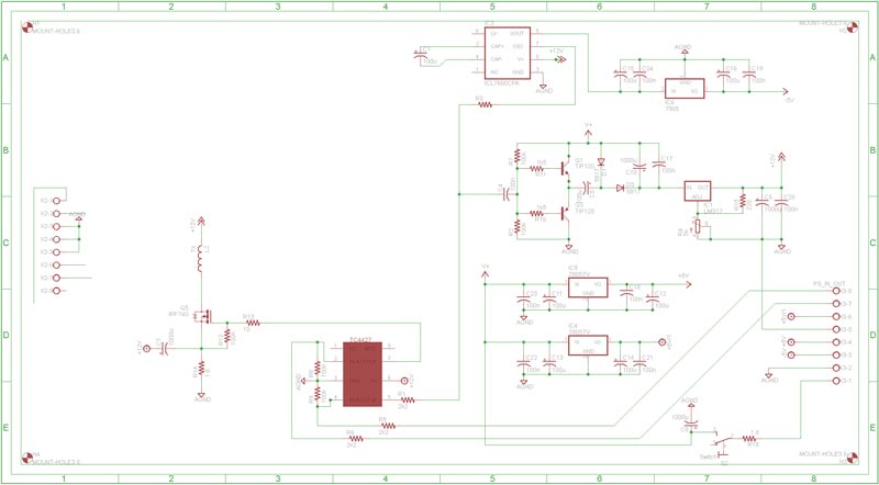

                              • #60
                                So I found the source of the noise. With the higher voltage, the power supply
                                makes more noise.
                                Here is the power supply.
                                How can I reduce the noise?
                                Tinkerer
