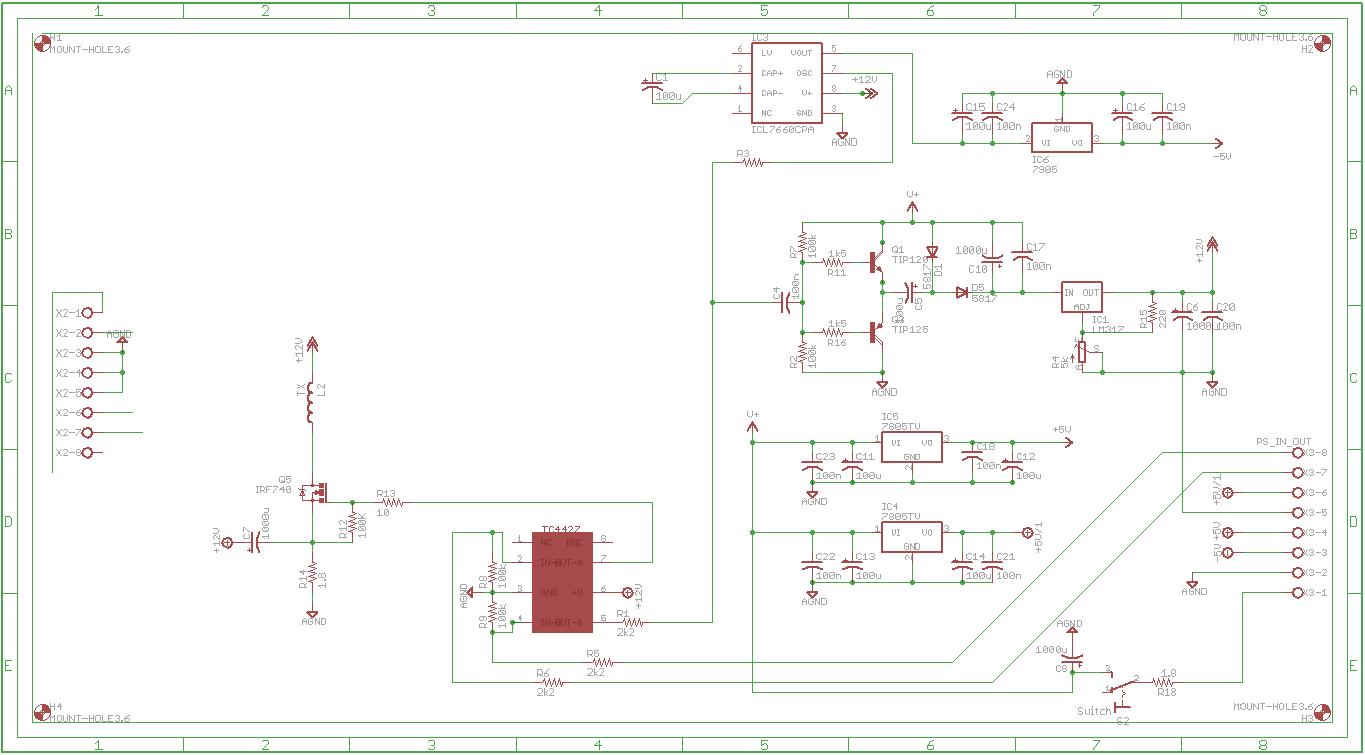

    Hi Tinkerer,
    I can hardly see the circuit, it is too small.
    Did you try adding an electrolytical cap in parallel on the V+ to AGND?
    Can't you use an external power supply (linear and regulated with a LM317) to provide 15V? If it is only for testing, that would be ok,
    Nicolae

      Here is the Zipped EAGLE file.
      Tinkerer

        Tinkerer, it's hard to see the schematic, can you post it again?

            the EAGLE is V5.4. It seems that the different versions are not compatible with each other.
            I have changed the schematic into a PDF so that should work.

                  Hi Tinkerer,
                  I suspect you refer to the +12V output of the LM317. When the output is noisy, can you check the signal at its input, if it also gets noisier?
                  I don't know if it helps, but can you try a large capacitor between V+ and AGND? (2200uF maybe).
                  What's the voltage at the input of LM317? Do you have at least 3V more?
                  I also think you can put a small cap in parallel with R4 (isn't one in the recommended circuit?).
                  Nicolae

                        The pdf works, I opened it. Maybe you need a newer version of acrobat reader?
                        How can you read the eddy currents directly from the target? Unless your target is a very tiny coil, followed by a preamplifier?

                          Tinkerer's schematic with more resolution

                            Thanks for all the help.
                            I have traced the problem.
                            Q1 and Q2 do not provide enough current.
                            The switching frequency is limited to 10k because of the ICL7662 (not ICL7660)
                            I am changing the capacitor C6 for 6800uF. (Amazing all the old stuff forgotten in the parts box)
                            Tinkerer
