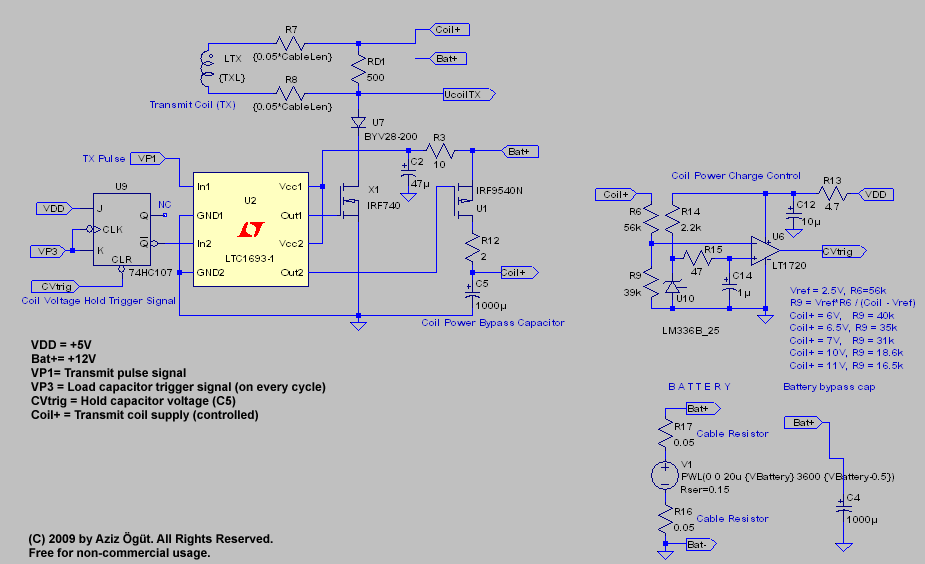

          Hi Tinkerer,
          here is an example for a coil voltage controller (see below). On the right side, the coil voltage at C5 is monitored with a comparator (with reference voltage band gap diode LM336-2.5). Once a defined reference voltage is arrived, a hold signal will be generated and the charging of the C5 is disabled. The stored energy (voltage) in C5 is hold and ready to fire the transmit coil.
          The VP3 controls in the cycle period, when C5 is enabled again for charging. The speed of charging can be limited by R12. On non-critical periods, you can enable the charging to minimize noise. So VP3 can also be seen as a start coil voltage control (falling edge triggered). You can trigger as often as you want. Once the coil voltage level is arrived, it will switch off the charging of C5.
          It shows the basic principle. You have to adapt into your requirements.

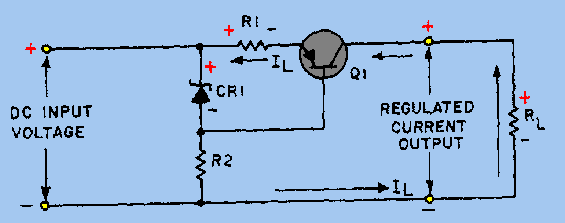

                Quote "Why not just use a degenerated bipolar transistor? "
                  A bipolar transistor with a resistor in the emitter, basically a switched current source. Switch the base off a regulated voltage, and you get a current that is constant vs battery.
                    Hi Carl,
                    I think you maybe misunderstund his needs...(or maybe I do not understand what he needs ???)
                    I think you mean something like this in the picture. The bipolar transistor will act as a variable resistor to mantain a constant current in the output end of circuit... collector part I mean.
                    But I think, though useful in many cases, this simple circuit is not what he needs. That's cause the inductor (coil) will charge with a current that rise at exponential rate not that is constant over time.
                    The use of this approach will make the transistor act like a variable resistance (kinda of solid state automatic rheostat) in series with coil...having a low resistance value at start of tx pulse... then higher resistance when the current in the coil will rise to higher levels.
                    But this will make the charge of inductor a bit "stranger" than usual.
                    In usual RL circuit we have the I=(V0 /R)* (1-e^(-t*(R/L)))
                    Now... if R stays fixed as in a normal RL circuit the inductor current rise from 0 following the above equation (exponentially) and thus having an asymptotic increase to infinite after about 5 times the ratio R/L.
                    Now the problem is... when we made usual PIs we have an active device, usually a mosfet, that switch-on and so the current flowing will charge the inductor with active device exposing an apparent resistance (e.g. in the IRF740 the Rds on is about 0.5ohm) that stays about "fixed" during the charge... so things go like described by equation... is nothing unlike that charging the coil by a line, a switch and a fixed resistor... just we make by mosfet that's nothing more than an electronic switch for us.
                    In the case of transistor constant current source, instead, we have something that will change resistance to mantain the current stable, it's a completely different thing.
                    The approach is wrong... cause he needs just to control the peak-current value just before switchoff, that's why I proposed him the use of e.g. a sensing resistor + comparators for that: the charge will be exponential as usual but he could control and set a preferred value of peak-current before the switch-off take place for each of the tx pulses.
                    Kind regards,
                    Max

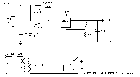

                        LM317T can deliver max 1A, LM317K can go (hopefully) for 3A.
                        I think you need something more... cause even staying in the limits of above you'll get them run VERY hot... in a few time unless you use a large heat-sink stuff.
                        I suggest you'll dig some LM338K... it's a powerful linear regulator for 5A range, TO-3 package.
                        I suggest if find more than one... to put a couple in parallel and thus will stay safe in regulation till 10A.
                        The big advantage is that if you use the right voltage input level you can run them COLD at several amps, and that with small heatsinks.
                        You could also make a quick and dirty regulator using parallels of e.g. (old nanny) 2N3055 things...bipolar , 75W stuff each...TO-3. But in this case you'll need small resistors... usually in the 0.3ohm range to prevent damages to the transistors.
                        Another solution is an array of LM317T (say you need MUCH of them)... teh advantage is that are about cheap parts... can find anywhere still and if you burn them , well... no regrets I think ! Or can use pass transistor... why not ?
                        There are other solutions like SMPS ics with e.g. low frequency transformer or inductor.... but they add bedlam of noise to the circuits they will supply.
