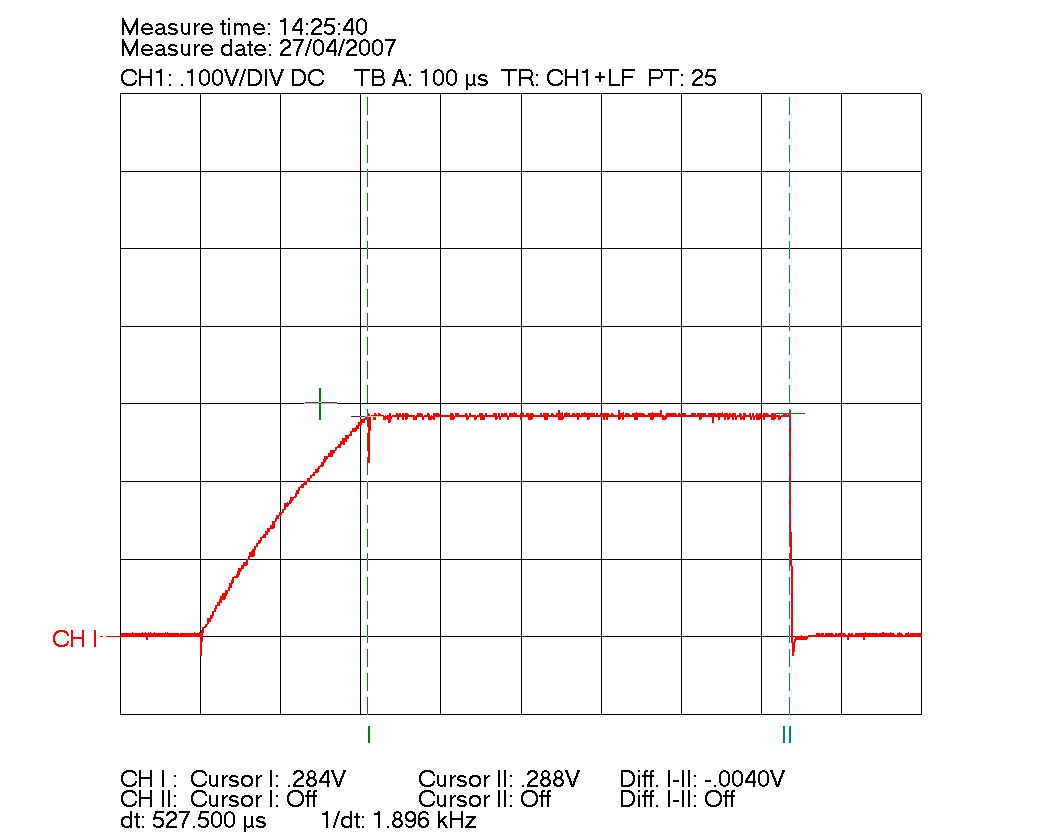

      What does the charge current ramp look like?
      Tinkerer
        Tinkerer it looks almost identical to this pic but this pic is from a different cct and also it was running on a 6 volt battery,the current cct usus 12v so the current climbs a bit faster,from memory this cct reachs 3 amps in 100 to 150 u/secs.
