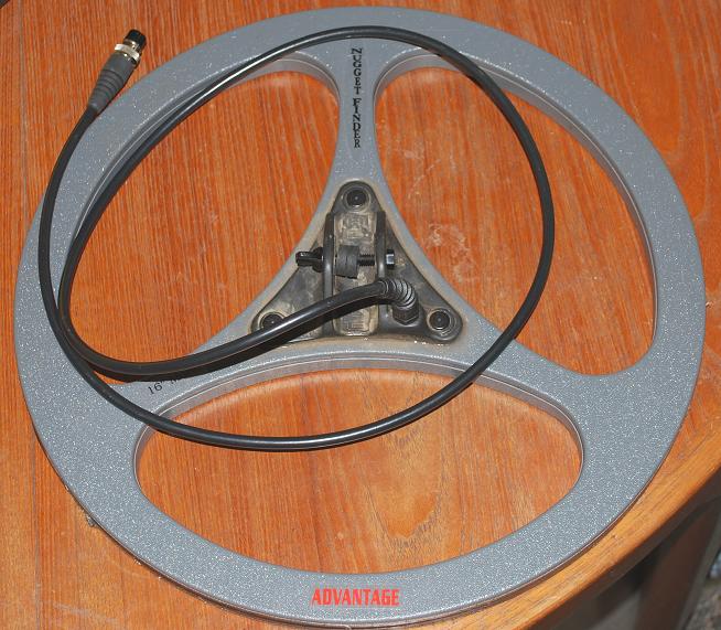

                          B^C I was wondering which coil you are using on your 4500? Size and type. I wonder as for being able to capture the return eddy current from the target, how much noise in the components really gets in the way of what we are trying to do? I have always wondered as the coil is lowered to the ground, especially bad ground if the magnetic field is caused to propagate very far beyond the outer perimeter of the coil or does most of the field just go straight into the ground? These are my whacky questions. Thanks B^C and I appreciate the info that everyone shares here. It is a great place to hangout.

                            I use the 16" Advantage Mono coil from Nugget Finder (Picture Attached)which is an excellent coil but can get noisy in really bad ground even with the 4500.
                            For bad ground i use the Std 11" DD coil which is very under rated due to people wanting better Coils, the thing is it's a fantastic coil given the chance, most people use that much of a ground balance that it deadens this coil, you have to keep it energised & on the edge.
                            The Eliptical coils from Minelab are also very very good & only just last weekend i gave one a run & was surprised at it's performance--great coils & i am going to buy one very soon.

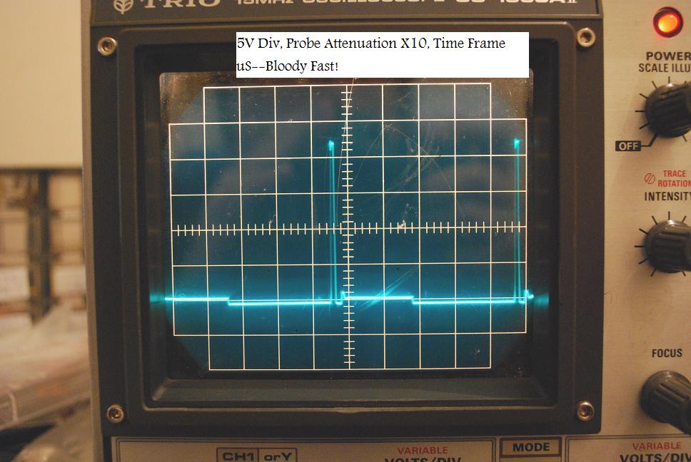

                            I believe if the detector circuit can not create a good magnetic "push" at the Coil then more than likely the field is going to just hum around the coil so to speak & be there as stagnet as an old pair of Underware.
                            If on the other hand the circuit can create a good magnetic push at the coil then of course it's going to punch deeper, i can show this with some tests.
                            I have been just playing around just tonight with a very basic circuit for test purposes only to demonstrate this among other things. To be honest i'm to paranoid to attach screenshots of the main circuit i am building as it is quite revealing & shows a new approach to this detecting business.
                            I'll attach a screenshot of the first run of the basic circuit & the coil Voltage, it needs a few tweeks but it's not so bad actually for the first test & depending on what you want. I need this for a specific reason.
