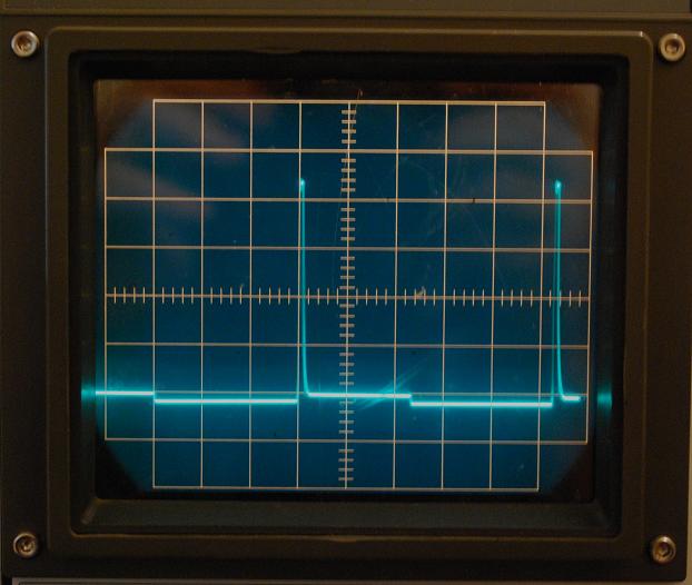

    I was playing around today with that basic circuit i mentioned before & managed to get the flyback under control without a damping resistor near the circuit.
    I'll attach a picture of the coil signal, same settings as the previous picture.

      I'll attach a screenshot of the first run of the basic circuit & the coil Voltage, it needs a few tweeks but it's not so bad actually for the first test & depending on what you want. I need this for a specific reason.

      Thanks for the shots of the scope traces of the pulse from your circuit. I was wondering what the small spike on the lower right side of the big pulse was caused by. No if your not comfortable in showing your circuits to us then I wouldn't do that. Ok thanks for the pics and I hope your work progresses well for you. Good hunting and be safe.

        The spike you mention is actually a Scratch on the O-Scope screen, one day my dog thought it was a good idea to jump up & give me a hand & scratched the plastic screen--bloody thing!
