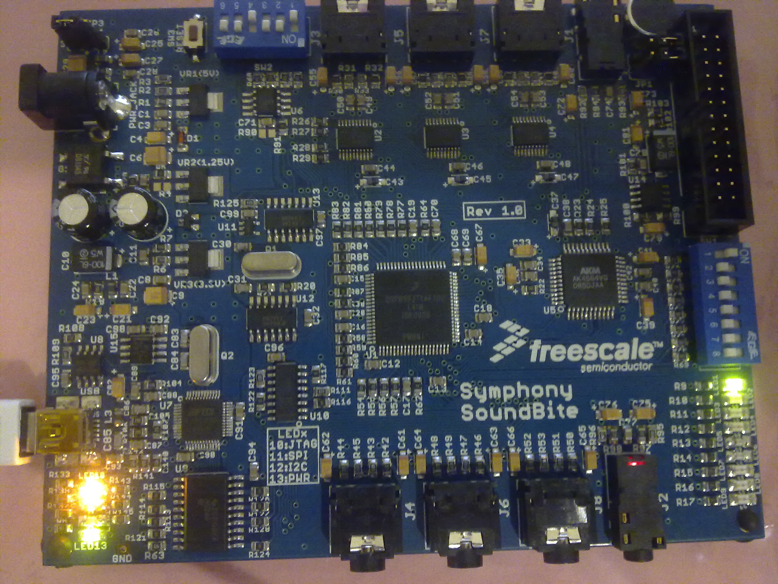

                    ... the board is called a symphony soundbite .... based on a 56K family DSP by freescale semiconductor ( formerly motorola ).
                    SYMSBDEVKITFS.pdf
                    The 56K is a tried and tested DSP platform and the SDK / IDE is free ... eclipse based.
                    They cost $US150 ... quite reasonable .... cheaper than a similiar 24 bit sound card that is not user programmable and more channels and gp IO to boot.
                    If it doesn't work out ... it will make a good real time music processor for guitar etc.

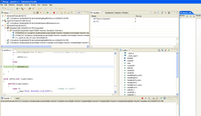

                        Well I got the board .... quite nice .... however I would not recommend it unless you really like assembly language programming. Which I can do ... but takes longer to debug.
                        moodz.
                          well .. the board has arrived ( actually 2 of them ) !
                          Eight channels ( thats eight in AND eight out folks ) of 24 bit 200ksps goodness at 180 MIPS.
                          FFT in 40 bytes of memory space ... hows that for efficiency !
                          I was not completely right about coding everything in assembler ... The C compiler took me some time to get going but it runs nice now .... see screen shot below of single stepping the source code running live on the board whilst having access to register contents and mem variables and can even edit and recompile on fly.
                          This board could be the engine of software driven MD's.
                          moodz.

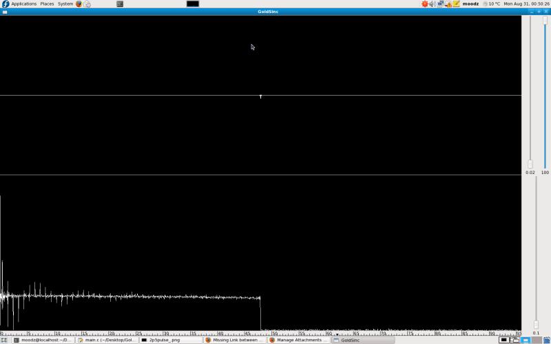

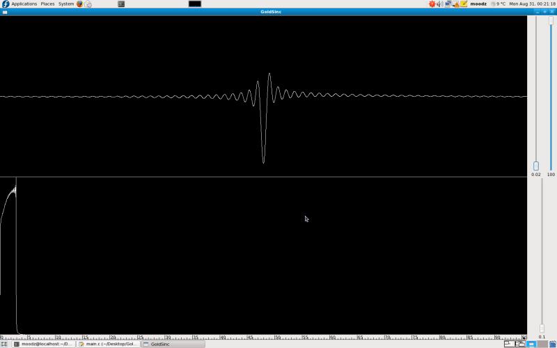

                              next generation descriminating pulse detector DPS5000
                              ... slaving away over a hot computer ... work continues on the next gen dps5000 metal detector.
                              An IB coil system has a TX pulse signal that is ouput by a DAC driven by the DSP software to a 65 watt pulse amplifier. The RX coil feeds a balanced receiver and is amplified and fed to the ADC which pumps data to the DSP. Digital ALC and lockin is applied to the data. The bandwidth here is only 5 kHz. There are 4096 amplitude / phase analysis points .
                              Took me a while to get that code workin ..haven't touched it since I last posted and forgot what some of it did.
                              The top half of the screen is the T domain of the rx pulse. The bottom half is the F domain of the rx pulse.
                              Here is a a screen shot
                              and with the DigALC applied. The lockin works to amazing small pulse amplitudes ... like -60 db The pulse is centred by the lockin. Note there is some increase in noise due to the digital 'amplification'.
                              moodz

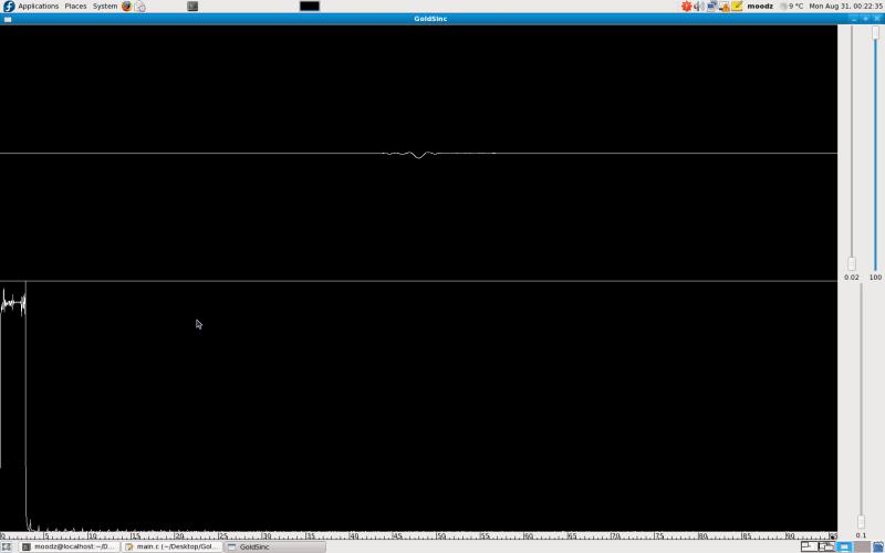

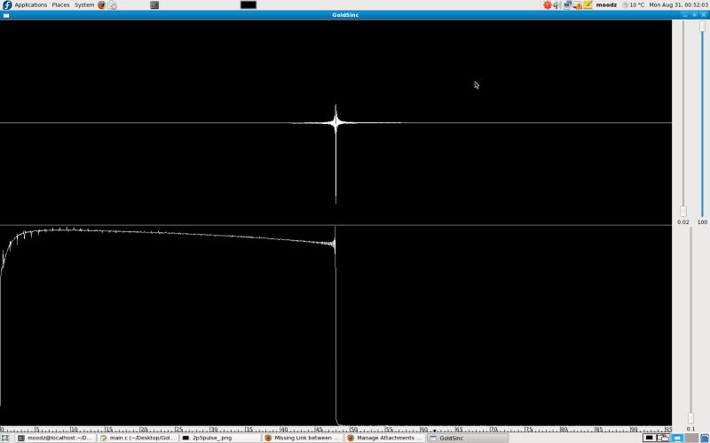

                                DSP5000 cranking it out at 48 Khz
                                The joys of DSP ... no soldering irons required.
                                Enter a new F domain bandwidth and we have 48 Khz pulses with the same ALC and Lockin performance .... now we are pickin up the really small nuggets.
                                and small signal targets.
                                moodz
