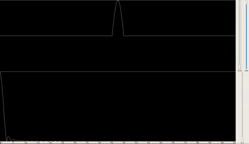

                half sine compared to sinc
                Hi Carl ... I coded a new function call into my reference system called halfsine ... now I am violating the patent ! It generates a half sine pulse or multi thereof .... Everything is the same on my reference system except I am generating half sine pulses.
                The screenshots are taken from the recieve hardware.
                The screenshot below shows in the top half the time domain pulse as emitted by the DAC and the frequency spectrum in the lower half. The DSP guys out there will notice that the frequency domain characteristic is sinc ... so the halfsine does have an underlying sinc characteristic ... unfortunately it is in the wrong domain .

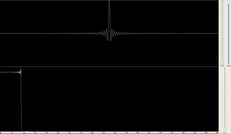

                now have a look at the sinc pulse ... only running to 10 Khz BW here. The time domain has a sinc characteristic ... top half of screenshot ... the frequency domain .. lower half has a rectangular pulse characteristic ... and if you are wondering ... yeh ringing still occurs even in frequency domain. There are 2048 frequency slots in that spectrum ... all of ( nearly ) equal amplitude and known phase. ... ie 2048 parallel virtual detectors.

                    What are your thoughts on frequency-domain processing? BTW, the f-d ringing is an artifact of your finite DFT.

                      Hi Carl,
                      well ... I could write maybe a small book on that ... I will list some points and if anyone wants to expand we can discuss it.
                      1. The electronics is arguably alot more simple. Basically your coil ( IB or single ) a Transmit amplifier , Receive amplifier and DSP / operator interface block.
                      2. Because all the processing is done in the DSP there are a number of benefits here ...
                      - technically the signal to noise ..... and I mean that both practically and subjectively ...
                      ... I dont just grab the signal off the receive amp and dft it ...it first hits a digital lockin amplifier / synchronous demod implemented in DSP that recovers the pulse from the amplified signal fed to the ADC. It can recover a pulse from below / at the noise floor. Factor in the gain of the coil amp and the further processing gain when the pulse is factored to the frequency domain and you are streets ahead of time domain techniques.
                      3 Adaptive equalisation or compensation of the external electronics, fancy low noise amps help but to a large degree the processing gain of the DSP compensates for middle of the road components phase / freq /amplitude compensation, environmental adjustment, snazzy user interfaces. No need to factory align .. the software does it on a continuous basis.
                      4 commercial benefits / author copyright / recognition ... the hardware cost is not too significant but the consumer pays for the level of software in the machine ... DRM anyone ? ... there I said it .. aaaargh .... wash mouth out with soap.
                      5 detector upgrade / maintenance is obviously alot easier with a firmware load.
                      6. Nothing I have said above is ground breaking .... what needs to be factored in here is an improved method of creating a magnetic pulse that influences a target in the presence of unwanted influences and by processing the received signal the wanted influence can be separated optimally from the unwanted influence.
                      What I am saying is that for a given bandwidth the sinc pulse is the most spectrally efficient pulse you can use since it presents the target with the optimal range of amplitude, frequency and phase controlled spectral energy which if the target interacts with even a single spectral component will be detectable. Of course most targets will interact with more than one component.... hmmm because of the number of analysis points involved the software is looking for 'signatures' .... ie combinations of changes in the signal. This is done .. no offence ... crudely in time domain ... eg ground balance with multipoint sampling. You will notice that I have emphasized the method of generating, receiving and benefits of the sinc pulse ... but not the methods that would be further employed to provide descrimination, ground balance etc and this is because there are either well known methods as employed in VLF etc and / or patents that already exist ( ML or Whites again ? ) that relate to these analysis methods and so these would be well known to those skilled in the art so to speak.
