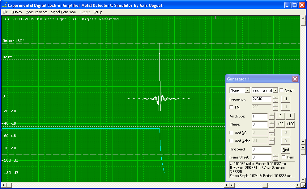

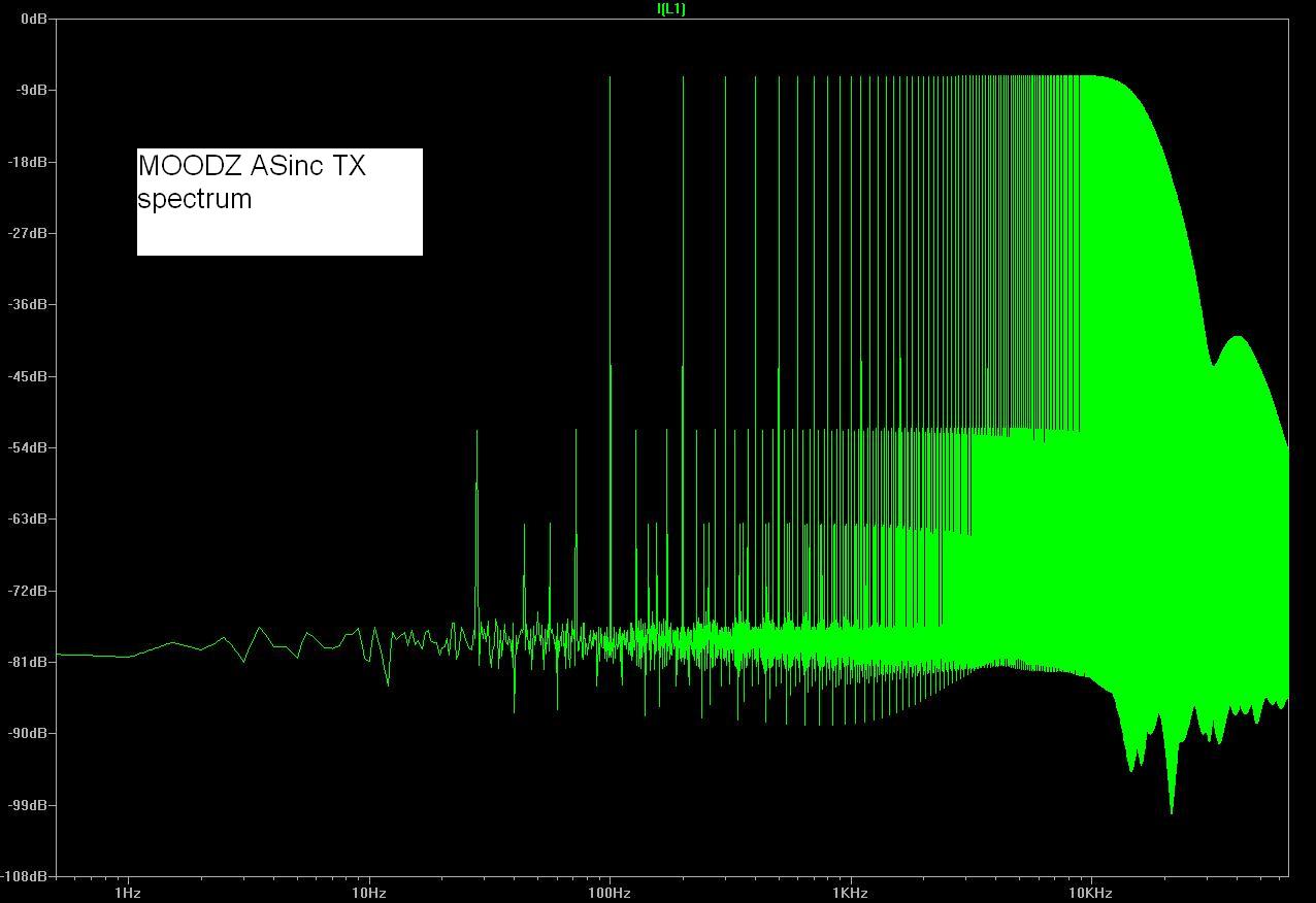

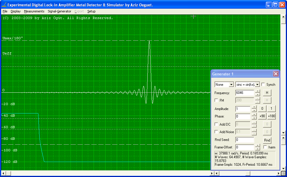

Hi all,
the software is extended for sinc burst's now. I made a quick test to drive the coil with ultra low power using the stereo output line of the sound card. Result: The transmit output power is not big enough to give satisfactory results so I have to use a high power amplifier next time.
Below is the time domain signal and frequency domain response (power spectral density) of different transmit sinc burst's with different frequency limits. Can you see the brick-wall rolloff of the power spectral density?
