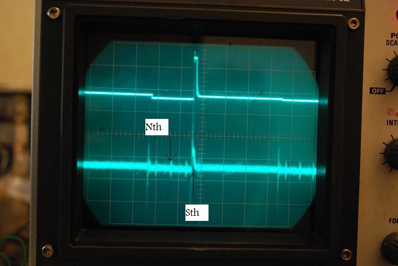

          I have added a picture of the polarity changes from some TX pulses taken from a Hall device. The picture has some bad noise from the Hall device, something affects the readings at night around here pretty bad.
          More than likely the house is on a big mineral deposit.
          In the Picture the bottom trace is from the hall device, Nth Polarity is the Bottom of the Picture Sth is Top.
          You will see the slight Nth going magnetic field of the switch on then a good south going pulse but then it settles back to the Zero Datum line & doesn't really go of Nth Polarity again.
          See what you think.

              B^C,
              I look at your scope screen and only see the voltage on the top trace and a bad repeat on the bottom trace.
              Look at the current trace, not the voltage trace.
              As you know, it is the current that produces the magnetic field.
              In which direction does the current move in the AC mains?
              You can visualize the PI cycle as a distorted sine wave, it goes down, then up, then down again.
              Tinkerer

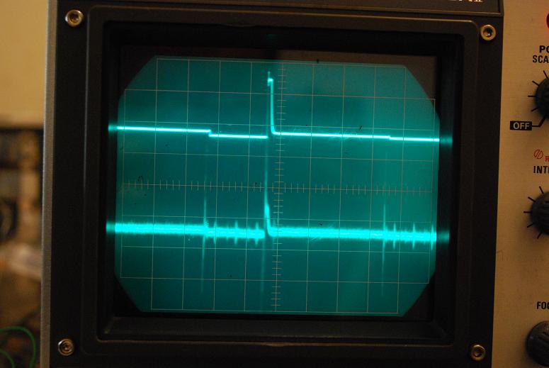

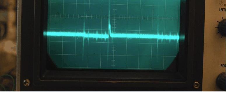

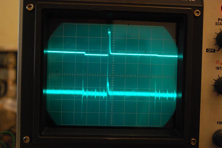

                Tinkerer,
                Sorry about the picture, not sure what happens there?
                I have re attached it & just the bottom half --the Hall device signal incase it doesn't attach correctly again, i hope it comes through, it clearly shows the magnetic field.
                  I was just having a brain strain about this demagnetising, isn't this exactly what we are doing anyway.
                  Eg:
                  If our first TX Pulse is say of Nth Polarity & then the switch off creates a Sth Polarity, this Sth Polarity pulse would seem to be the Demagnetizing pulse?
                  The strength & duration of this Sth going pulse would seem to be an important issue.
                  If it is to weak or to strong or to short or to long in duration it would have not enough or to much of an effect, but if the field strength & duration of this Sth polarity pulse is perfected we could infact make it so it just demagnetizes the soil matrix leaving only the target signal to read.
                  Maybe!

                      Hi B^C,
                      don't trust the graphics, you have seen anywhere. It is quite misleading.
                      The current direction does not change in the conventional PI and therefore the magnetic field direction does not change too.
                      The coil wants to maintain the same current direction after switch-off and this is done during the damping period.
                      Aziz

                          Hi Aziz,
                          I was under the same opinion, that the current does not change direction but from the Hall Devices i get a clear Nth going polarity with switch on & then the magnetic field reverses to a Sth going polarity on switch off.
                          The Hall devices show what polarity is inducing them & it does appear that there is in fact a reversal of the magnetic field on switch off.
                          If there was no polarity change the hall devices would show just that & the magnetic field would just decay away to zero but they do not show that.
                          They certainly indicate a reversal of the magnetic field, it may not agree with some things but it is there to see.
                          Interesting.
                            B^C,
                            the cables to the hall sensor are inducing voltages. Check this. A twisted pair cabling would minimize this.
                            Aziz
                              I think Aziz is correct that the leads of the Hall effect sensor are picking up unwanted signals.
                              During the switch-on period a magnetic field is established in the coil, and at switch-off the magnetic field collapses. At no time does the coil current reverse. It simply reaches a maximum at switch-on, and rapidly decays at switch-off
                              What you appear to be discussing here is the possibility that certain soil types can become magnetized if pulses of the same polarity are used. To avoid this situation some PI detectors generate pulses of alternate polarity. I don't know whether this has any major benefit in "normal" metal detecting, but I can see that in humanitarian de-mining it could an issue.
