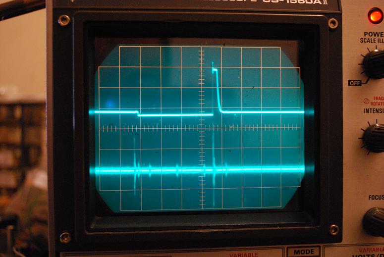

What we are interested in, is the target, that includes the soil.
Visualize the following:
A wire with a very small current flowing in it. It is surrounded by a magnetic field that reaches out a small distance.
Now place a target conductor just at the edge of the magnetic field.
Now increase the current in the wire. The magnetic field expands and the magnetic field lined cut across the target conductor, generating a voltage and eddy currents in the conductor.
Hold the current.
The eddy currents in the target conductor subside, but the target is still surrounded by the magnetic field.
Now switch off the current source. The magnetic field collapses. The magnetic field lines again cut across the target, but in the opposite direction as before. Therefore the eddy currents generated by the collapsing magnetic field are of opposite polarity.
You can easily try to look at the reversal of the polarity if you move a magnet past a coil. Move it in one direction you get one polarity, move it in the opposite direction you get the opposite polarity. forward and back, you get AC.
