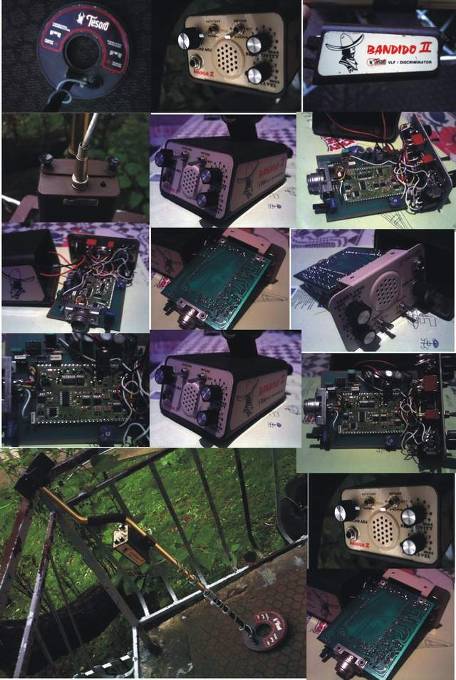

    Finally i got one original Tesoro, just for me!!!
    It is Bandido II (not uMax).
    It is very cute small machine. Extra lightweight! Two 9V batteries connected in parallel - providing more current and last longer.
    Coil 20cm.
    Extra good discrimination! Almost the same as on my TGSL's.
    Frequency exact 10.02 kHz!
    Excellent All Metal mode - static, nonmotion. Excellent! Autotune also works excellent. Manuall GEB works good, but not rejected 10cm ferrite rod totally. It reject it very good, yet very short cracks appears when rod is about 5cm away from coil surface...hmmm..this could lead me to learn to adjust GEB on my TGSL's a bit "softer" in future. Clay,hotrocks and blacksand rejected 100%.
    Very good behavior overall.
    Yet..... air depths are not so great! Same old, famous 1e coin, at same setup on the plastic bench (setup i always use to test all detectors) it is detecting bairly at 23cm in air. Just to remind; TGSL, with 27cm DD coil, same coin, easilly "eating" at 32 to 34cm!
    I tried to keep all adjustments the very same on Bandido II as on my present TGSL. And i just did testings on both at the same time. Very simillar except air depths on 1e coin. So...this Bandido will need new coil very soon!
    Next week or two i intend to perform some more detailed checks, measurements and analyze...

          I just performed some small epxeriments.
          Since i already have Bandido II with original 8" (brown) coil and also i do have one of my TGSL handmades, i decided to exchange coils between those two and perform some measurements. So...
          * TGSL i used in this is last version with BD140 at audio.
          * TGSL coil is already explained 27cm DD coil (my handmade).
          * TGSL with its coil detects 1e coin at 32cm in air, Disc at "4" and Sense to maximum. No chatters, no falses, ferrite rod fully rejected.
          * Bandido II with 8" coil detects same 1e coin at 22-24cm in air. Disc at "4" and Sense at maximum. No chatters, no falses, ferrite rod producing rare short "cracks" (not disturbing and not significant).
          Now...
          Experiment 1.
          With use of 2 extra connectors (suitable) i connected original Brown 8" coil to my TGSL handmade.
          - Residual voltage measured at RX wires from coil (disconnected from detector) is 3.4mV (range AC~ 200mV)
          - Frequency is 14.4kHz
          - 1e coin cleary detected at 24cm in air, under same uniform conditions.
          - Ferrite rod fully rejected, no cracks, no chatters, 100% stabille and calm.
          Experiment 2.
          With use of 2 extra connectors (suitable) i connected my 27cm DD handmade coil to original Bandido II detector.
          - Residual voltage measured at RX wires from coil (disconnected from detector) is 0.0mV (range AC~ 200mV)
          - Frequency is 9.5kHz
          - 1e coin cleary detected at 31cm in air, under same uniform conditions.
          - Ferrite rod CAN NOT BE rejected. GEB trimmer turned fully in both directions, no influence on ferrite rod rejection. Iron is rejected 100%.
          Datas:
          - My 27cm DD coil ; TX=6mH, RX=6.5mH
          - 8" Brown coil ; TX=5.63mH, RX=6.22mH
          I was lazy to open Bandido II and check if there is some extra GEB trimmer inside. First time when i opened it i spotted another trimmer there... Maybe ferrite rod rejection can be achieved if there is another GEB trimmer inside. Will check these days...
          Conclusion;
          IT IS ALL ABOUT COIL!
          8" Brown Tesoro coil is C.C. coil. It's performances are what they are; 22-24cm on 1e coin in air....so..never mind if it was tied to Bandido II or TGSL, performances looks exactly the same.
          27cm DD handmade coil is DD coil. Also it's performaces are what they are; 30-34cm on 1e coin in air....so..never mind if it was tied to TGSL or Bandido II, performances looks exactly the same. Banido II is obviously much deeper and have "stronger" discrimination with this coil.
          Considering sizes and setups of coils...i think both coils are just very good.
          Any other conclusions.....it's yours to establish.
          Cheers!

                Yes i just checked; there is extra 100K GEB trimmer inside the box, on pcb. It need to turn it just 1-2mm in one direction and i got much better situation!
                Now...; Bandido II with my homemade coil is acting almost the same on ferrite rod as it was with it's original coil! Splendid! Ferrite rod now still not rejected totally, but now only rare and short "cracks" on it! Detection...i just checked it again, 32cm on 1e coin! And when rear Threshold control adjusted to maximum...wow! Extra good audio response on coin, in Disc mode! Wow! I am very satisfied! Better response than TGSL! Sharper and more noticeable response!
                Finally...yes, it was all just about the phase. My 27cm coil is obvoiusly balanced a bit different than original 8" and it needed a bit adjusting with inner GEB trimmer to get excellent situation now!
                So... now i can cleary say it is really about coil dimensions and type!
