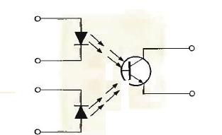

      Use 2 opto ?
      Regards.
      Ap

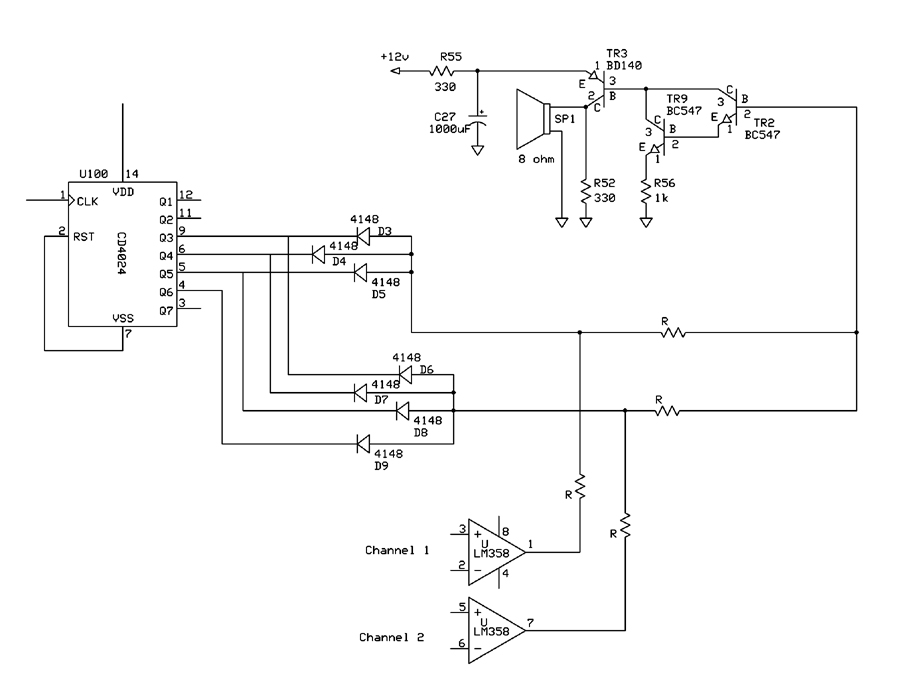

          I'm interested same thing -- maybe using Kurtie TGS layout as starting point and changing notch channels to other use.
          I want to use two different tones and mix into speaker. I think mixing is not hard as Q says -- more interesting problem is getting two separate tones off of 4024 without interfering with each other. Probably not hard for expert, but interesting for me.
          -SB
            multiple audio tones
            Maybe something like this. Resistors adjusted so each channel alone makes half-max volume in speaker. Actually should feed into op amp summer -- this circuit probably not sum well.

                Use 2 opto ?
                Regards.
                Ap
                Eh....that is the same as Qiaozhi suggested. Ok..not same but simillar...
                    Nice. But not what i wanted. I was interested more in using 4046.

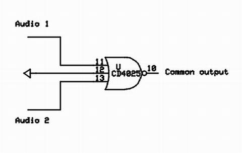

                      To all. I was hoping to hear suggestion like....(de)multiplexer!
                      First thing came to my mind is 4025.
                      But i am not sure about signal levels there! Must be checked.
                      Any experiences?
                            Any experiences?
                            Oooh! More i think about this - looks more as a bad idea to me!
