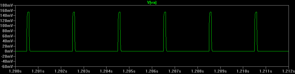

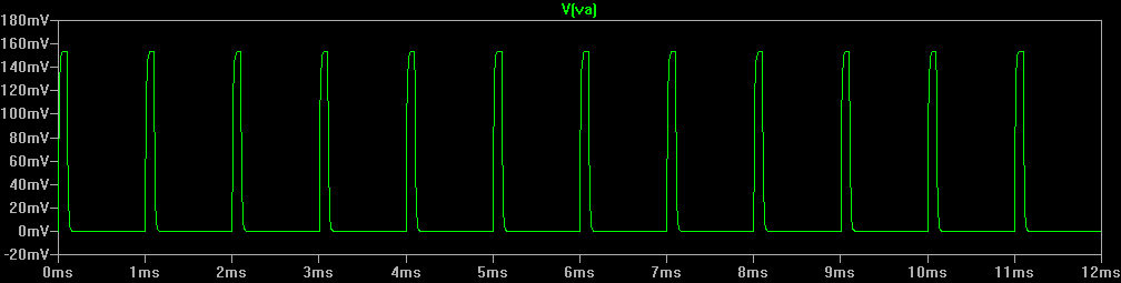

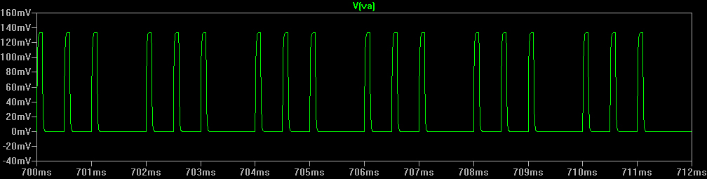

              Simulation with LTSpice to get idea of what non-overlapping pulses of different frequencies sound like.
              One pulse waveform is 1000 pulses / sec. Other is 500 pulses / sec. Waveforms are offset so not overlap.
              Audio contains each sound separately and mixed.

                  Square pulses, like TGSL from CD4024. Filtered slightly by capacitor to round off corners to try to make more realistic. Actual built circuit probably sounds somewhat different.
                  Image 1: 1000 Hz pulses.
                  Image 2: 500 Hz pulses.
                  Image 3: combined pulses.

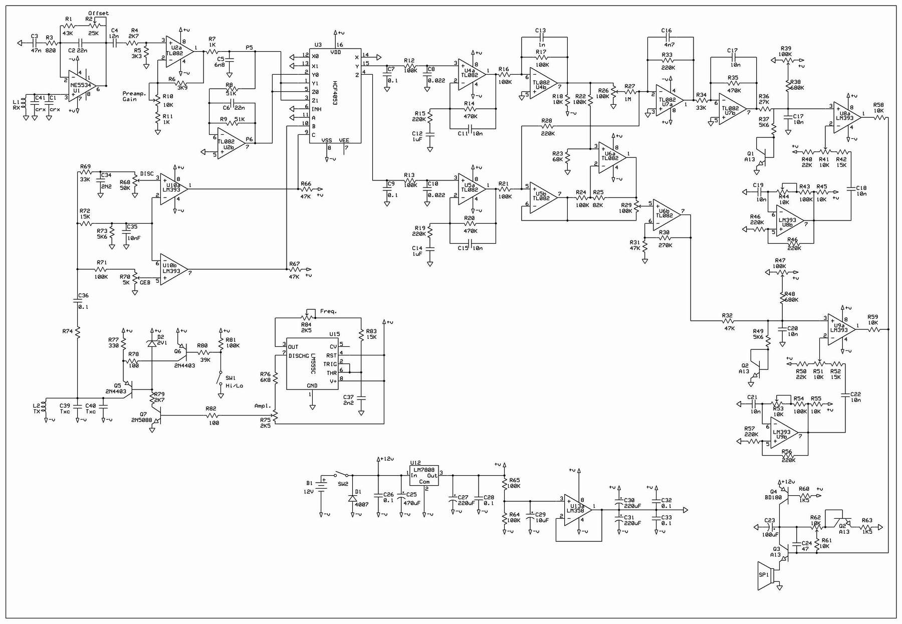

                          I was thinking to experiment a bit with this one. Separate audios from both channels with own presets. Each component of separate audio is adjustable.
                          This schematic is "frankenstein" completed from various projects. Most probably it has some mistakes. But i will make pcb and than solve one by one in process of experimenting.
