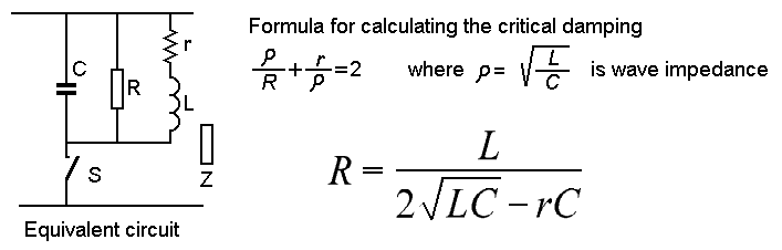

                  In the link, there is one sentence describing the value of the coil damping resistor, that gives me headache:
                  If the resistor has too high a value, there will be some very minor oscillation, and if the resistor is too low in value, the spike voltage will take too much time dropping to the OV range.
                  If the resistor is "too" low in value, shouldn't it actually speed up the spike voltage dropping time?
                          Thanks,
                          Markus
                          The damping coefficient of a parallel RLC circuit is 1/(2RC), so low R results in longer damping. If you remove the damping resistor (R=∞) the PI coil will oscillate, which represents the fastest drop time.

                            Quote: "The damping coefficient of a parallel RLC circuit is 1/(2RC), so low R results in longer damping. If you remove the damping resistor (R=∞) the PI coil will oscillate, which represents the fastest drop time". Carl
                            Carl, you reinveted a special case of Pulse induction named "Sine induction":-). However your network "LC without damping" represents infinitely long drop time; it oscillates continuously :-)
                            The time domain's term "fast drop time" means "wide frequency band" in frequency domain. The "Sine induction" works with narrowest frequency band (about 4 to 16Hz).
                            In 11-17-2009 I published a simplified equivalent circuit diagram of PI TX Network and formula describing its critical damping condition. See the thread
                            Can the inductive time constant formula be applied to coil?
                            The circuit and the formula show that the network has two damping resistances: R and coil's "r".

                              Critical damping of TX Network means that the current through the TX coil stops maximal quickly without ringing. The above formula is valid for this case. In frequency domain this means widest frequency spectrum.
                              Critical damping of RX Network means that the voltage in the input of RX preamp stops maximal quickly without ringing. Above formula is not valid for this case becase the input resistance forms with coil resistance voltage divider.

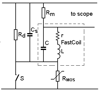

                              FastCoil is a term introduced by J. Rogowski to indicate a condition that allows to shorten Sample delay (the time interval for taking the first sample). For this aim, the coil is made so as to have minimum stray capacitance and suitable low inductance. But this is not enough because the FastCoil is connected to a SlowNetwork having its stray capacitance :-(.
                              The Time domain's term FastNetwork means in Frequency domain wideband network having high upper limit frequency. This alows to wideband metal detector to analyze the range of frequencies that are lower than the networks resonant frequency. To calculate inductance, we need to know total networks stray capacitance and upper limit frequency.
                              The above equivalent circuit represents linear parameters, but at open switch there are in addition: an invisible nonlinear damping resistor, formed by the MOSFET, and an invisible Colpitts oscillator, again formed by the MOSFET.
                              DESCRIPTION
                              The attached below figure is more detailed equivalent circuit of PI TX than in the above figure. This is the SlowNetwork containing a FastCoil :-).
                              The FastCoil's parameters are enclosed in a brocken line rectangle. Added is a low ohm resistor Rm intended to monitor the drain current with the oscilloscope or to restrict the maximal value of the drain current. Added is a non-linear resistor Rz, expressing breakdown (avalanche) voltage of MOSFET, but it can be a real non-linear resistor type VDR or Zener diode for high voltage with aim to reduce the heat of the MOSFET at turn off process. Adding VDR or ZD is unnecessary because the released energy can not cause damage to the MOSFET, but would probably damages a BJT.
