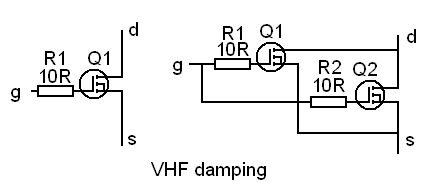

    If you notice excessive heating of the MOSFET, it may be due to the VHF ringing because parasitic capacitances and inductances form Colpitts oscillator circuit . The VHF ringing is difficult to monitor with oscilloscope, but you can hear it with a FM radio. This effect is known to Ham radio designers using class C MOSFET amplifiers. To avoid ringing at turn off process, they connect one 10-20ohm resistor directly in gate lead of MOSFET. When two or more MOSFET are connected in paralel, damp resistor 10ohm must be connected directly to each gate.

          Thank you again for good explanation Carl and Mikebg. This field just turns more interesting day by day. I should have understood this RLC thing from Mikes formula in the other thread but repetition is sometimes needed...
          And how did you know that I was just wondering why paraller mosfet needs separate gate resistor? Well now know that too. Thanks.

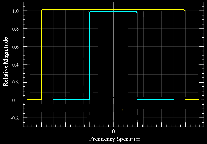

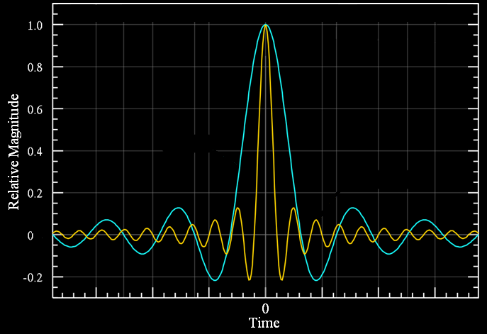

                    What happens with TX current when we increase the Q of TX tank above 0.707 or do the damping d <0,707? In time domain, the TX current gets remittent ringing. In frequency domain, the TX current gets more uniform frequency spectrum. This is like the targets are illumined with white light to distinguish them by color.
                    The more the form of ringing TX current resembles a sinc function pulse, the more uniform is irradiated frequency spectrum. Attached figures show the form of two sinc pulses in time domain and their corresponding frequency spectrum. Note that the more narrow sinc pulse has more wide frequency spectrum and vice versa.
                    What will happen if you illumine targets with a steady spectrum containing all frequencies from audible range of 20Hz to 20KHz? You will hear the voice timbre of each target.You will recognize what is the target of his speech as you can guess who talk without seeing it.

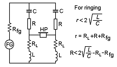

                      Thе method of ringing or insufficient damping is used in one ancient family metal detectors. The attached circuit diagram represents principle of oldest family member - Bridge Balance Metal Detector TIMBRE 1898. It iluminates environment with whole decade ELF radio frequency spectrum 300Hz - 3KHz and even a decade below it. Simply put, this is wide band Audio Spectrum mashine. The operator recognizes the targets in timbre of its sound, as we can recognize by the voice who speaks without seeing it. This is very similar to targets illuminated with white light to identify them by color, but in this case we see with our ears :-).
                      Details of TIMBRE family are posted in section "Commercial Design Group".
                      Let we examine the design of resistors R because L, C and other resistances are given. The RL is coil resistance, the Rfg is output resistance of function generator FG. In the attached figure is derived formula for the calculation of R. In the end of 19th century, capacitors were quite expensive, so the original circuit diagram use only one capacitor instead two capacitors shown.
                      Keep in mind the following design rule for damping a network in time domain: All resistances in the network affect the damping. In the ancient bridge network, all resistors in series with TX coil act as if they increased the value of coil resistance "r".
                      In frequency domain the above design rule is: All resistances in a network affect the bandwidth BW.
                      The formulas for calculation of bandwidth are:
                      BW = f / Q where Q is quality factor,
                      BW = 2.d.f where d is damping coefficient and
                      BW = 1 / (2.p.Ts) where Tc is coil timeconstant L / r.
                      Note that Q = 2.p.f.L / r = 2.p.f.Tc.
                      From the Q formula follows that each coil is characterized by an important design parameter that can be called Tc or Q. The smaller the design parameter, so a smaller, cheaper and lighter is the designed coil. The "Mike's coil" :-) to meet this requirement, but is to analyze its shortcomings. They are very unpleasant.
