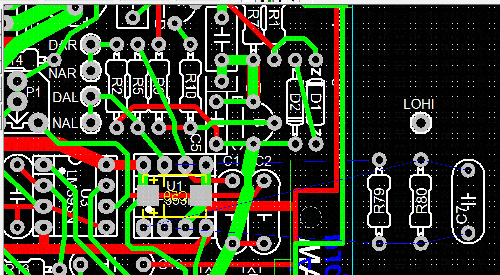

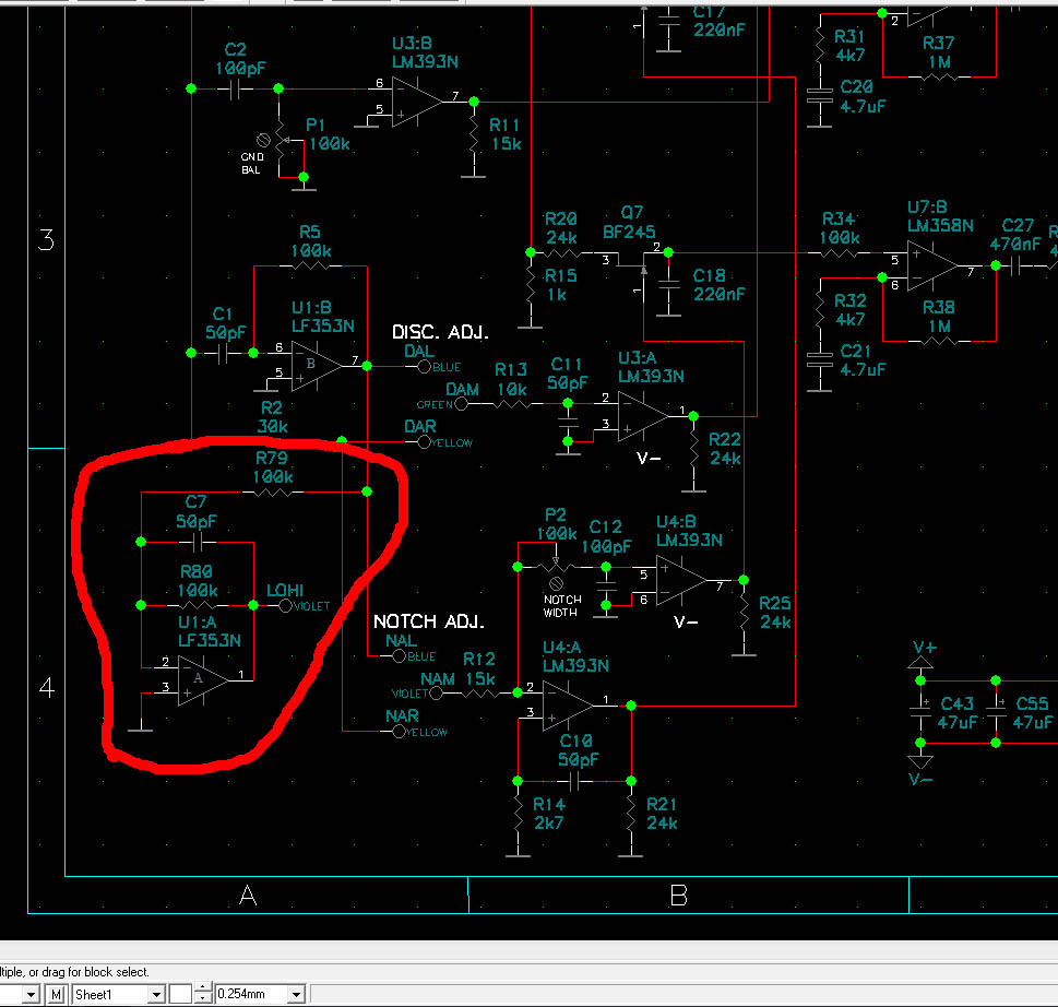

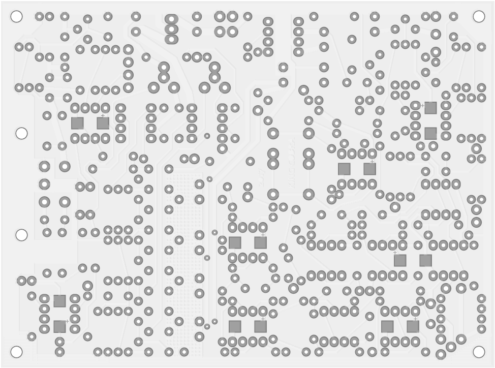

      • guys i am not able to add details for 180 grad discrim specs ((( thats bad thing... no space on pcb...
        so i have to leave all as-is.

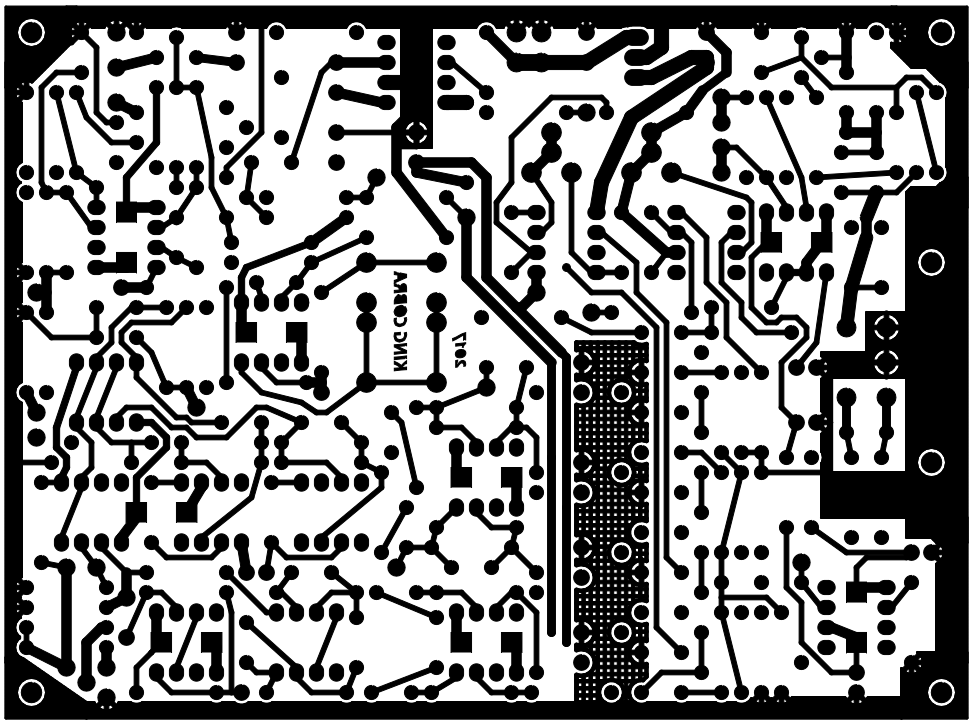

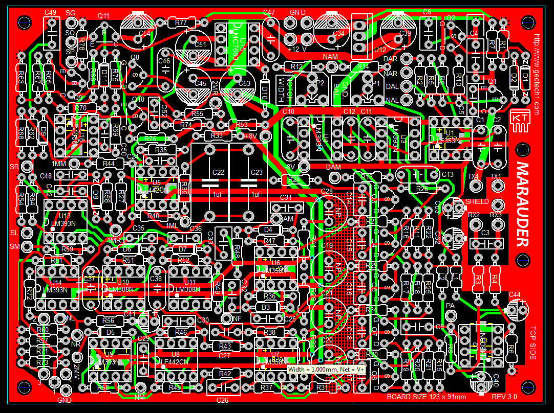

          • suggest what to remake or add?

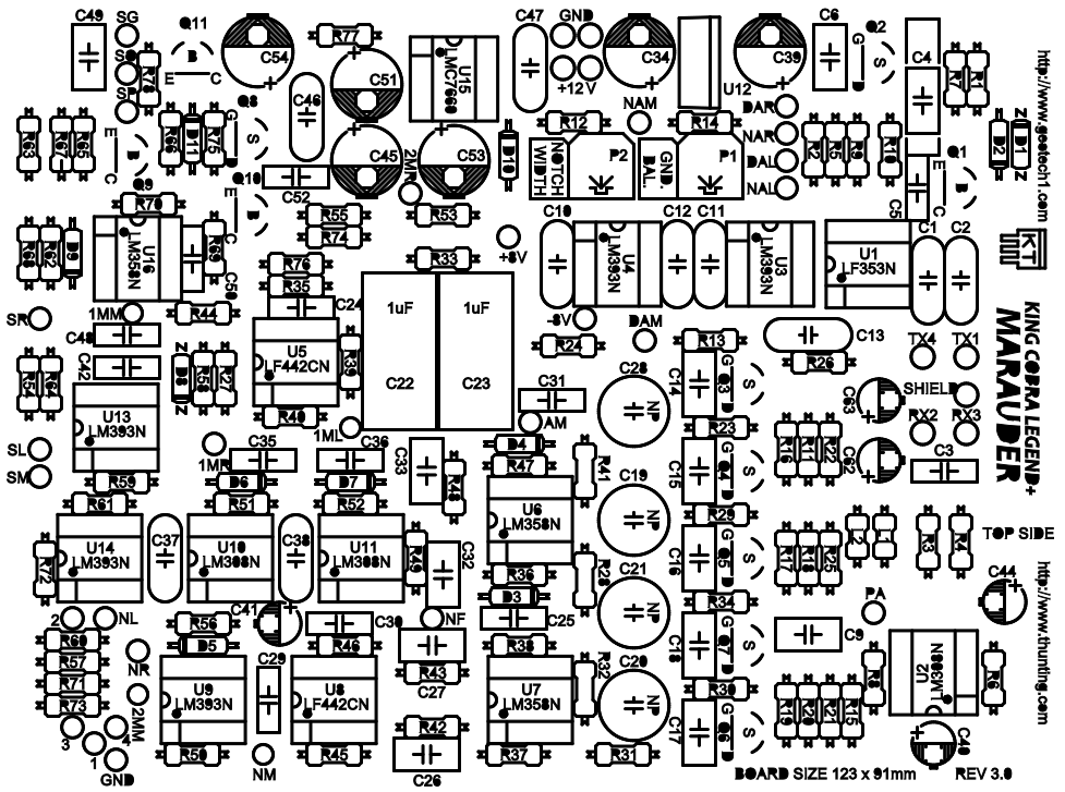

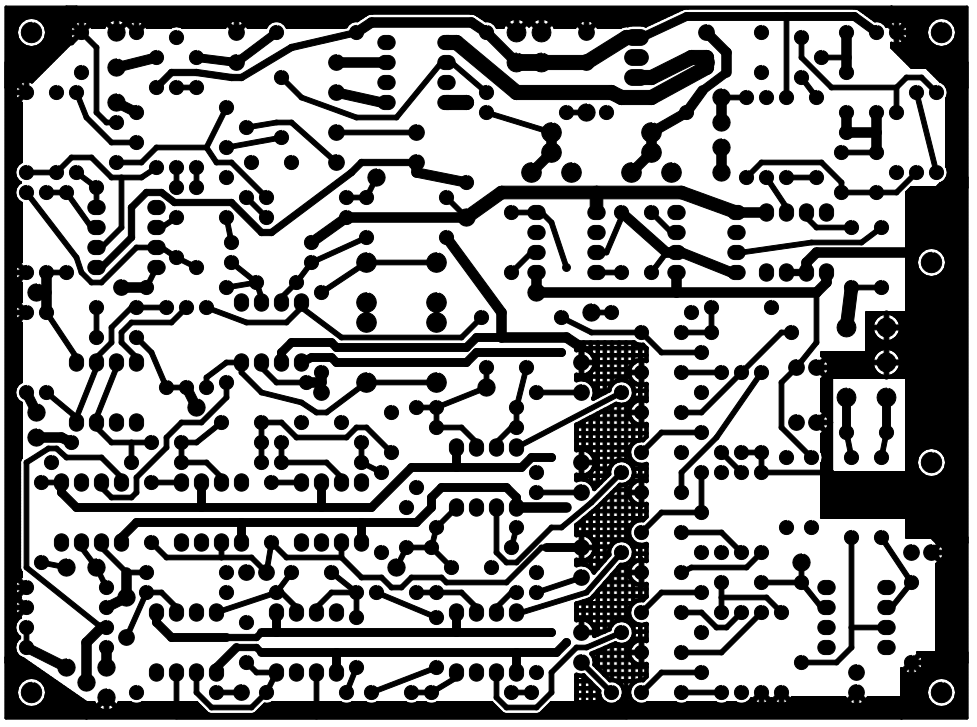

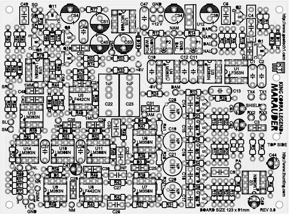

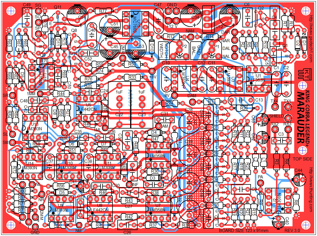

            • job ended

                • How big is the PCB and is there a SMT Version from it?
                  I saw that the depht is quite good. About 50cm for a 1 Euro coin.
                  Can i use the coil from TGSL EDU?
                  • pcb size is silk masked on the top pcb side... 123x91 mm.
                    yes, you can use tesoro design coil just cause GMT is tesoro royal sabre itself. if you look on W Lahr schematic you ll see his Note: see tesoro royal sabre.
                    are you lover to solder smt or you need that more compact?
