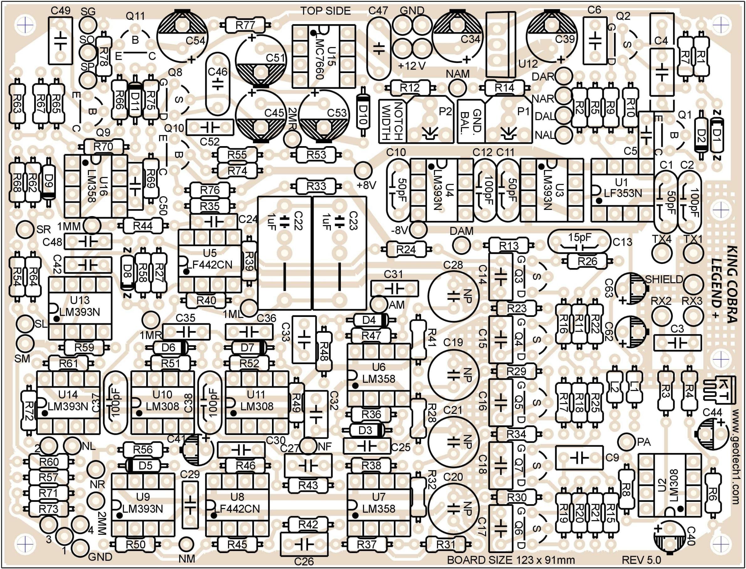

    • top silk layer
      • inductor color code is same like for resistors. their size like 0.125W resistors or 0.075W - both fit the pcb.
        you have to seek them in range 22uH - 81uH. check them by chinese TRANSISTOR TESTER.

            ============================ SMD PARTS =============================
            7343H C43 22-47uF x 20-25V 7343H
            This capacitor is made of tantalum? and can range from 22 to 47uF?. (What I understand) How does this variation affect the work of the detector?
            yup, they are tantalum. 7343 is SMD size type, like you see there 1206, 0805, 0603, etc. So you can set size less, but not more.
            you can set a voltage of tantalums more, but not less. also you can not set them and ignore. that is just my some kinda mod because i take them from trash electronics boards.

            Could you tell me which equivalent components you chose? There are some that are discontinued and others that I suppose would be better than the old ones.
            certainly choice modern op amps you can find around. main rule all chips have to be not fake and have to work. sometimes chineses are selling fakes, that's bad...
