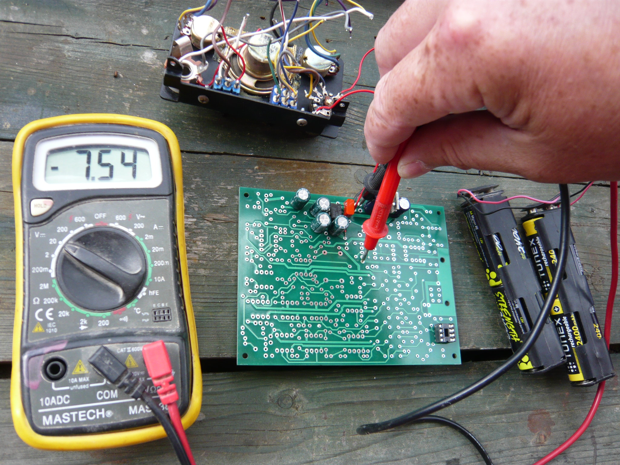

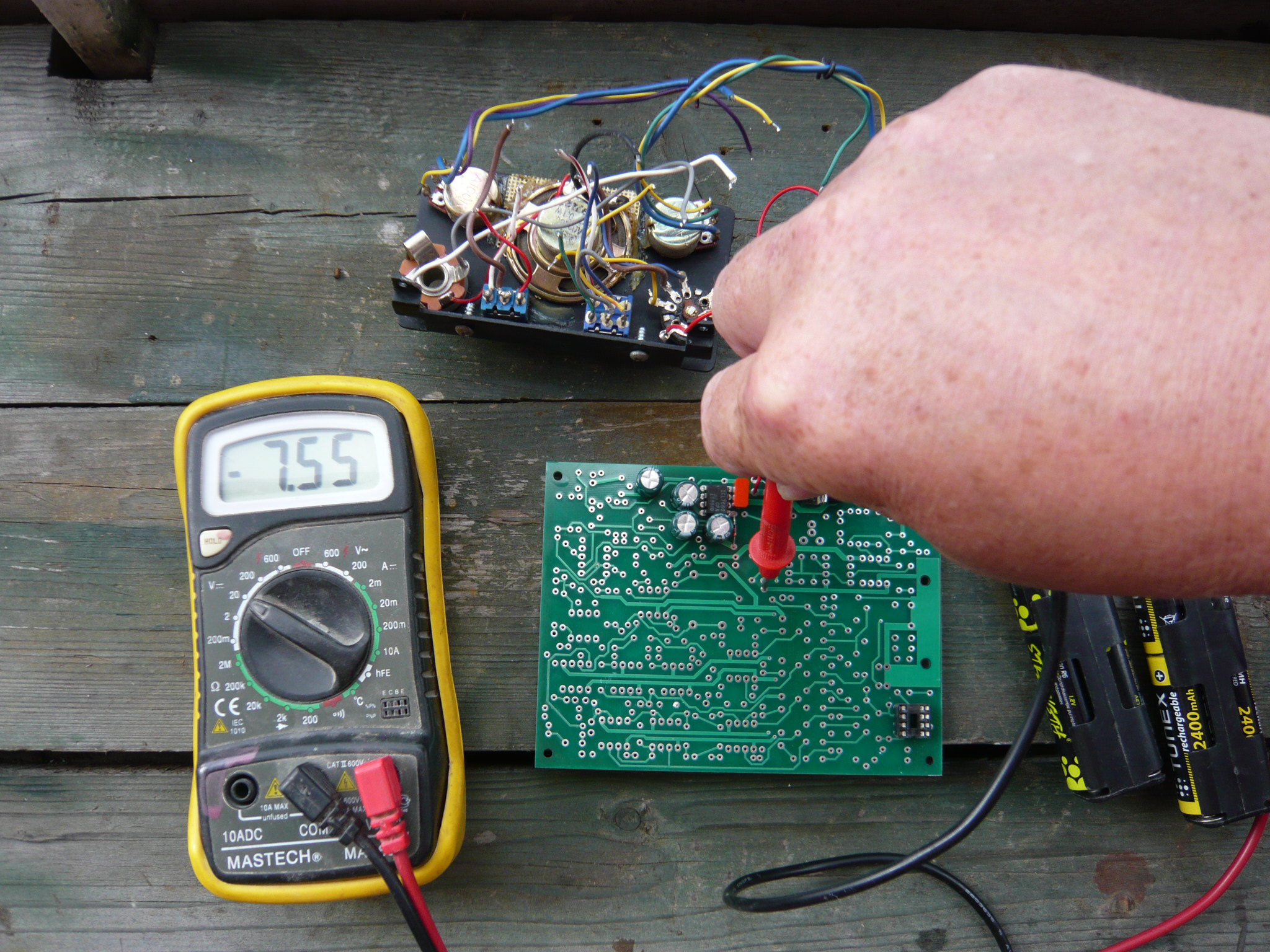

                          • Hi
                            I made a cobra pcb, double sided but not hole platted. I solder components top and bottom. But not work correclty when i swith disc mode some noise come out. If i all switch off the IC9 1 and 7 pins here is 50 Hz square vawe. The negativ power is only -6 V insted -8 V. Some idea what is the problem ?
                            • the IC9 1 and 7 pins here is 50 Hz square vawe --- yes, in conditions of your room with whole electrci lines around
                              you will see 50Hz. and what? this noise does not go via U14-A just cause U13A&B are turn out. follow the logic work
                              of the schematic.
                              The negativ power is only -6 V insted -8 V. -- do not know this is bad or good. must work. I measured and suggested
                              to measure the negative voltage BEFORE while soldering. D10 - then use Zener diode.
ID:	343120Click image for larger version
