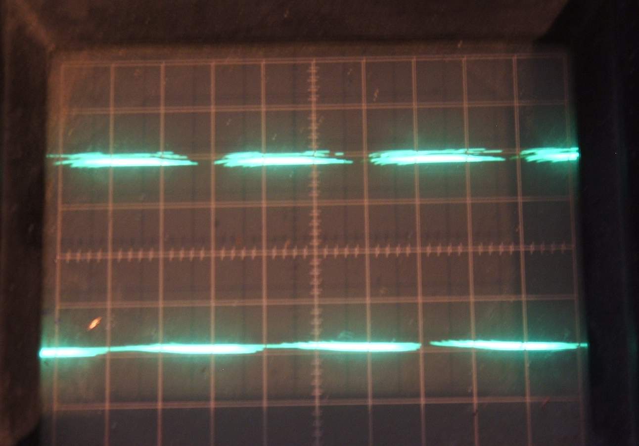

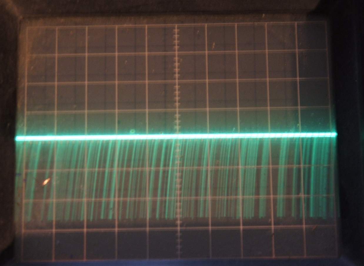

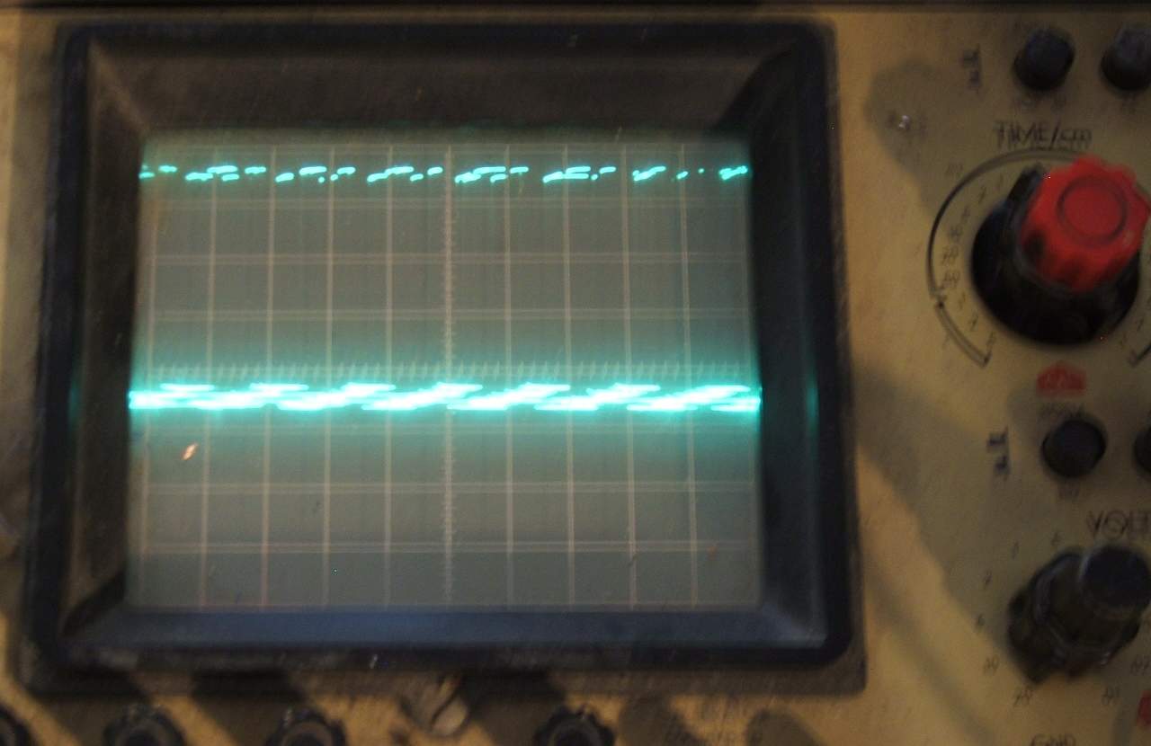

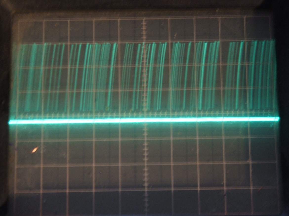

  • Some scope pictures: disc mode
    1. U9 pin 1
    2. U9 pin 7
    3. Q11 base
    4. Q10 base

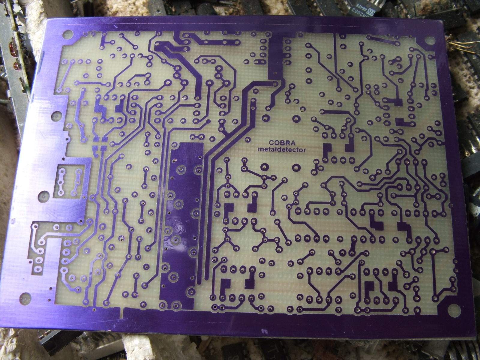

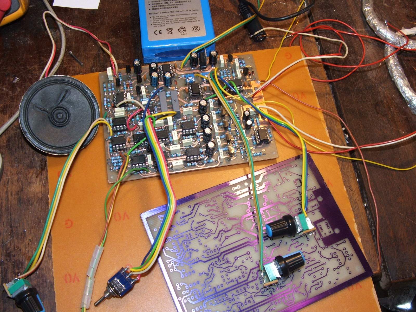

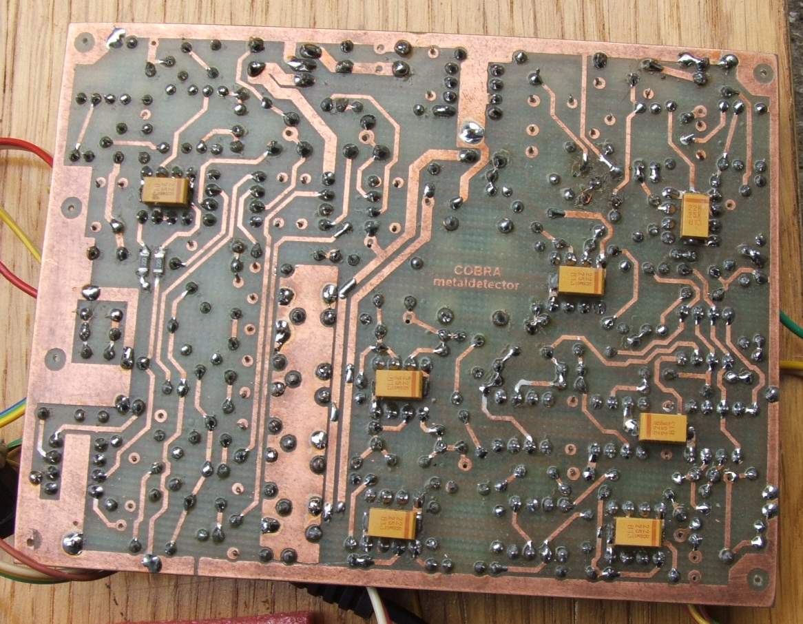

    And a picture, my PCB
    • What freqvency u15 (PowerSupply) pin2 ? 560 Hz ?
      • I found a mistake. The 2N2222 to not use the same pinout p2n2222a. I Use p2n2222a, and fault.

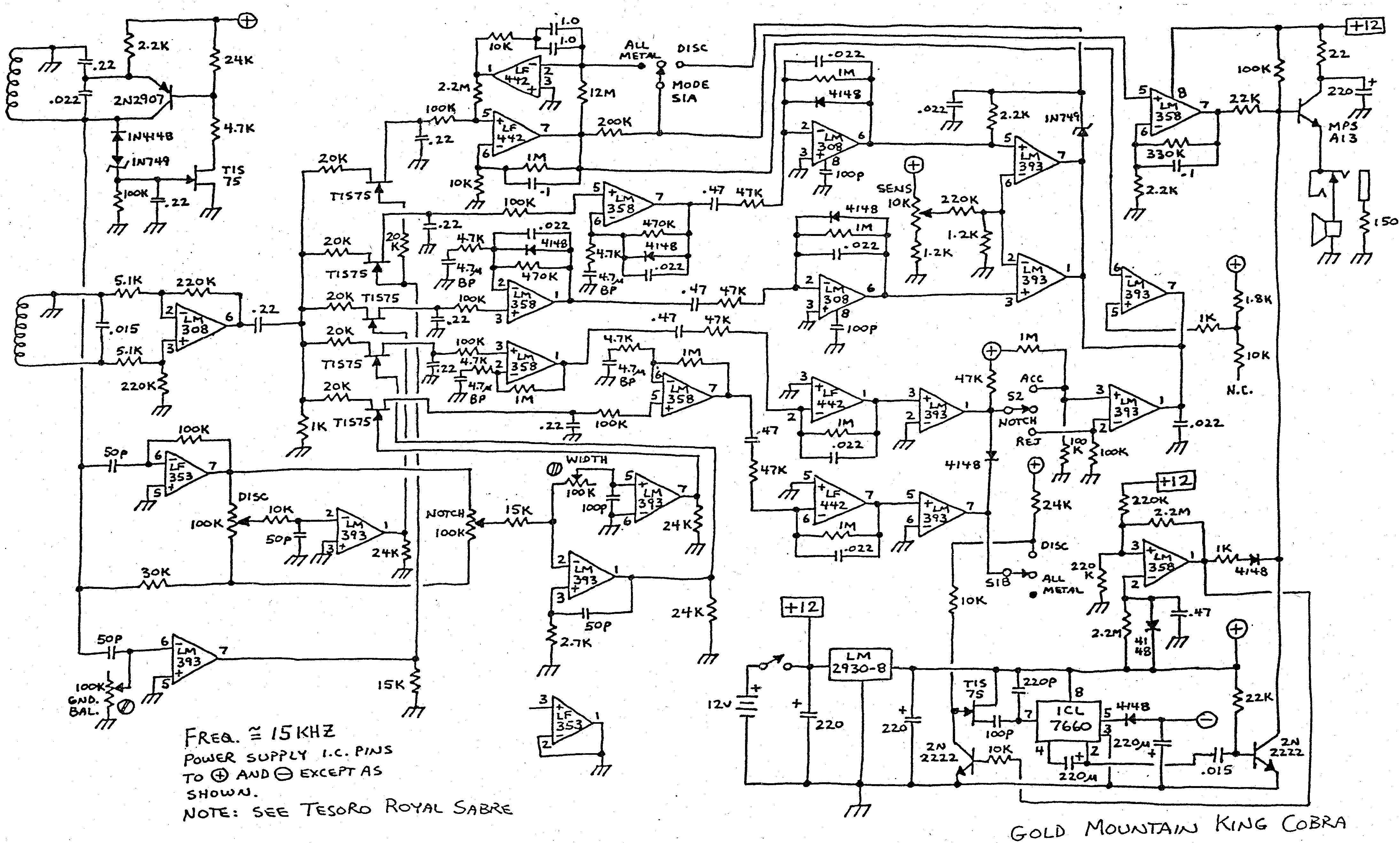

        What is transistor using the original Cobra? Can I use any BC..... transistors. I have yet.
        • yes, certainly, those are ordinary transitors, nothing so specific. BC..... and 2N.... PN... are clear US type manufacturing tr-s
          and you must know more about than me in Lithuania. Lietuva is so tiny state you are not able to find it at a map
          while US is HUGE and cover ALL CONTINENT. Lietuva is some kinda a point from your pen at paper you touch.
          look W. Lahr schematic with ORIGINAL tr-s.

                    you can block the noise like i did. i gave this mod many times. but that is FOR ROOM.
                    for field you have to be back a schematic to original.

                      • Originally posted by mayky View Post
                        can you upload bottom PCB side pic?
                        • Of course
                          • thank you. seems OK. would like to look an orientation of R79 R80, be cause guys did a mistake setting them 180 grad rotated.
                            • That would be a short-circuit.
                              • its simplest noiseless RC filter you can see in much projects. also, some SMD's give the beginners
                                some practic to solder and not fear SMD. in projects I have to orient on lowlevel enthusiasts, not on gurus, just cause
                                them majority.
