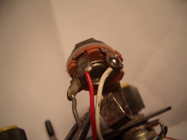

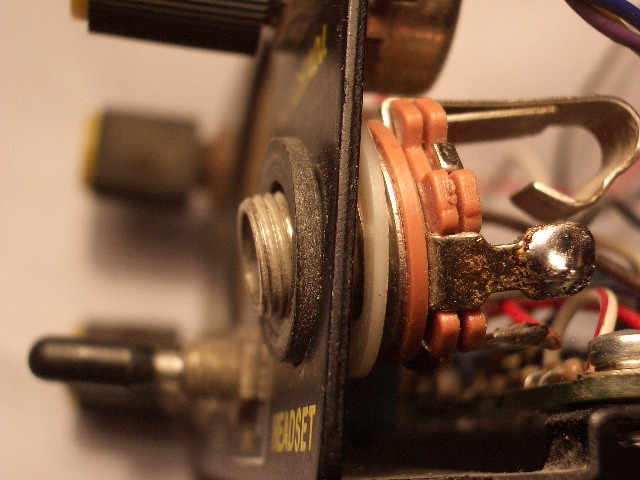

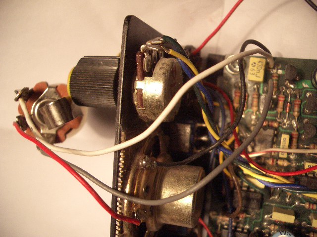

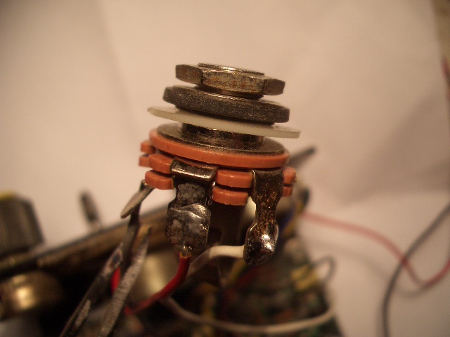

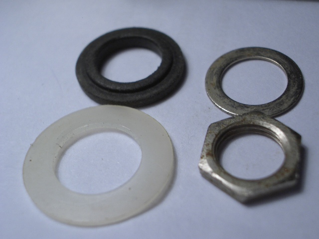

    • about headset connector. there are two isolating beads on the connector - one inside and another outside of the panel. if you use a metal housing you have to remember about the solid isolation of the connector. points of soldering of the connector you can see at photos. this connector is mono,in original.
      regards.

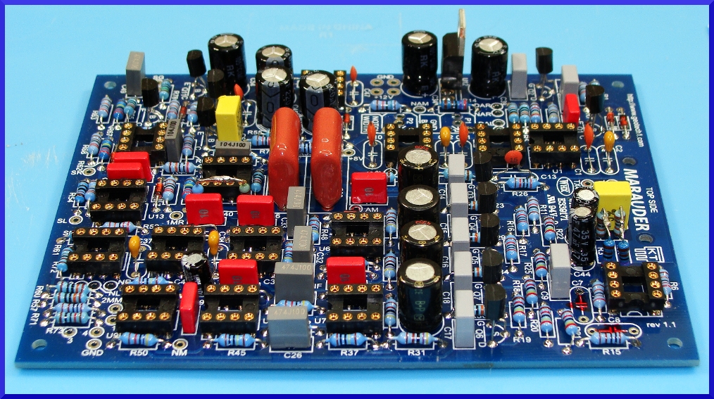

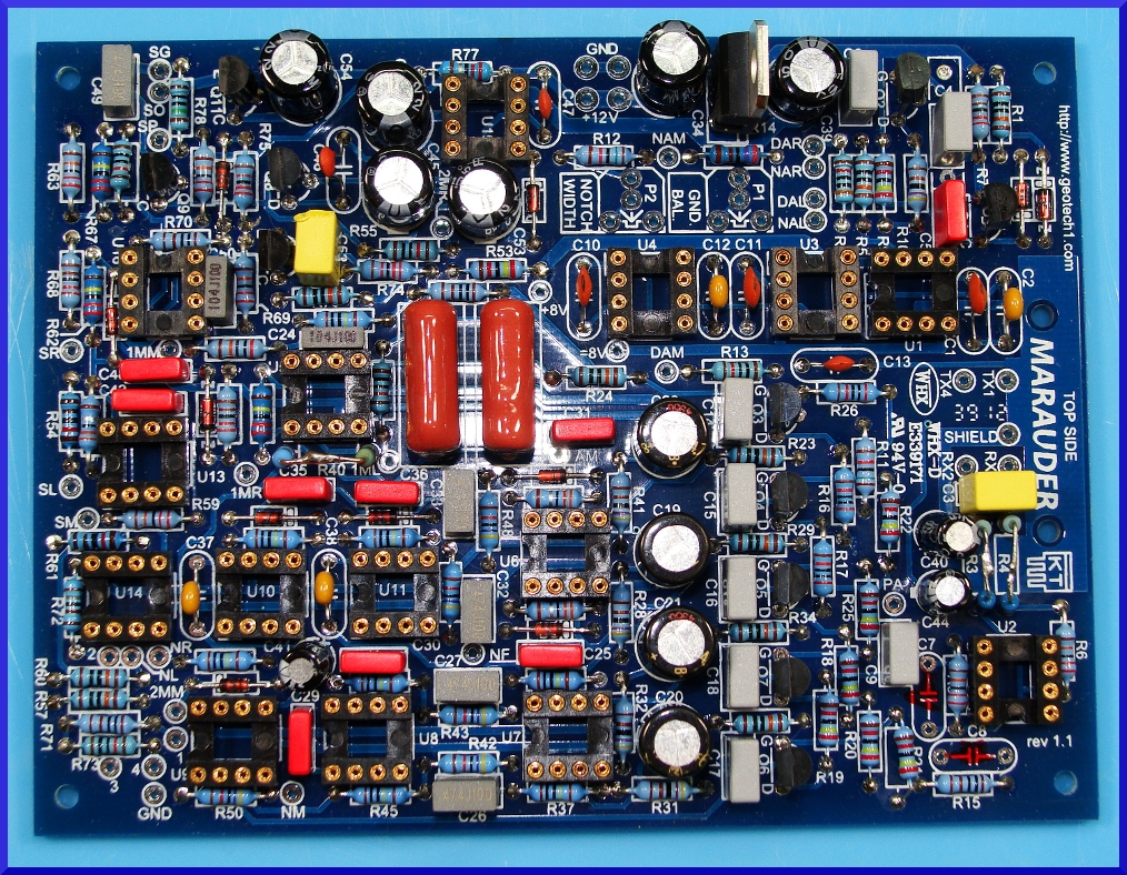

                    • It's a slow go working on the King Cobra since I am spending most of my time building my PI.
                      Just need to get the SMT parts for beneath the board and some IC's to finish up.
                      Thought I would show my efforts, so others building one would as well.
                      • Beautiful board work, inspiring.
                        • nice looking work, Sven... keeping the photos...

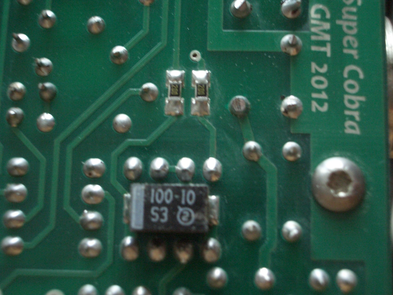

                          • I have access to 22uf 35volt SMD 7343H caps. I can use these for all the 7343h parts?
                            and 22 ohm 1206 resistors
                            • yes, certainly, because 35V more than enough.
                              best regards
                              • you can use 0805 type resistors (L=2mm) too. at a photo are 0805's setting on PCB.
