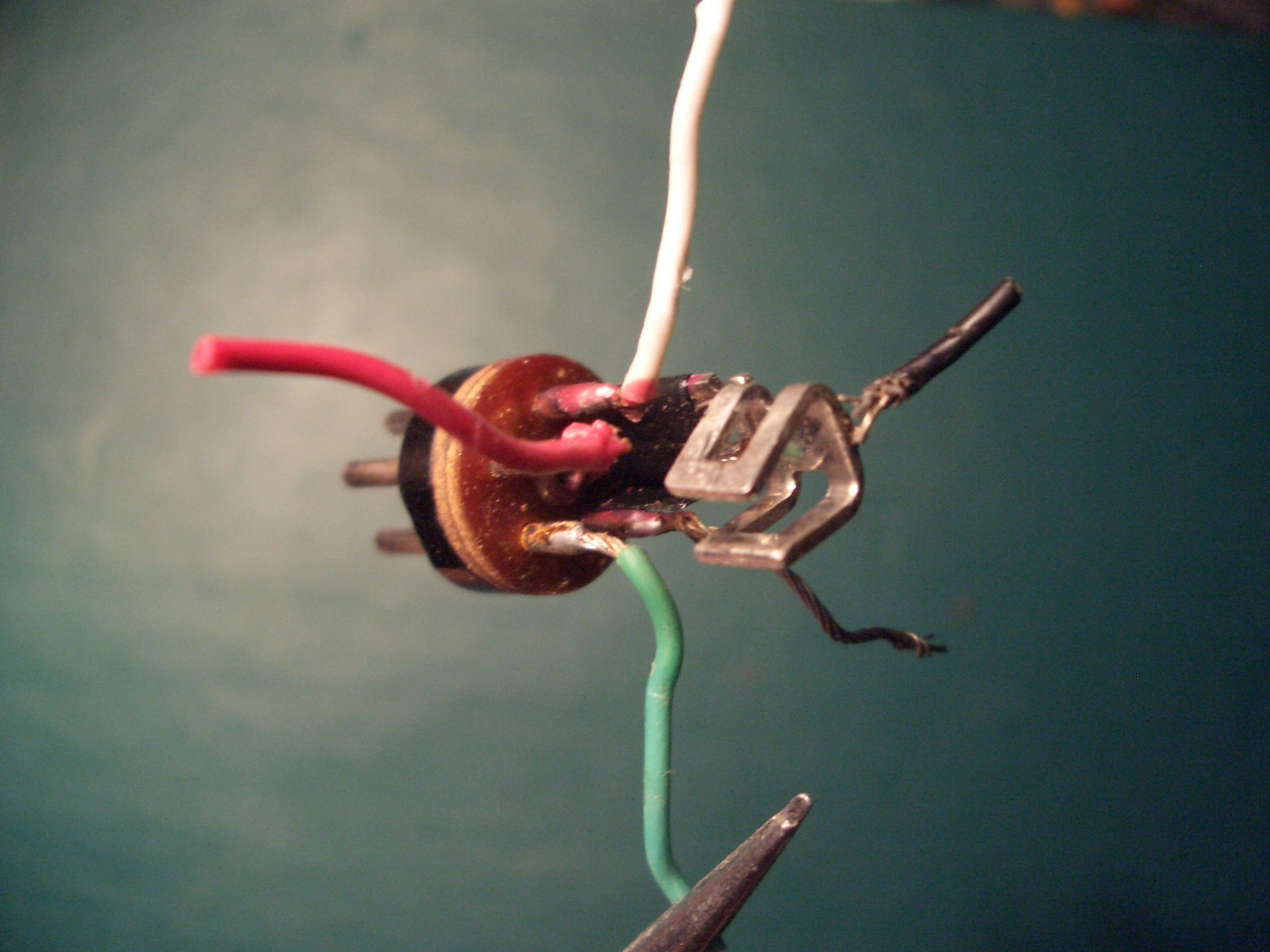

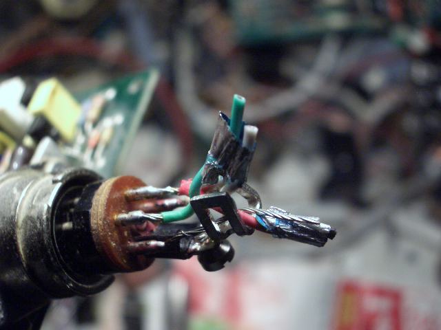

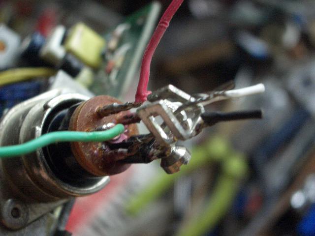

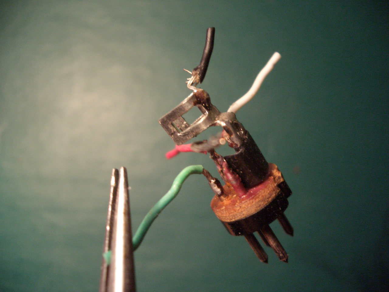

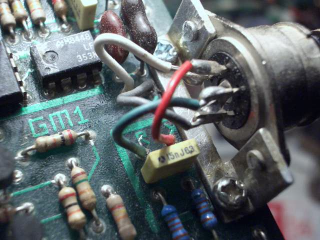

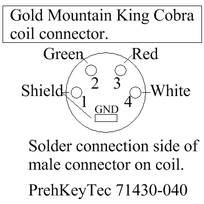

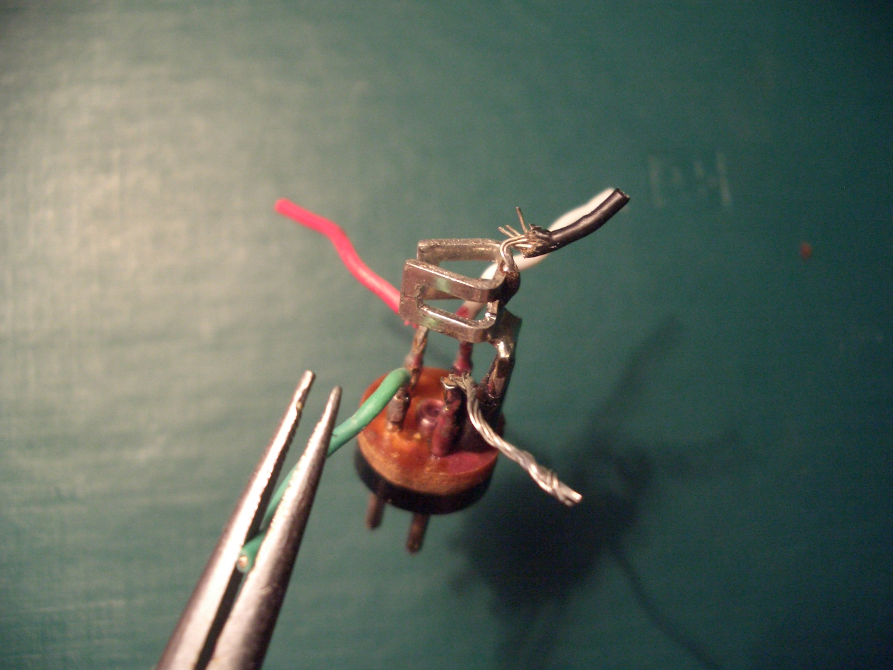

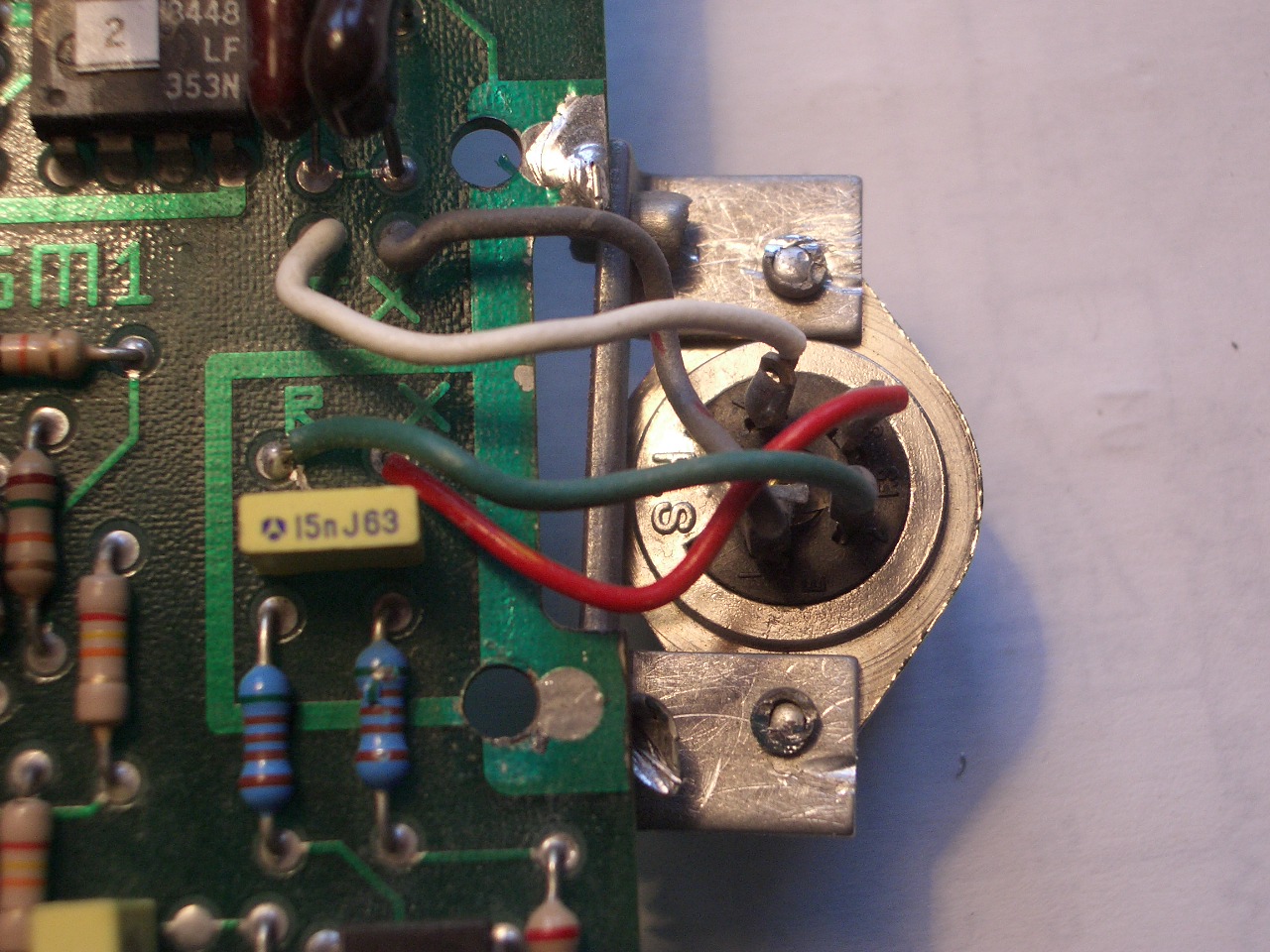

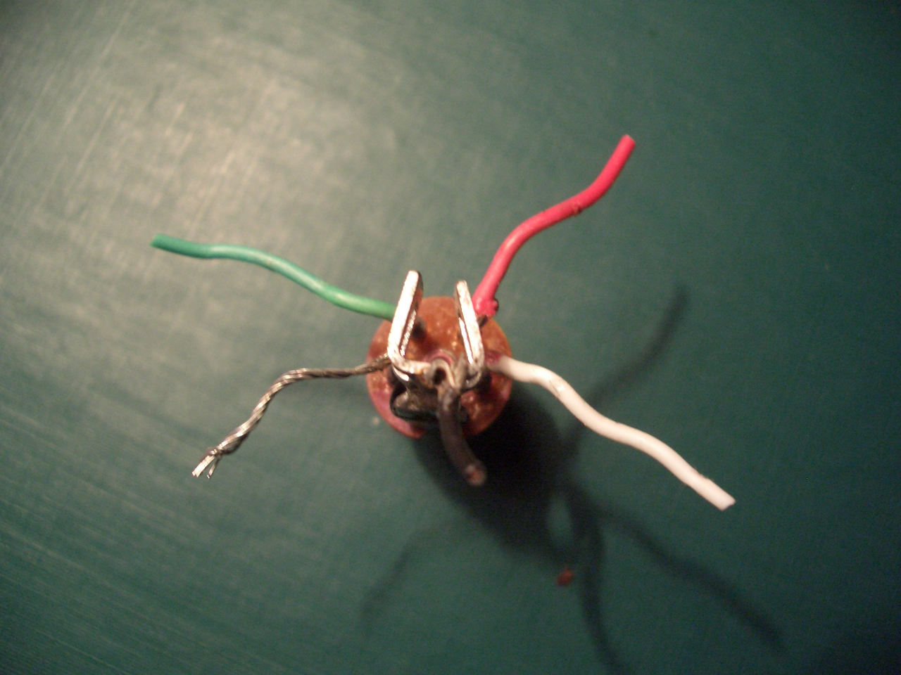

          • original Cobra coil connector wires in photos.

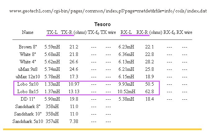

                      • what size of the wire is suitable for king cobra coil ?
                        • Tesoro coil will fit..but wich one ? i see sabre will fit ?

                            do you need PDFs files on TGSL coil making? I can repeat them here, in this thread. it is not a problem for me...
                              Tesoro concentric
                              Tx 1,5 5.7mH 22 ohms
                              Rx 3,4 6.2mH 22 ohms
                              Tesoro early Lobo DD
                              Tx 2,4 10mH 55 ohms
                              Rx 1,3 1.35mH 12 ohms
                              Tesoro
                              Name TX-L TX-R (ohms) TX-fo TX wire RX-L RX-R (ohms) RX-fo RX wire
                              ________________________________________
                              Brown 8" 5.59mH 21.2 --- --- 6.23mH 22.1 ---
                              Lobo 5x10 9.93mH 50.5 --- --- 1.33mH 10.97 --- ---
                              Lobo 8x15 10.52mH 62.8 --- --- 1.37mH 13.13 ---
                              Troy Shadow
                              X2 S-9 9" 5.72mH 23.6 --- --- 6.25mH 25.2 --- ---
                              X5 7" 1.067mH 4.33 --- --- 6.53mH 32.2 --- ---
                              X5 9" 1.044mH 4.45 --- --- 6.50mH 32.7 ---
                              X5 1.1mH / selfrez = 255kHz 6.5mH / selfrez = 87kHz
                              • Coil Parameters
                                KT315, I believe that your Lobo coil information is backwards. What you wrote does agree with the original data that was posted (link below), but that data has since been revised.
                                Coil Parameters
                                There has been a good bit of controversy concerning the Lobo, so if I'm wrong, please somebody come across with some first hand information. Lots of people seem to have a clone, but nobody has the real thing (or else they're not speaking up).
