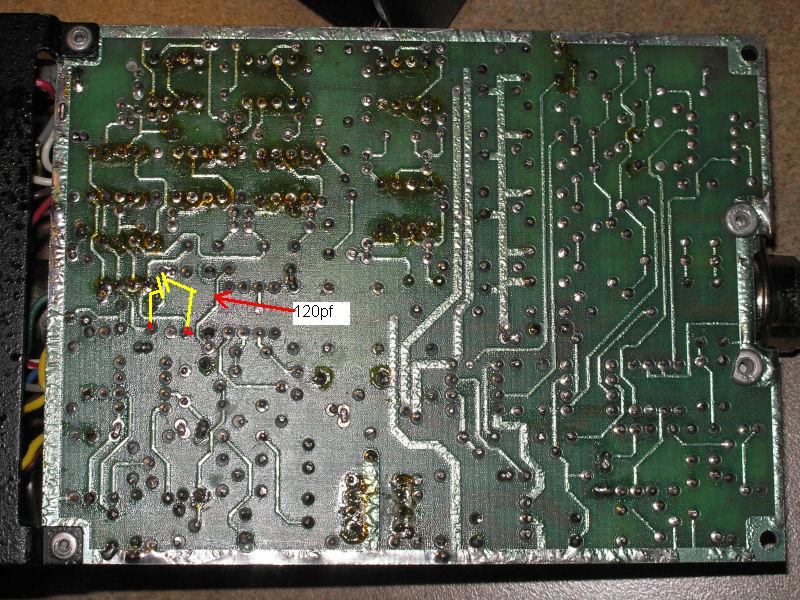

    On my GM Cobra the cap is 15pf. The trim pots are both 100K. There is 120pf capacitor
    on the back side of pcb, see photo
    • thanks Altra! 120pf does nothing. I have learned this a time ago. you can look all tesoro and whites schematics and do not notice a capacitor on the comparator.
