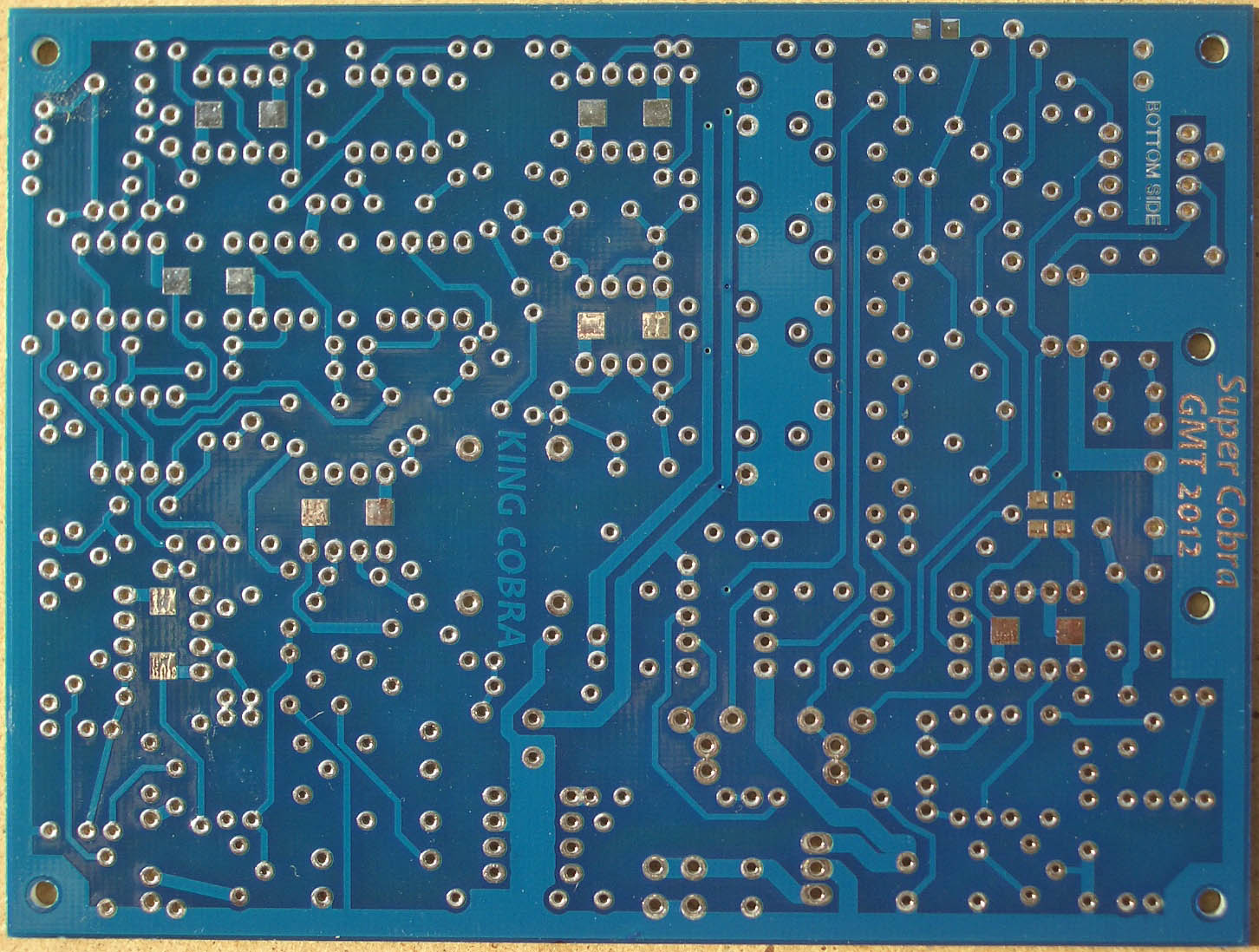

King Cobra PCB
GERBER1?
I could say all this right, you double-compressed PDF so it would be easier to print but not if it's okay if I would say okay.
PDF is the gerber King Cobra ..: Ceño fruncido:gerber1.pdfgerber1.pdf

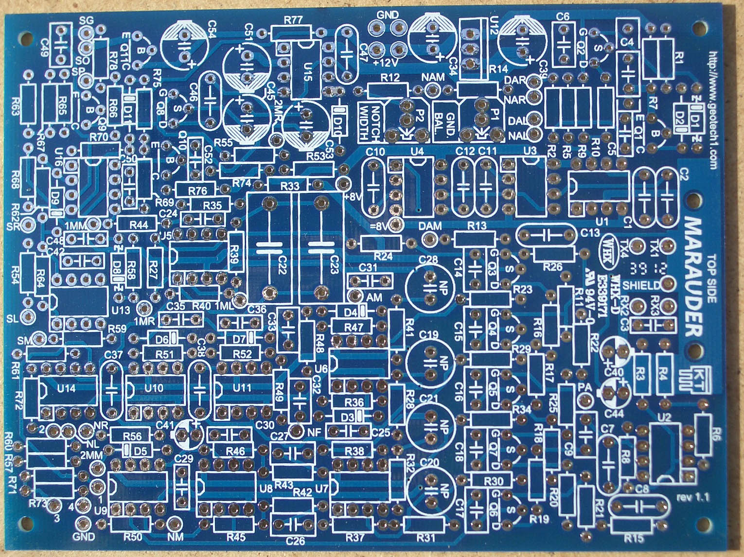

sabios;190457]check the diagram and C41dice is 47uf and the list is 220 uf 10v this is correct?
this cap is bypass capacitor (decoupling cap), NO big differency what you will stay. in range 47-220uF all will be OK. I stay 220 and this why in part list 220.
only cap dimension on board place limits cap value.
otherwise the plate dimensions are 15 x 11 cm right?
Board size 122,7 x 91,3mm
Another question Q2 to Q8 are replaceable BF245 by 2SK246,
directrly not. pins are unfitable. electrically maybe yes. pins of BF245 is GSD, same like for TIS75. I choiced BF245 because
they are at low price at ebay.
and also C1 50pF can be replaced by one of 47 0 51PF truth?.
yes, certainly.
And also the SMD capacitors have about 16 or 35v 47uf which would be better.
SMD tantalums you set according a voltage on lines of the schematic. not some definition what is better. if 8V you stay cap on 10V and more,
if 12V you stay cap on 16V and more, if you see 6V you stay cap on 8V and more, if you see 100V you stay cap 150V and more.

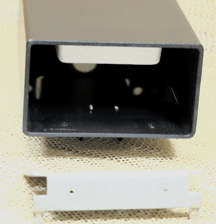

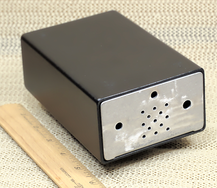

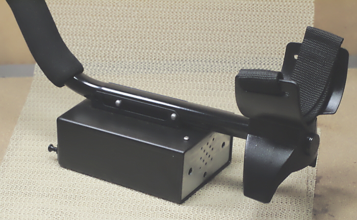

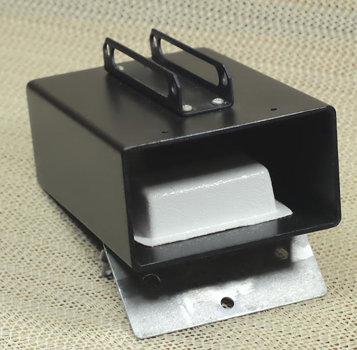

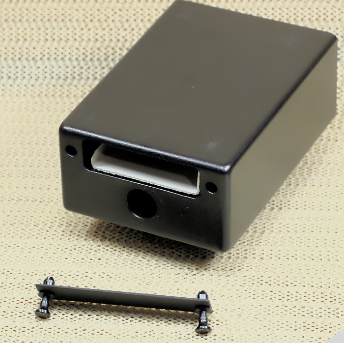

I have over 300 of the Gold Mountain control housing like on their Cobra and Thunderstick models NEW and pre-drilled I'll sell cheap. Have no use for them if you hear of anyone interested let me know. Keith 903-734-7773

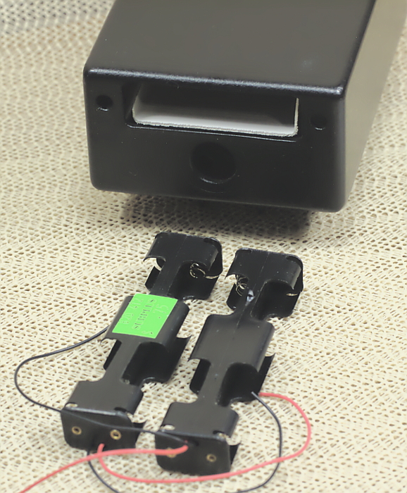

I just rec'd 2 control boxes from Keith Wills. They are a perfect fit for the Mirage.
It will hold two 4 AA cell battery packs to give you 12 volts. You may find a lithium ion rechargeable pack to fit as well.
The face plate may need some hole filling if you want to use 5 pots and switches and or use smaller pots.
Boxes weigh 7 oz.
Size 5 7/8" long, 4" wide, 2 1/4" high
