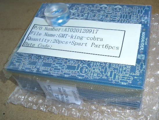

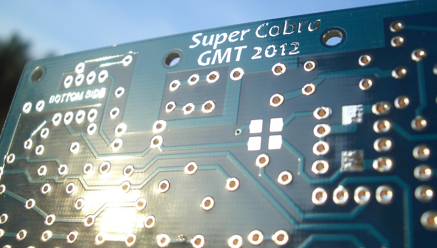

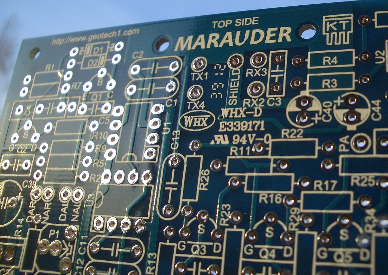

                  • New PCBs' bunch has been arrived. Anyone may order the TGS un-Light Advanced, ie TGSULA, board.
                    all the best
                      all the best
                      [ATTACH]21691[/ATTACH][ATTACH]21692[/ATTACH]
                      Hello kt315,
                      Looks beautiful, can you give us the price and show the complete picture.
                      kind regards

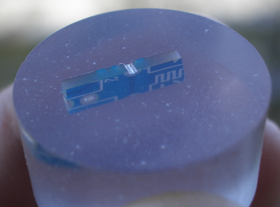

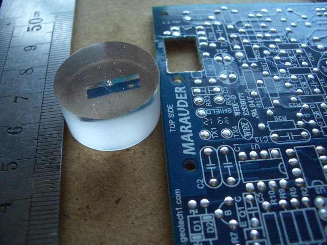

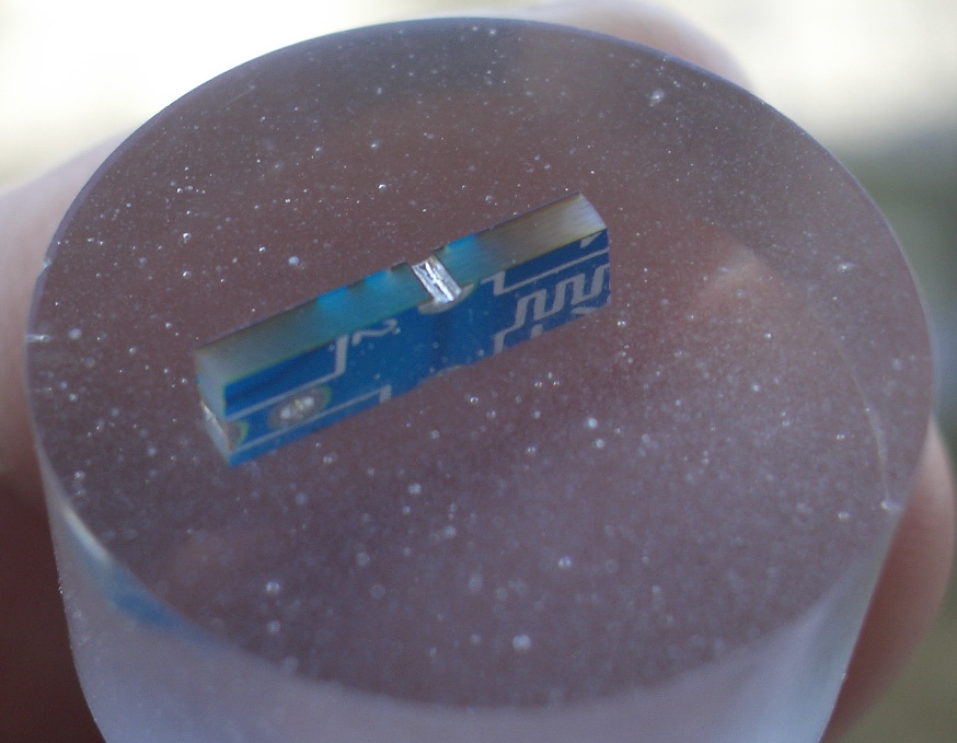

                      • I found this some kinda a sample in epoxy of soldered pad's sclice in the pocket. It gives a representative I bielieve of you can appreciate a quality.
ID:	333740Click image for larger version
ID:	333741Click image for larger version

                            Hello, Legaucho,
                            thank you for the feedback. ... awaited the sun on my side for good photo...
                            the complete pics in high resolution http://www.avral.ru/5cbd19f9e2073bb4b880ab967d81d5a1
                            have a nice day
