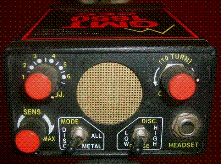

                          • Originally posted by growdude View Post
                            Hi Kt315 can you send me paypal info so i can order one please i also have many pics of mint original king cobra board bot sides if you would like case pics too
                            yes, Growdude, please deposit the pics to me if you may.
                            my e-mail address [email protected]
                            I also will appreciate all info on GMT 1650.
                            THANKING IN ADVANCE
