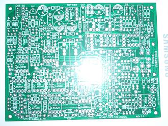

King Cobra PCB
    • Originally posted by Emiliano_070 View Post

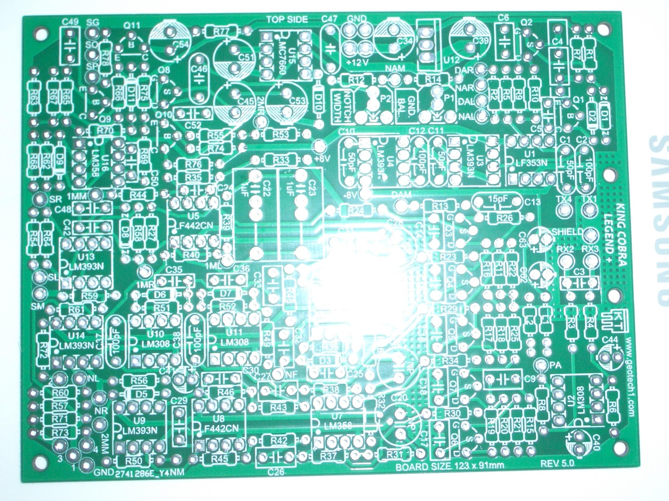

      PCB received, looks beautiful. Could you give list of components rev.5. . Thanks greetings.
      looks good... congrats you are in the Game now. you got wonderful Winter Project. get a fun! :clap
      BOM file
      follow rules
      1. do not solder tantalums at first. leave them on last stage, when you will get working state board.
      2. do not try test in NOTCH mode in your room conditions, you will get a noise a source of which you are not able to find. you must test this mode just in a field.
      3. you must tune a coil in ALL METALL mode. you must get ideal work at ground, then close the coil.
      4. coil is same like TGSL coil.
      L1 and L2 value 22-47+ uH, or, in case you will not find them, set resistors 22-47 Ohm.

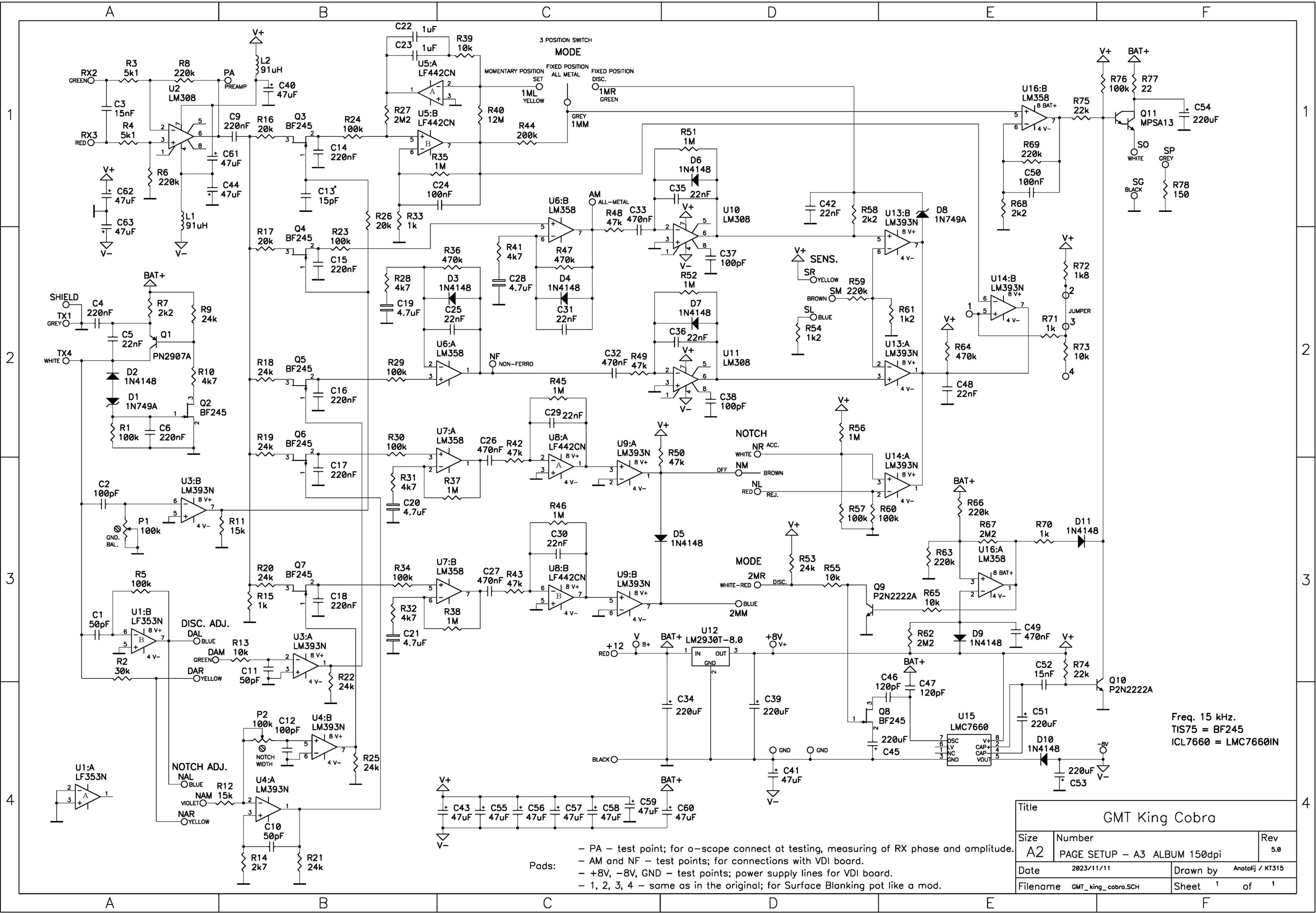

      • the schematic.:hat

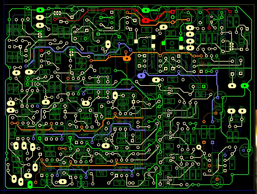

        • Good day . KT315, why didn't they make this board on smd components? Maybe the characteristics will not be the same, or not the same? I meant chips and resistors. It is clear about the capacitors, there should be a film in the right places. Sincerely.​
          • Can I replace DIP components with smd? For example, resistors 0805, and microcircuits in smd? Will it somehow affect the operation of the device?
            • Originally posted by praktik_1974 View Post
              yes, Bounty Hunter 4 Legend + is in my plan. but FT is active live company. i can violate a law.
                yes, yoy can do what you want.
                not. for example, Compadre is just a part of all king cobra schematic and working good.

                        • My project (copy) in DipTrace
                          The next will be a hybrid, DIP-SMD
