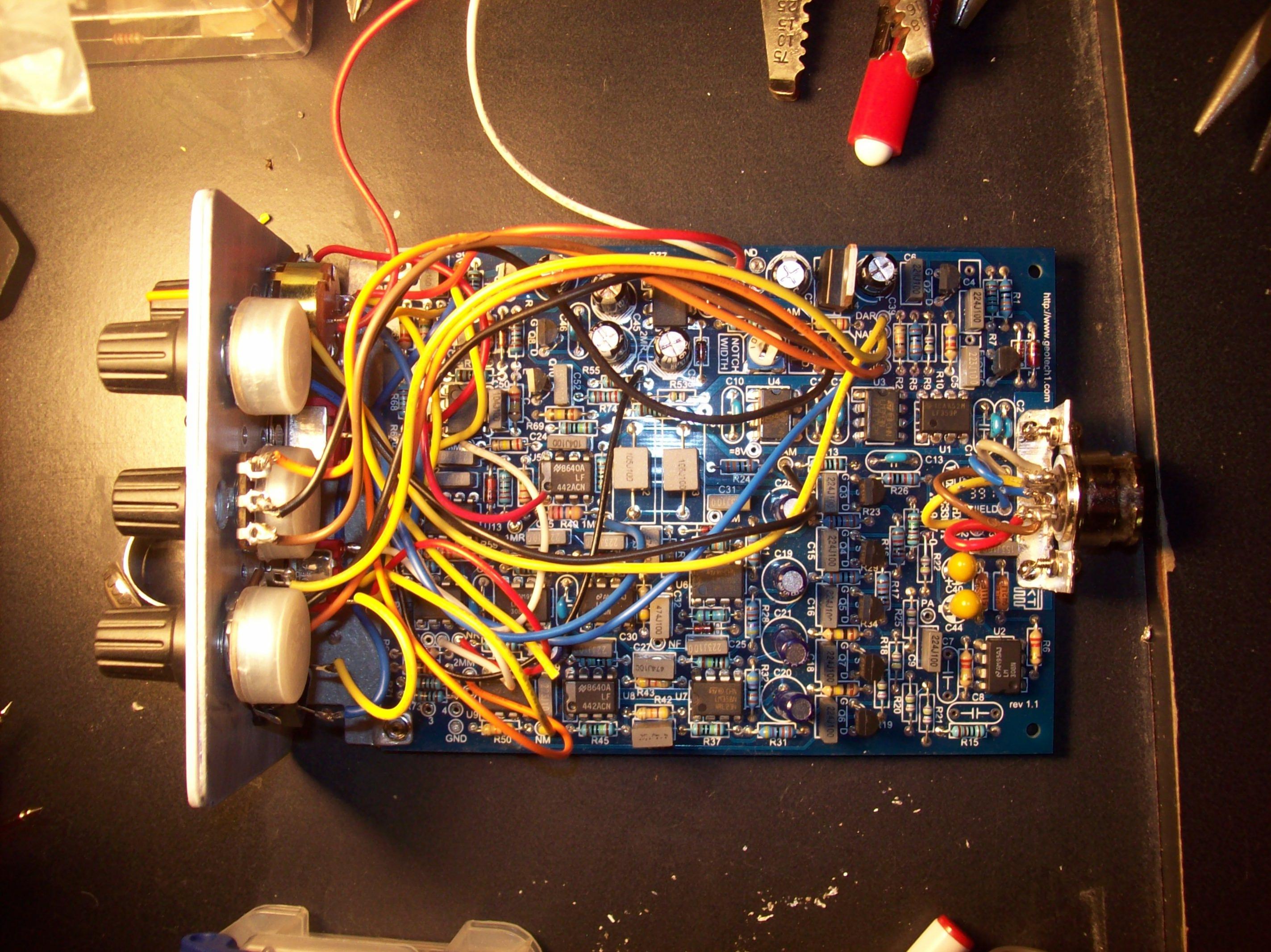

        • ok heres the almost done king cobra i still need some help with the function of it so tonight ill o-scope it and post pics its depth is very low so i think theres something im missing kt were should i measure from Click image for larger version

          • ok the 308 in the u 11 spot was bad so i changed it but the tx is still not functioning right i think the 7660 may have got too much current because the 7808 did for sure ill let you know after i change the 7660 and 2907
            • ok so the rx looks right on the o-scope but the tx looks flat on top of the wave also the discrimination and notch amp looks very wild could the 393 be whats wrong? only asking because it seems like its not gb-ing right i have to max it for mm and mL positions to detect and mid to min for mr to detect but it is detecting at 10in or more but still something cant be right
              • TX pic you may see in my #358 post. it is very clear enough sinusoidal signal. seems you have some limiting via feedback circuit that fixing the TX signal on some level. this is D2 D1 R1 C6 Q2 R10, accordingly its transmission. check them all. specially check Zener diode D2 and its polarity position at the board again.
                best regards
                • hey kt i found my mistake after i watched your video on youtube about the momentary switch i bought the reverse of the 2 the mode is momentary not the notch i feel very silly for not reading it correctly ordering the right ones now
