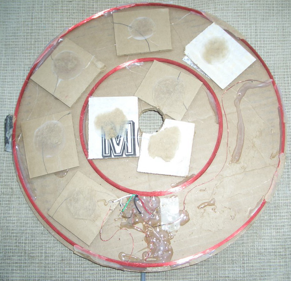

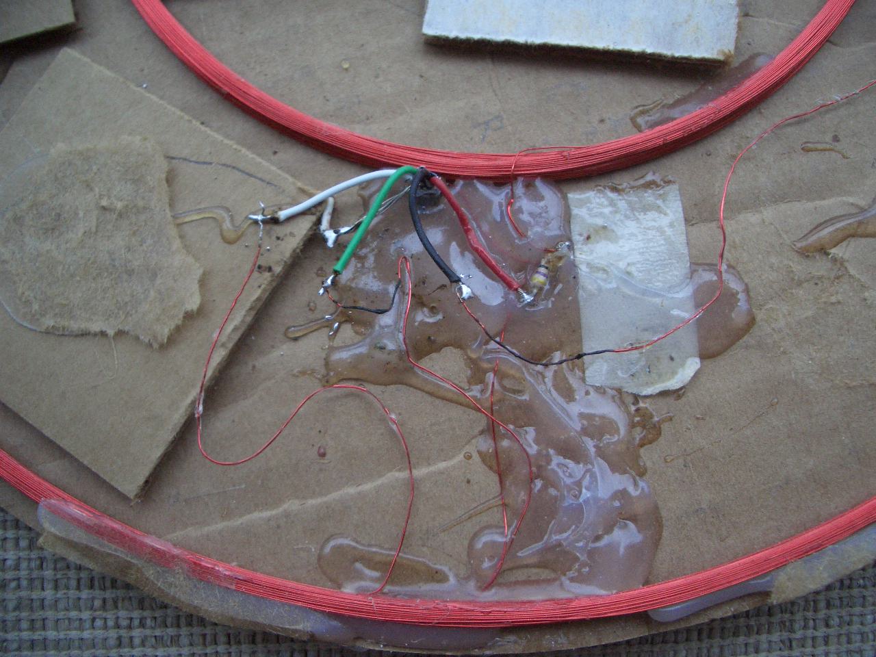

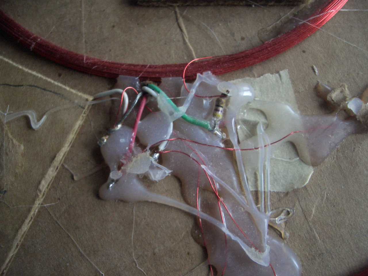

  • try move far the coil from o-scope and PC - hang up on window like me I did. try to exchange TX wires connection in the coil. I did such way and now it works more stabile.
    on photo Hot Head coil I opened - strange connection I did see and I remade this in more logical way, there one wire in cable was not used.

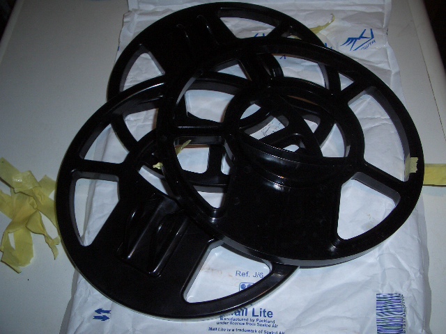

    • just now got nice 3pcs housing I bought from ukrainian seller.Click image for larger version

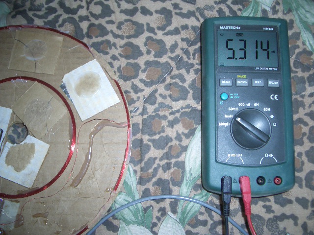

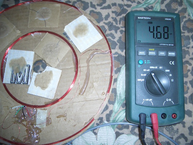

      • hello, how are the data for the coil?, and there is indeed a resistor in it.
        • ok i have an issue do you think the older tesoro coils have a different wire schem then the one previously posted i have 4 wires 3 used red green white and drain the red and drain i put on tx green white rx all im getting is constant tone in all met mode. all voltage is correct o-scope looks right im sure the coil is the problem. i tried reversing all connections but still nothing
          • can you measure resistances and inductivity of the coil? can you give pics of signals on TX winding and on preamp output? a trouble nobody did open old tesoro coils, no info besides some data Carl posted.

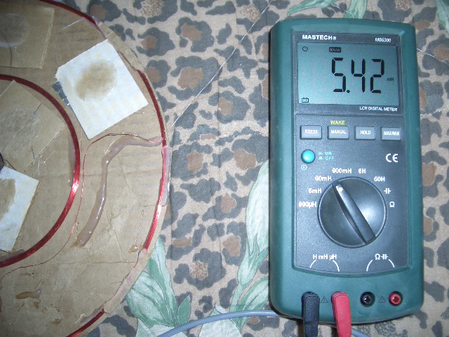

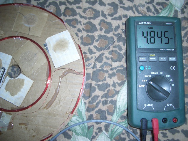

                  • arrg, no wonder it does not work properly with me I have 6.5 rx - tx 6
                    • 4th unused wire now connected. resistor in RX winding is 47 Ohm.
                      • hello, how is the total resistance of the two coils in each case? and how thick is the wire?
                        greetings

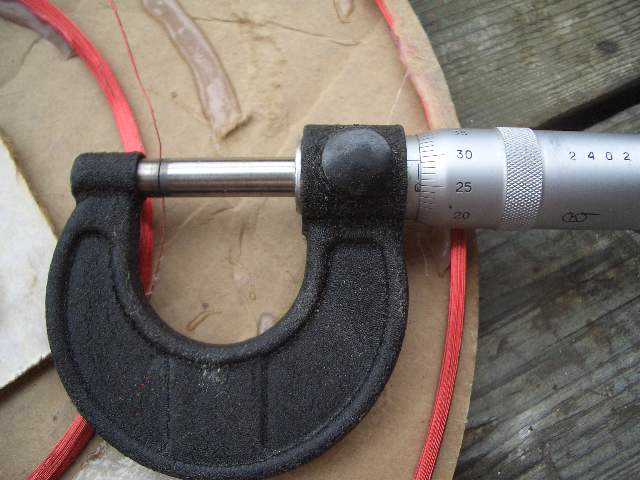

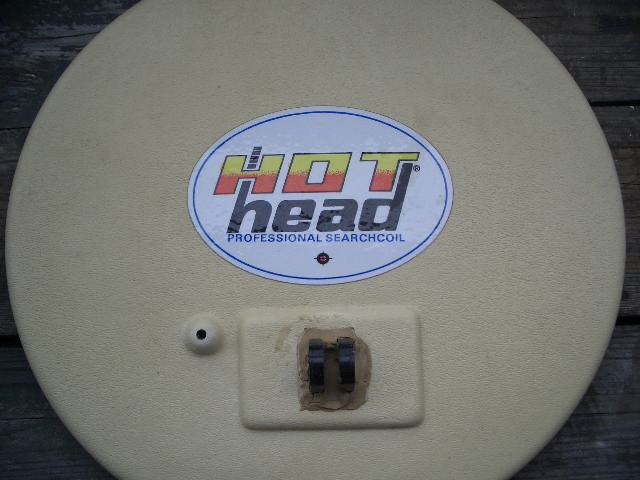

                        • I can tell about Hot Head I bought a detector with, it is 30,5 cm outer housing diameter, 28 cm is TX winding diameter. I have not original GMT coil. no data on original.
                          TX coil resistance is 25,2 Ohm, RX is 69,6 Ohm.
                          • the wire is same for TX and RX, 0,29 mm diameter. good luck.

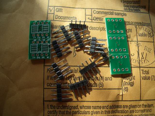

                              • DIP8 SO8 board
                                bought at ebay and just received those adapter boards http://www.ebay.com/itm/180952961067...84.m1497.l2649
                                now can use NE5534 in SO8 and opamps from trash electronics PCB's.
                                good luck
