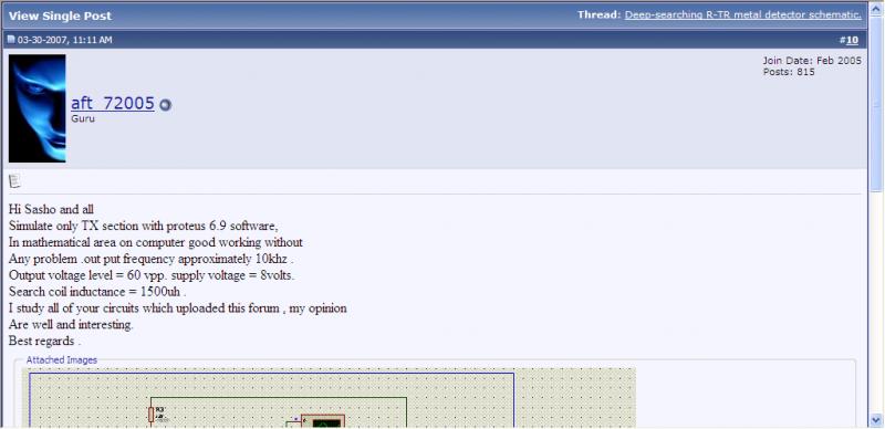

      Hi mesy 64
      Please see this link :
      http://www.geotech1.com/forums/showpost.php?p=52233&postcount=10
      simulated only oscillator section at the past .
      out put voltage was 60 vpp
      working frequency 10khz with 1500 uh coil .( depended to resonance circuit)
      but sascho said working frequency is 11 kHZ .
      also I test only oscillator section at practice . result seem as simulated .
      this oscillator can be drive serch coil for perfect electromagnetic field.
      Power enough for two box .
      Best regards.

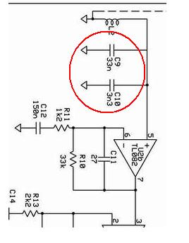

            Mesy
            You can increased power in TX with other configuration. But if the tune is bad, you'll no obtain good results. Try recalculating the both capacitor, here in paralell is 36.3 nF. Start trying with one 27 nF and go to 47 nF. There is a cap. with wich obtain more critical point in adjustment.

              At simulated ,coil was 1500 micro Henry or 1.5 milli Henry
              Coil specification respected to what's sascho said : 100 turns ,
              0.31 Cu wire , 27x 33 cm
                Mesy64, check oscillator by oscilloscope .
                11khz with approximately amplitude 60 volt pp
                  Hi esteban
                  tank you Like I mentioned capacitor replacement I can to achieve higher and more sensitivity can?

                        Mesy:
                        No the higher... the correct. So, try 27 to 47 nF. This mean you must solder and desolder, solder and desolder. You must to find the best.
