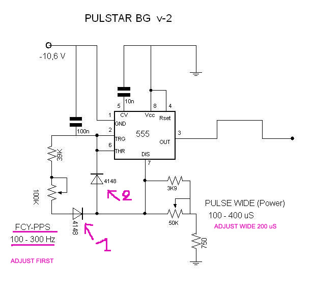

              hi all
              firstly i have changed oscillator 555 circuit to make 120-200hz frequency and pulse width 150-400 mikrosecond , i have successed like in the picture .now when i detect object only led ferrous become on without speaker sound and without microampere still zero.

              • #52
                Hi Jap. Thanks for the comments.
                May be as you say, another reason why the sign is reversed.
                This project worked well for me, with the addition of two inverters made ​​with TL062, one for the audio channel and one for the discrimination, but I think for the disc, it could reverse the LED and the milliammeter.
                Never finish the project, ie, only proved the desk.
                I had problems also with the incorrect adjustment of the preset frequency and pulse width at 555, if possible should check the correct operation with the oscilloscope.

                • #53
                  Hi aljacoub
                  there are 2 channels with different delay. ferrous - no ferrous
                  the setting of variable resistors RV5,RV6,RV,,,,,,,,,,,,,,,,

                  Hi Jose
                  for 555 do as aljacoub for adjustment of the preset frequency and pulse width .
