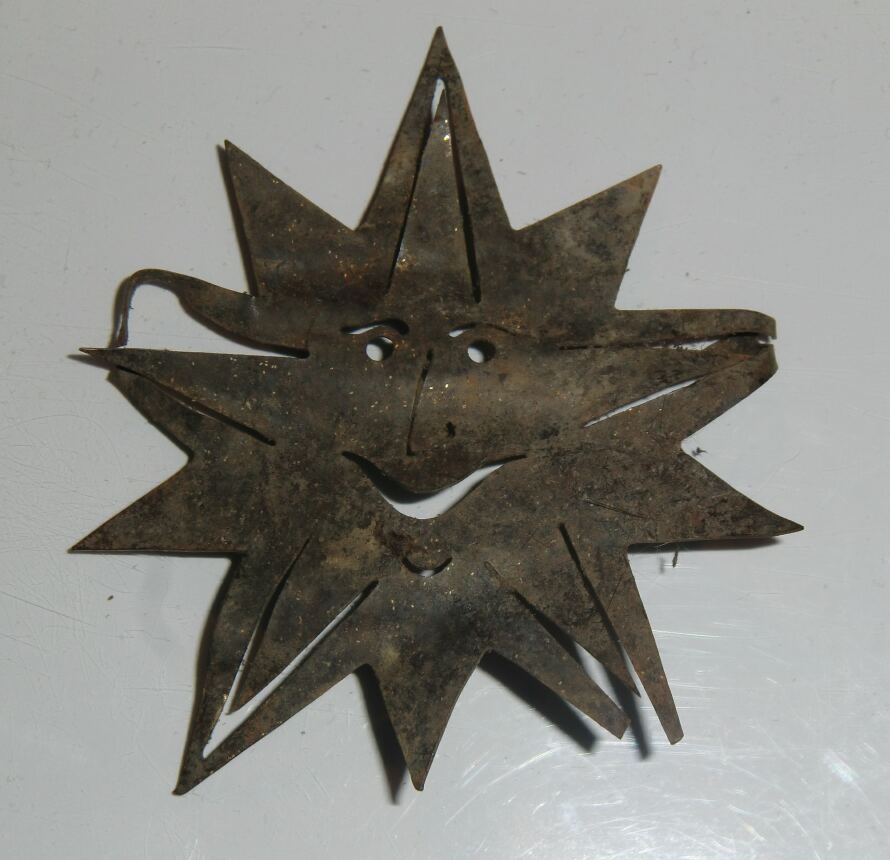

      btw. look what I've also found 2weeks ago in the middle of the woods: a smiling sun!

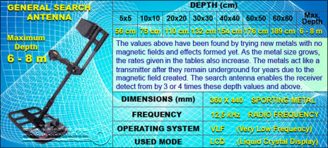

              The below values are for the medium coil and as you can see there is a 5x5cm object described at almost 2feet. If the ground is heavily mineralised and if the search coil is 10cm above the surface this can be reduced for 30-50%.
              In air tests show that you even can detect a 5mm coin at 6inch (15cm) but @ 100% and directly below the middle of the coil.
              So you can calculate how deep you may find rings or medium sized coins.
              The Jeohunter is for bigger and deep stuff but compared to other deep searchers it also can find coins. But you have to search more carefully for those. Otherwise you may buy the Minelab GPX 5000 - http://www.youtube.com/watch?v=ckPKAyX6c10 - it is concipated for micro goldnuggets upwards to coins - depending the coil you're using.
              It's perfect that you are a bodybuilder because having strong muscles makes it pretty easy searching with the medium sized coil especially on a wider radius (like I do) but there does not exist any detector that can find single coins at 6 feet.
              Check the list - those are in air tests I fully can confirm at around 90% sensitivity. If an object is buried for a longer time it can create a larger field (through ionic interaction with wet soil etc.) so you can get up to 20% more depth. But this only works if the ground doesn't weaken the penetration power of the coils radiation! Otherwise you may get the same depth like in air or less.
              But: I don't know every secret about the Jeohunters search antenna and if they write that under special conditions it is able to detect 3-4 times of the given depths it may really possible! Haven't tested it yet and perhaps it's complicated rebuilding such test-conditions.
              The medium antenna finds a 35x50cm alu-case in air at exactly 200cm (over 6 feet) where there is written below a much larger 60x60cm object at 190cm! So you really can rely on those values and if they tell the search antenna will find under special condition 3-4times of that depth why it should be not true? But if I have the time I will ask the Marko Group what special conditions those are and if it's possible to test or proof it.

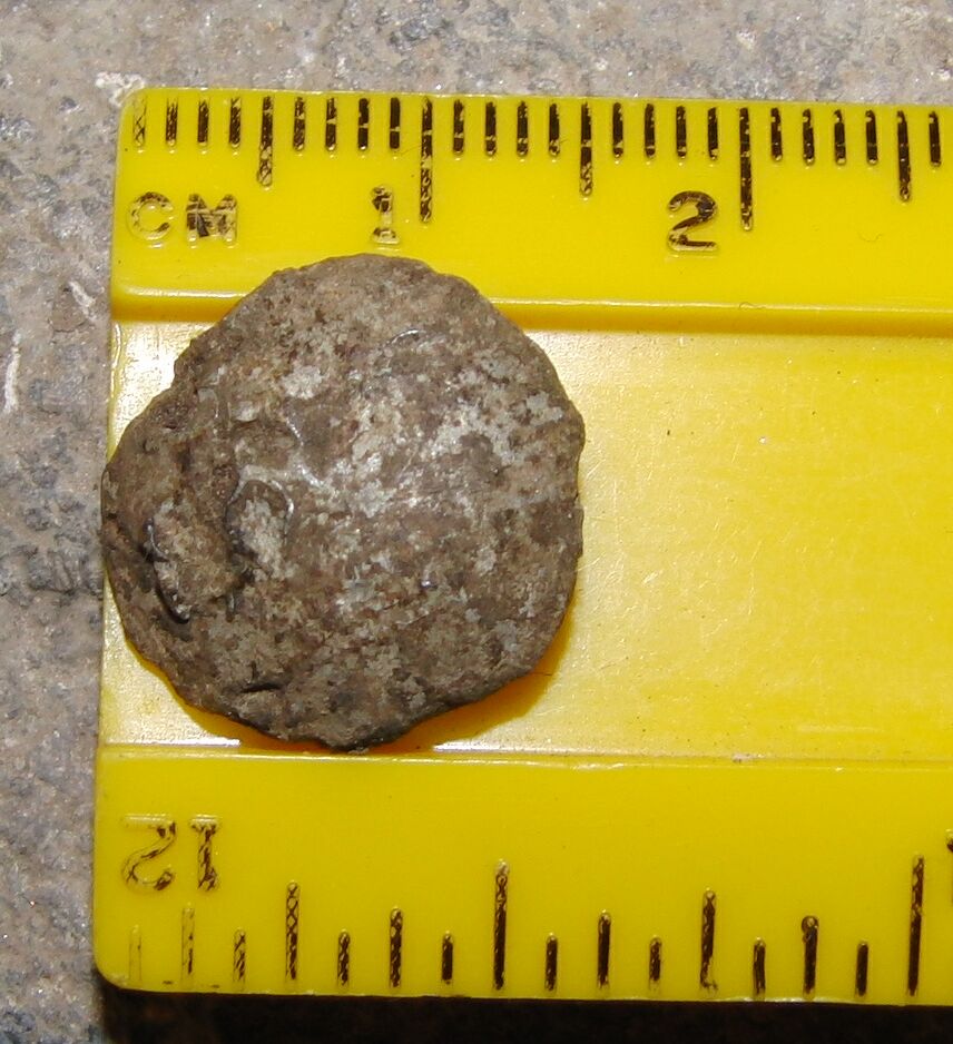

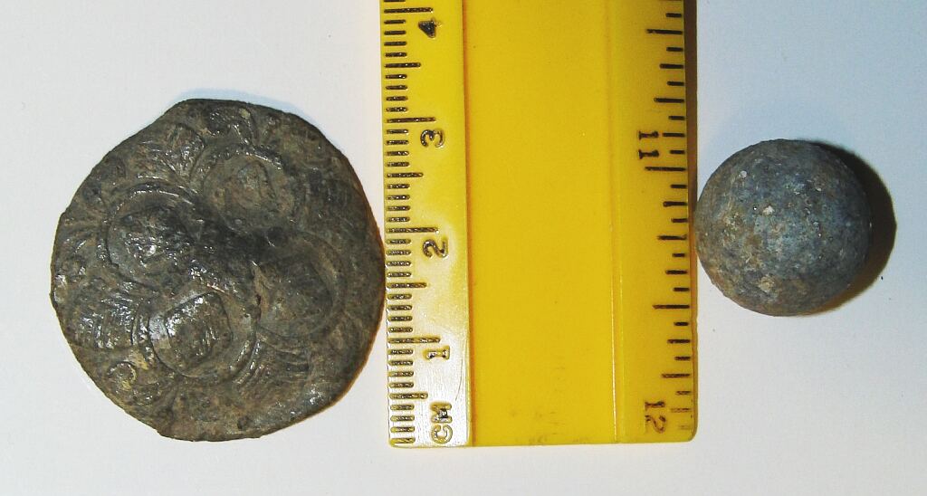

                        Below you can see 2 small objects I found in the middle of the woods this may with my Jeohunter, ca. 10-15cm below the coil (coil to ground plus ground to object distance)
                        At 80% sensitivity. Very old button and 200 y.o. muscet ball. This is like finding a needle in a haystack!

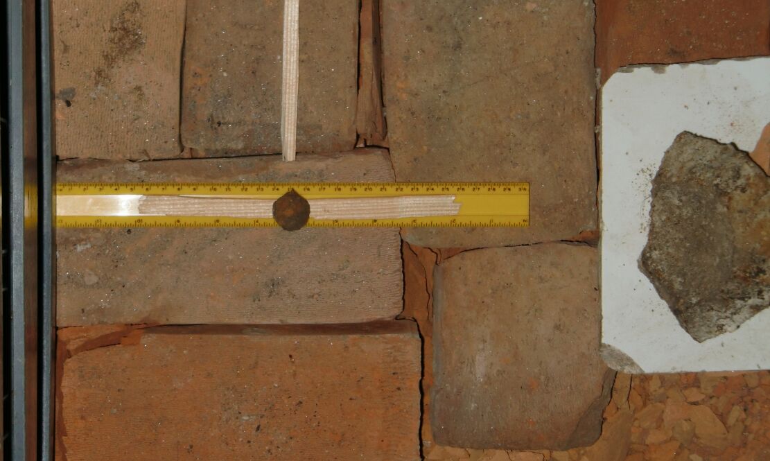

                            Also attached a pic of yesterdays treasure-hunt (dig until 10pm) -
                            that shows the real distance from Jeohunter medium size coil -
                            (iron ball 2,5cm @ 15cm & bomb-shard 10cm/4cm @ 40cm)
