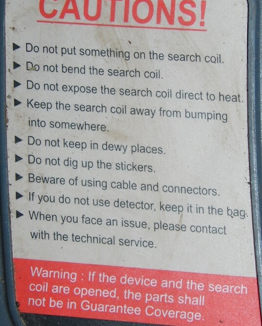

      Haven't asked yet but I put already the standard search coil 10cm deep under water while searchin' in a little lead-mines "river"! And so far I had absolutly no problem with this.
      There also isn't any warning written on the coils label that you should not put it into water.

            The label says "Do not keep in dewy places", which means "Do not get it wet". If the list is not coil-specific, then this might refer to the control box.

              Thanx for the correct translation, Quiaozhi.
              In fact dewy, wet or even under water is the same and:
              "Water has a very little head."
              So it depends how much water penetrates or drys up.
              I've got now the exact info:
              ________________________________________________
              It's risky and please not hold it under the water, but search
              over the water-surface is good, making ground balance first.
              It's "Better safety first", depending alot how good the isolation is and if there could be something affected by penetrating water. Some coils use capacitors inside of them and other electronical parts or contacts could corrode by humidity.

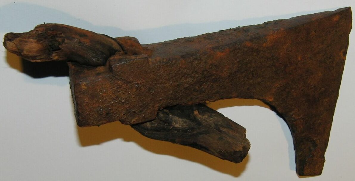

                    Found 2cm small case shot and 3cm grapeshot iron balls until 15cm-20cm deep in the wood but with 10cm high grass there @ 80% sensitivity! And a few days earlier I got 2000 yo roman axe!
                    All these finds are another proof how versatile the Jeohunter is, because you can cover a really huge area and still find little things!

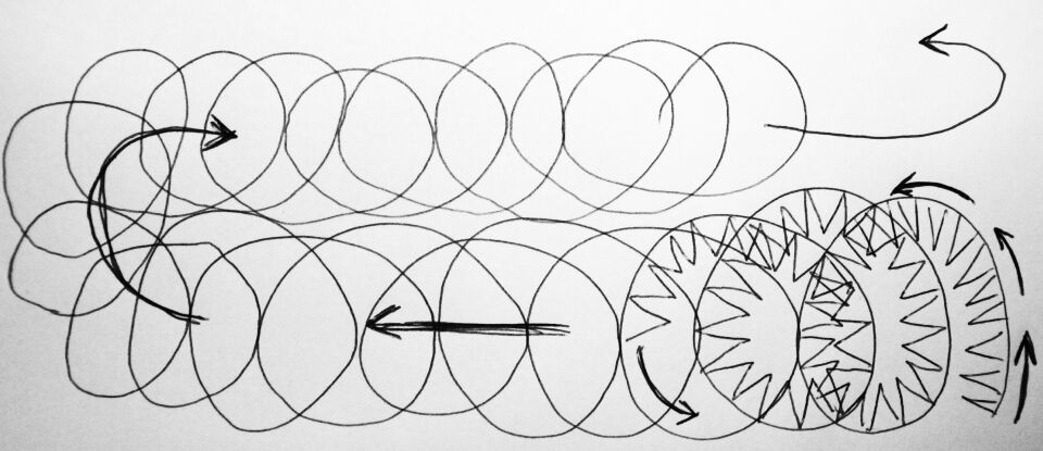

                    You can search even faster with the whirl-wind method over flat sites - see below - while the weight of the coil is gone completly!

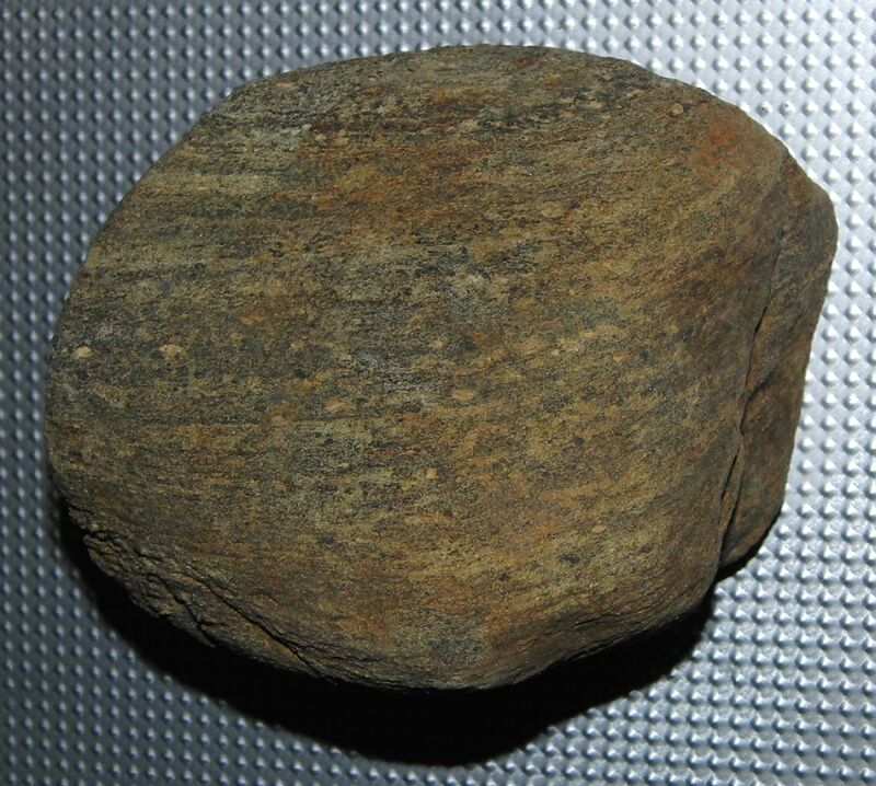

                              If you put the GB to -200, hot rocks, mineralic stones and even bricks will get recognised as "metal".
                              The "not detection value" of bricks / hot bricks is around -90.
                              And that same value for mineralic stones is around -150.
