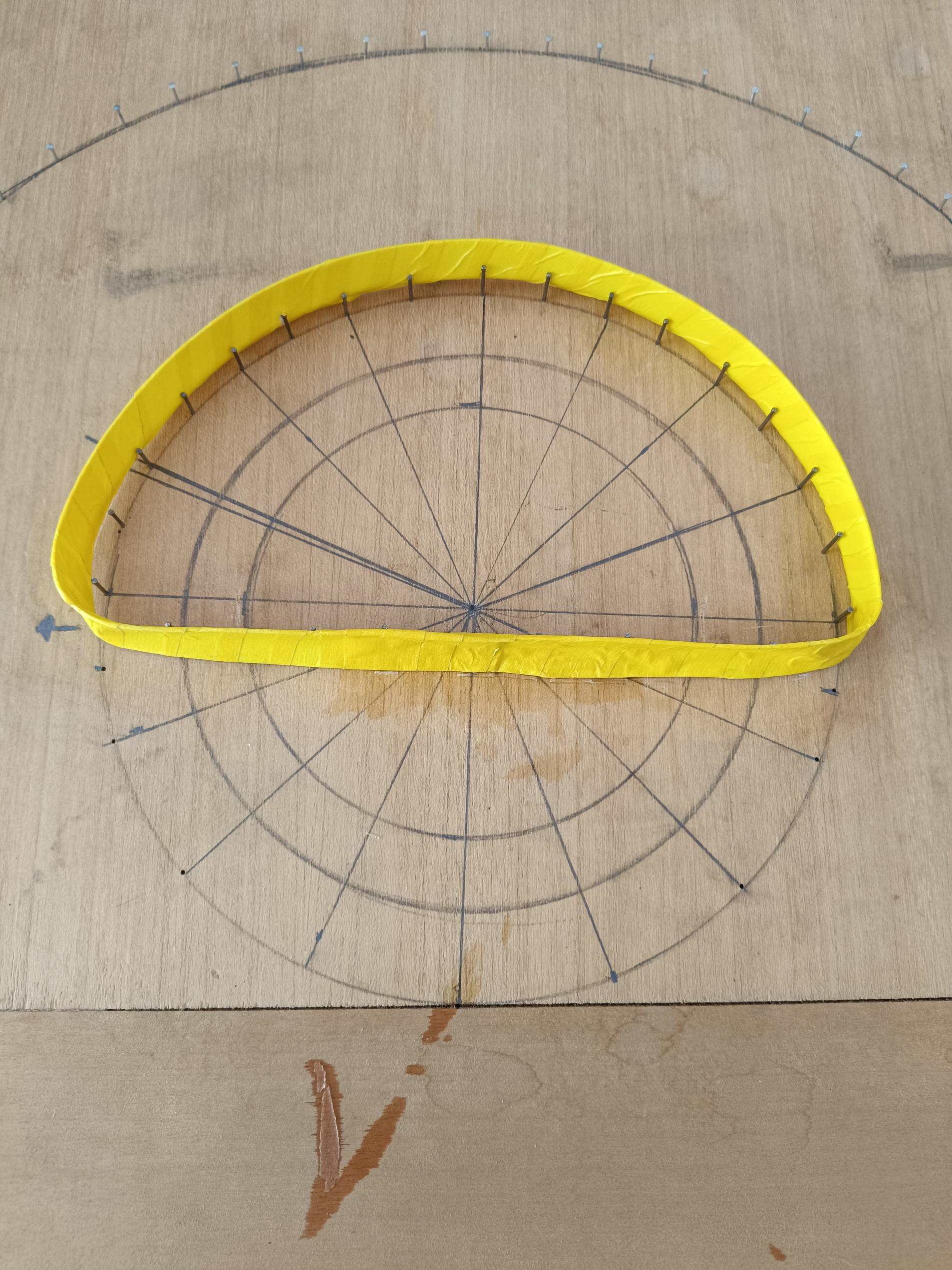

                          HELLO EVERYBODY!
                          COULD SOMEBODY TO TELL ME ABOUT THE COIL OF ARADO 120 (HOW TO MAKE IT) AND HOW I WILL ''NULL'' IT!
                          THANKS

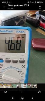

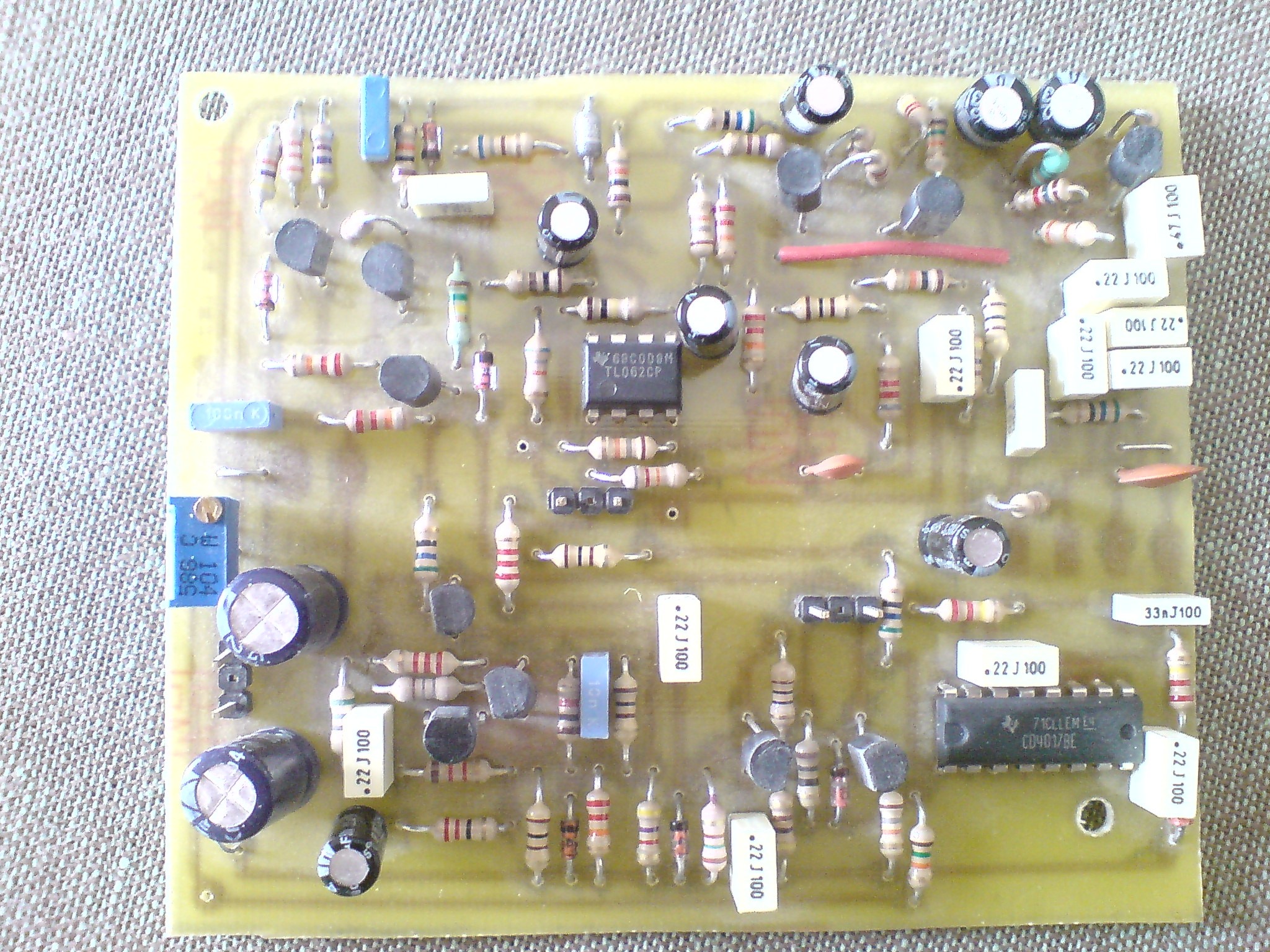

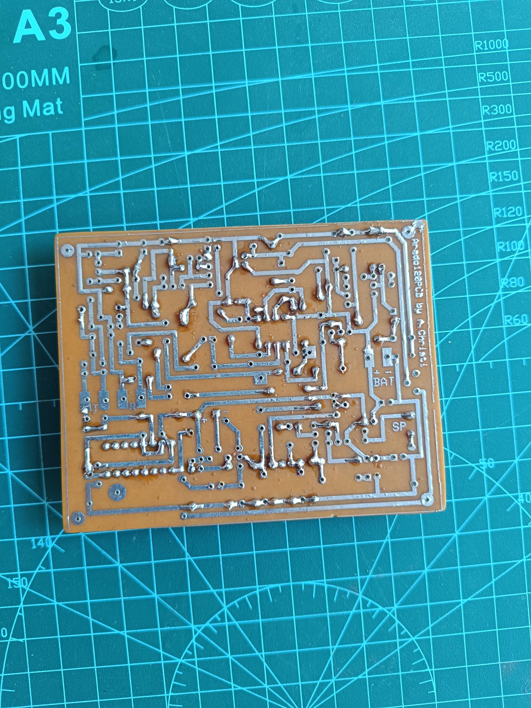

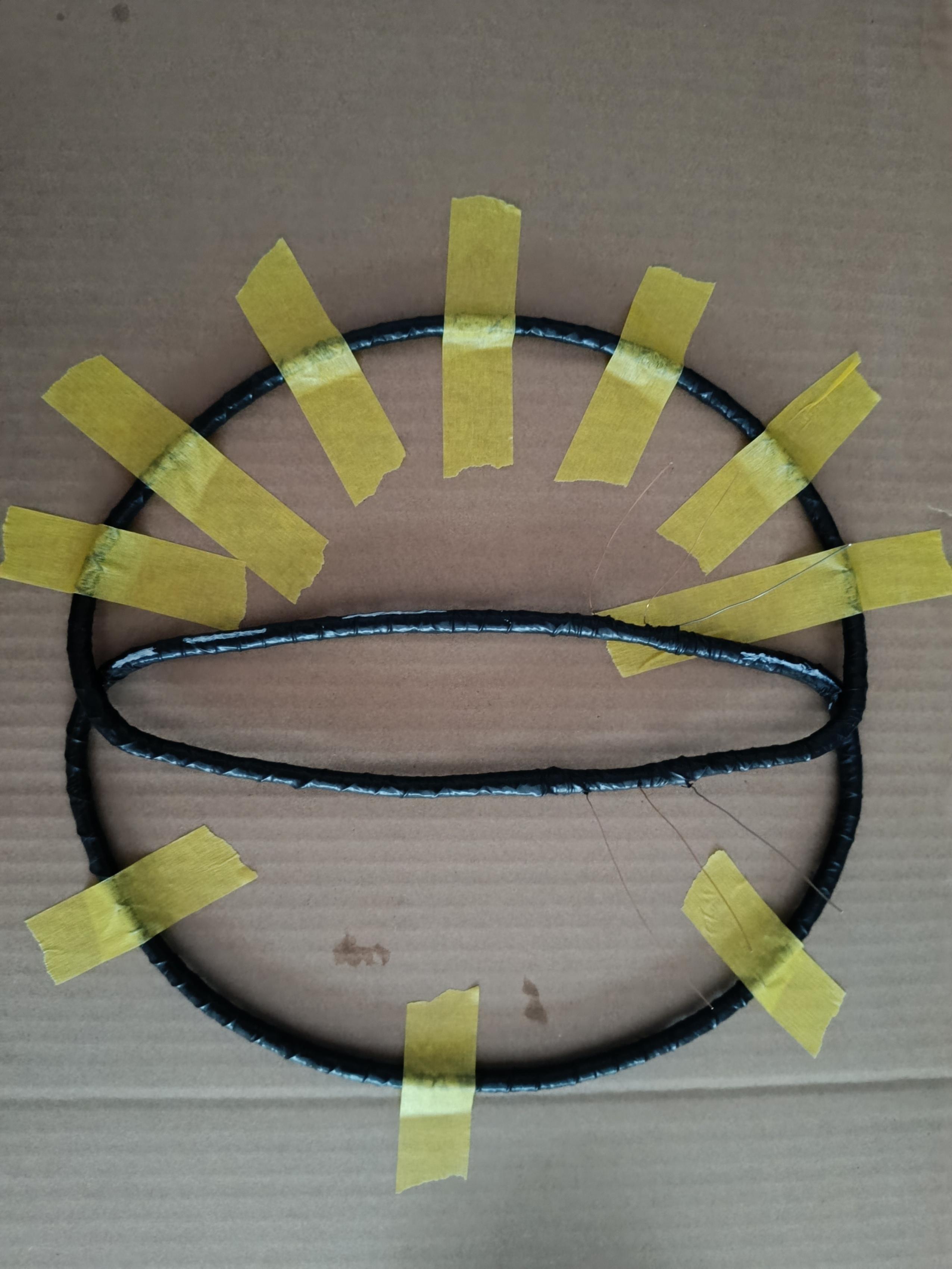

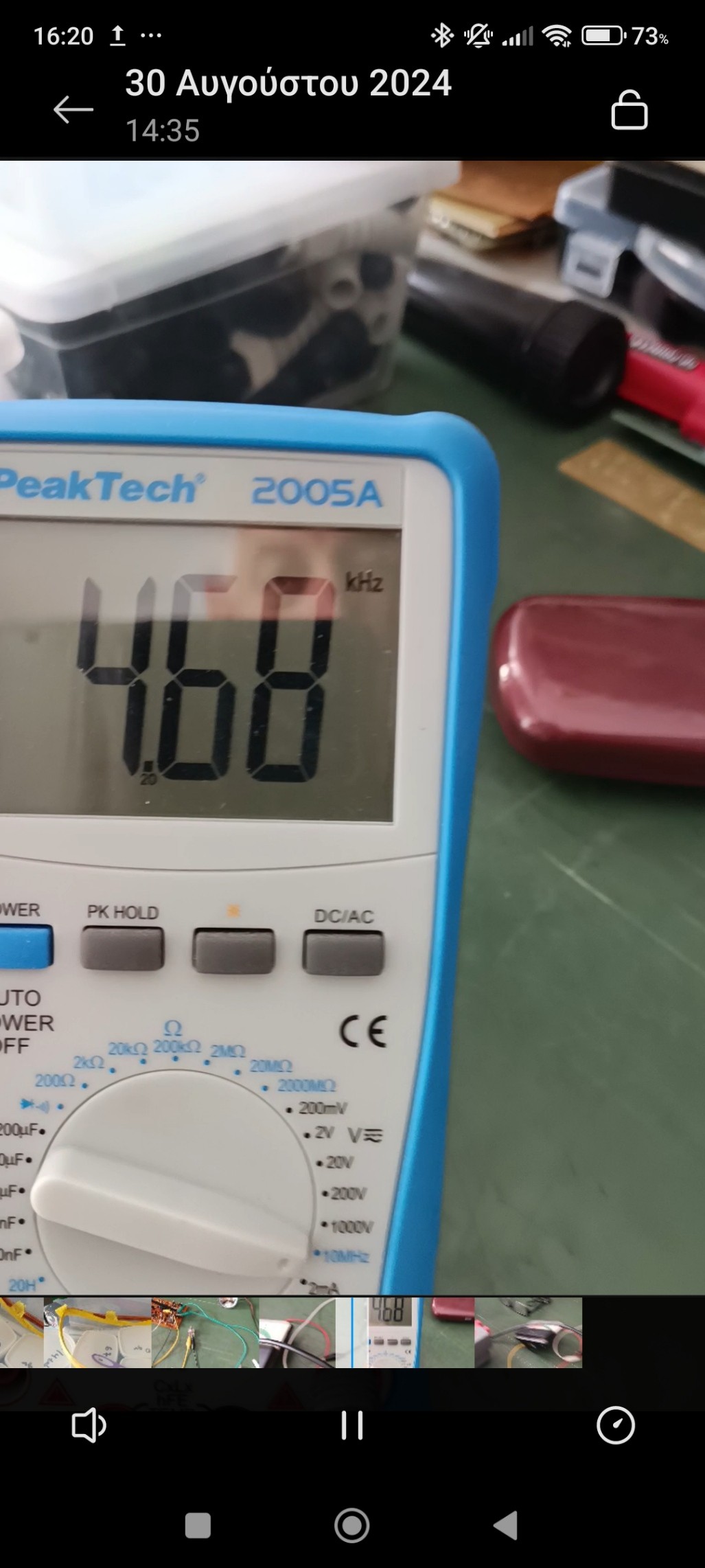

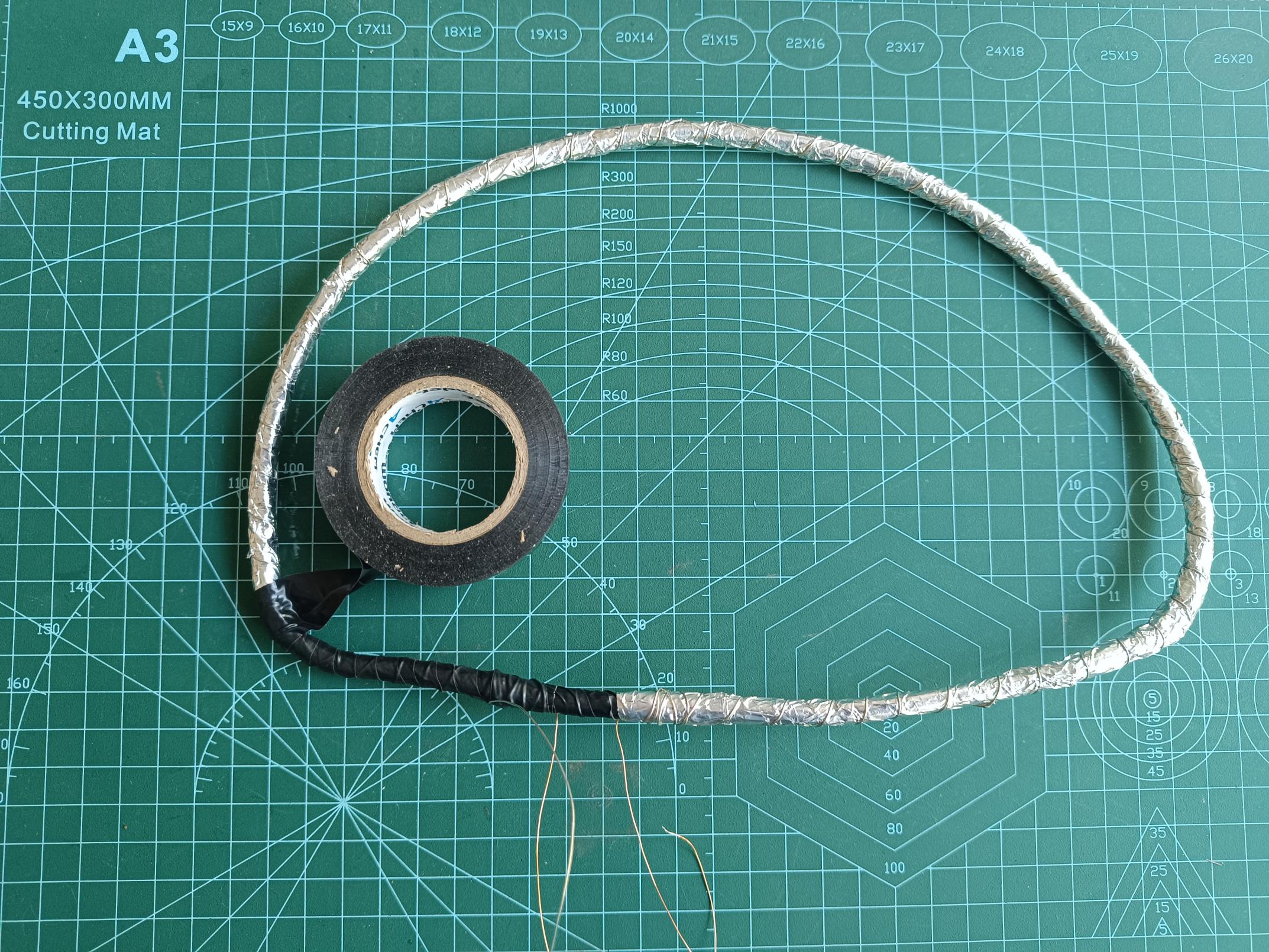

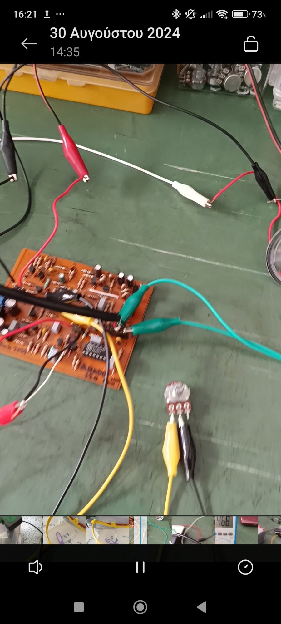

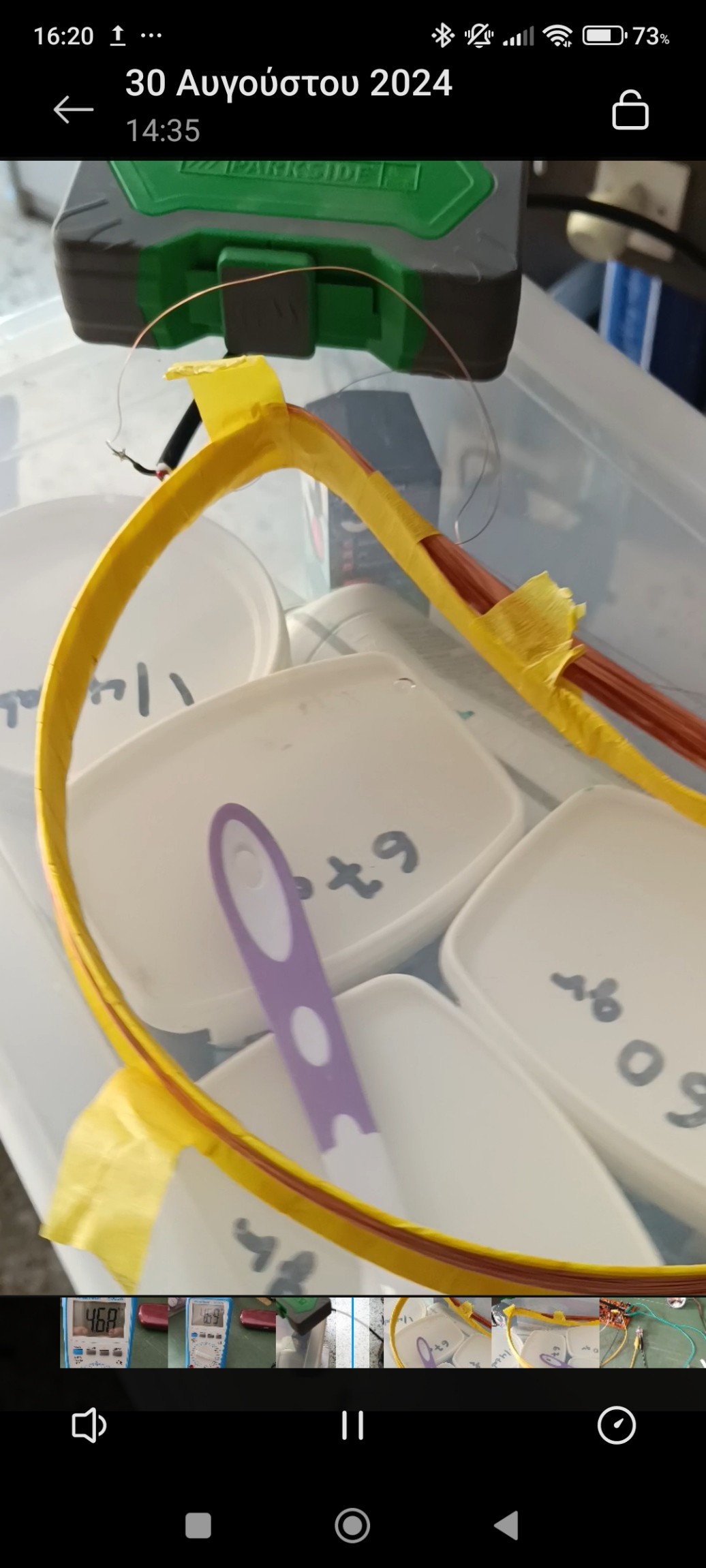

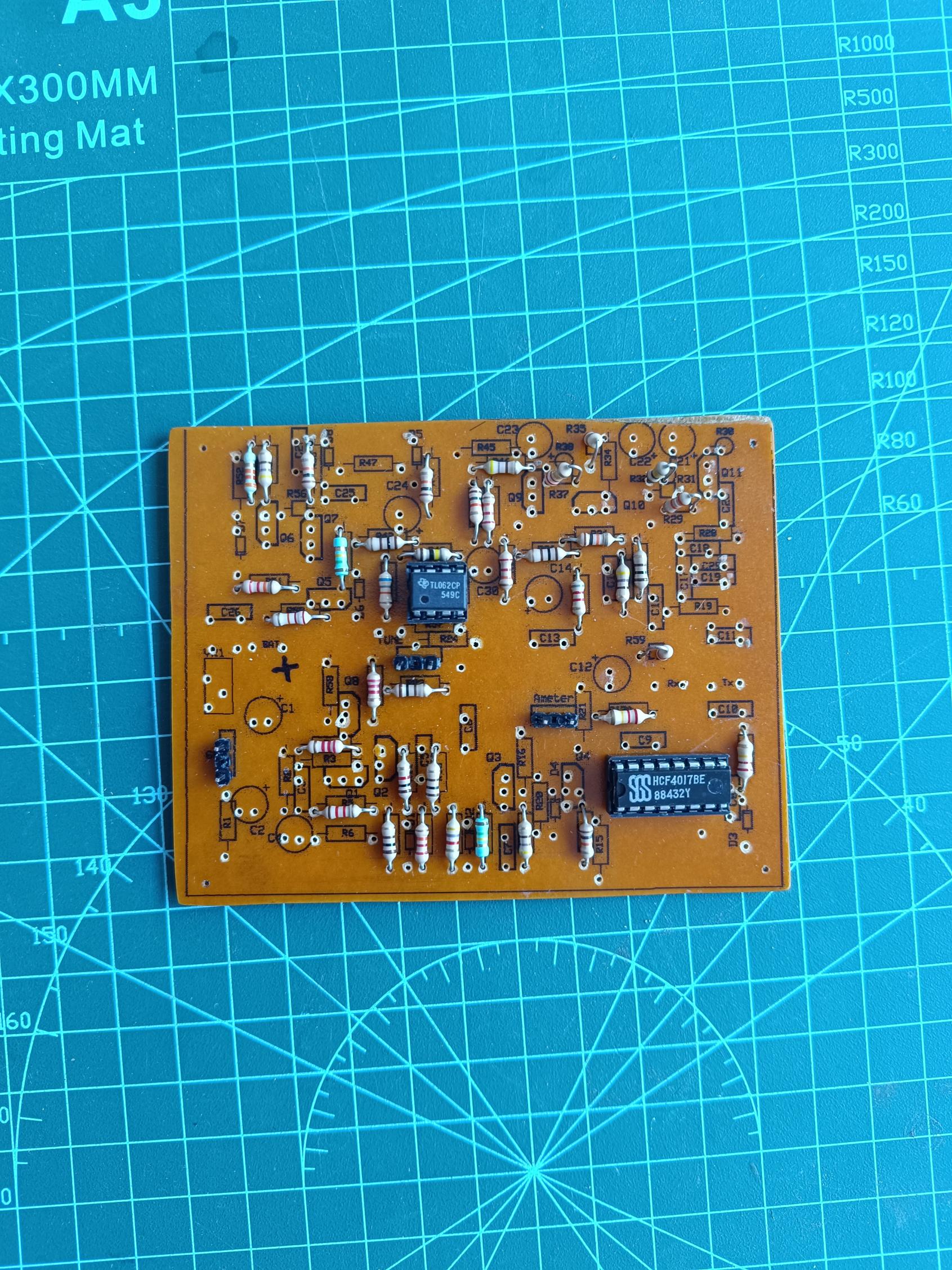

ID:	428062 have made the Arado 120 as the schematic of Andreas....the circuit worked, but has low volume and low sensitivity (depth). Could someone to tell me if the shielded coils Tx and Rx, is possible to prevent the sensitivity of this machine. The pcb is the original from Andreas. I have maked this exactly the same.
